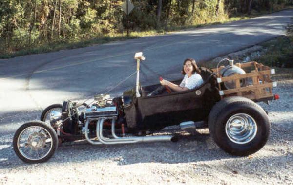

Hey, I have a 23T too! Just the Ford kind....

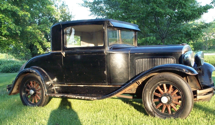

Frank - Your 23T looks a lot different then mine and in a lot better shape. Looks Great! I see we have similar interests. Here is my '29P (Plymouth) It is all original and in the middle of install of engine overhaul, upholstery and paint. Spring is going to be very busy.

Wow Rich, slick! I once had a '33 Business Coupe. I have a '74 Dart, 4dr, /6 that will be the next project once the boat is done.
I love old vehicles of any kind, hot rods, restored, original, whatever. I'm president this year of the Capital District Cruisers ( www.capitaldistrictcruisers.com/ ) here near Albany NY. We put on BIG (800+ vehicles) cruise-ins 2nd Mondays in June, July, August and September at one of the biggest rollarenas in the country (Guptils in Latham).
That old Plymouth of yours is gonna be one sharp looking grocery getter!
