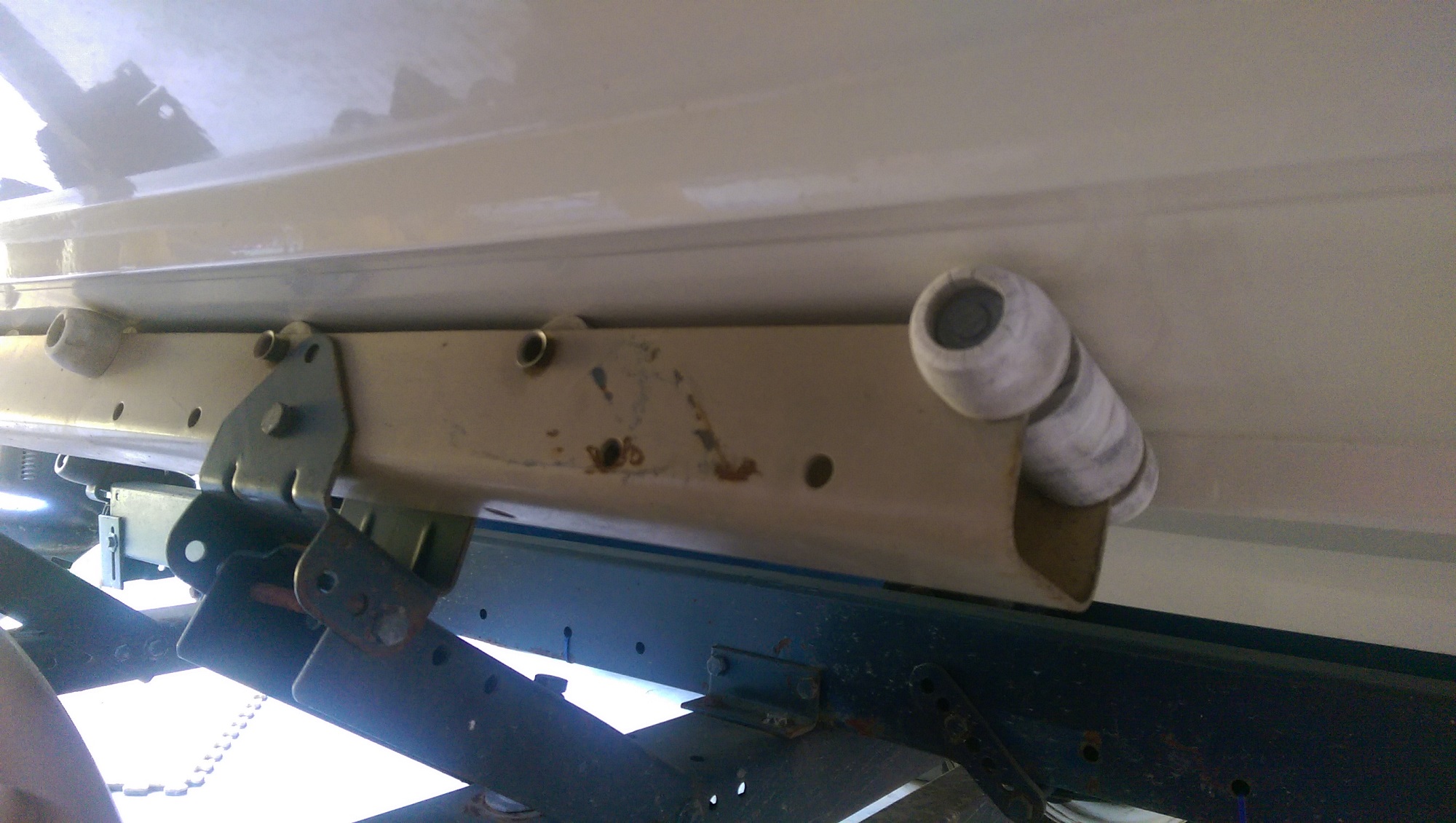

While the boat is in the water for the week we are on vacation I thought i'd replace some rollers. I've done some of the keel rollers already. But the bunk rollers are hard as rock and some are missing the end caps.
But, it looks like it'd be a major pita to get them off. Looks like they are pressed on and would need cut off. Not something I want to do while on vacation.
If that is the only way to do it, i'll wait until we get home. Have a look and let me know what the easiest way to do it would be. I can't seem to find these exact rollers either.

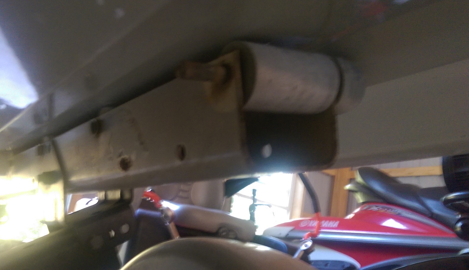

The rollers are about 3" wide and 1.5 across. Couldn't i buy one of these:
www.easternmarine.com/2-x-9-yates-boat-trailer-straight-roller-9202-4
and make 3 rollers? Now they are .5 inch thicker but that's only .25 inch difference on height and the bunks are adjustable.
Look at these current shafts. I pretty much have to grind or cut off one end to replace the roller, right?

Mine are "press flared" on both ends, so yes you would have to grind or cut the ends off to remove. New roller shafts and "pal nuts" would be the ticket with your new roller idea IMHO. I believe it would work out that way Dan.
Re:Holsclaw roller bunks 11 years 2 months ago #114240
Try Stoltz rollers www.stoltzind.com/ they make a bunch of odd sizes. I cut down a couple of RP-12s to make 3 piece rollers like you have. I used SS rod with press on caps for mine. Some of the sizes are not carried by his vendors, just call Carl Stoltz in Ft Lauderdale to order what you need.
