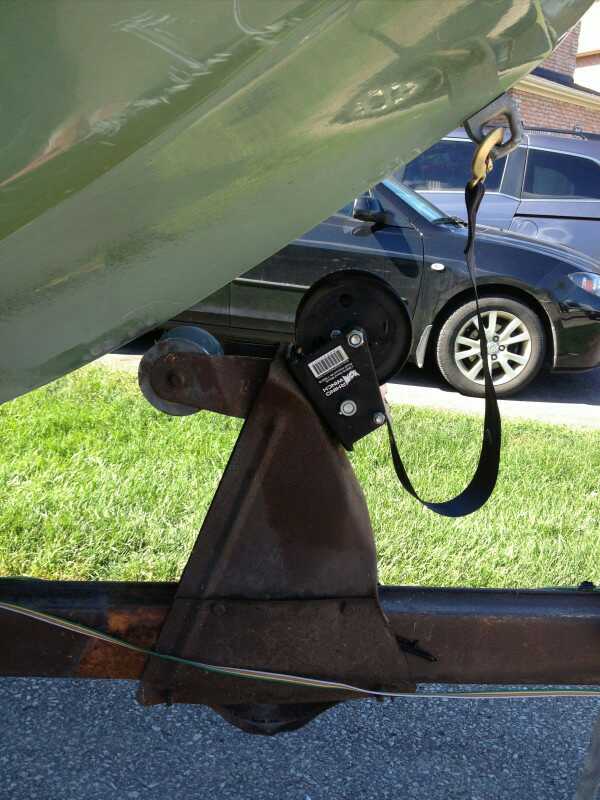

Came across this old bulletin from Tee Nee that suggests the winch stand be through bolted. Of all the Tee Nees I've seen, I don't recall ever seeing this. However several of them I've owned have shown signs of the winch stand moving. Also have talked to a few guys that have had it move in transit. So here's what I did. Through bolted with a 5/16" SS bolt. Not really aesthetically pleasing, but better than the alternative. Also put a safety chain from the frame to the bow eye ( cause I just don't trust the winch).

Better safe than sorry, looks like a good fix Bill.
