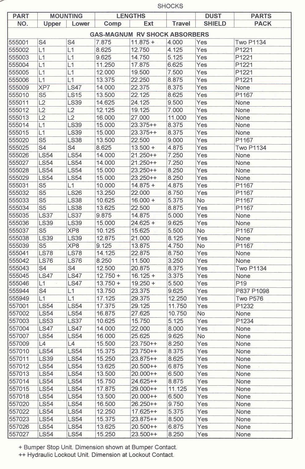

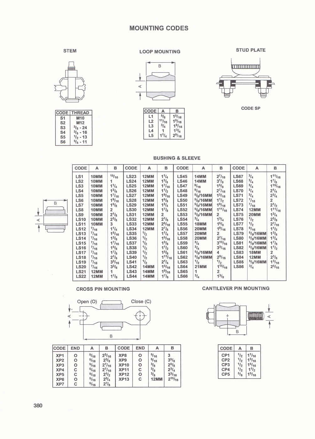

This chart was used when I rebuilt a Hale & Hardy trailer, pick the mounting style from page two, then the lengths, these are Monroe shocks.
