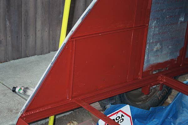

Mark, I used an Eastwood rust encapsulator some 15 years ago on a camper project. Iron frame and aluminum skin. It worked well. As I recall you had to beware of the fumes, and it looked like the old "red lead". Seems like anything Eastwood sells is top notch.
