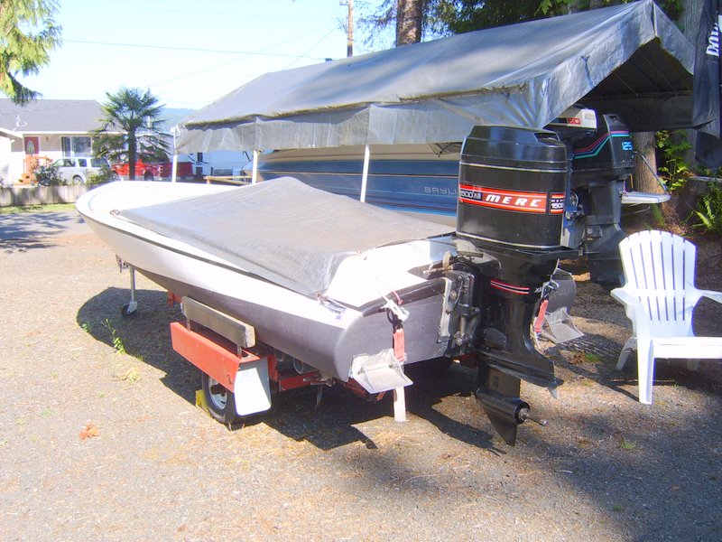

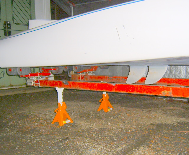

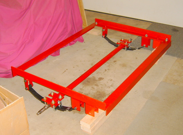

As a Machinist/welder/fabber..trailers are easy fun projects. I got a salt rusted out trailer here for free. Mostly solid, except the undercarriage/Truck. Then bought a 15 foot Flatbotton of the great "Doc FrankenMerc" Well, redid the trailer, did the boat..(bare hull, but solid), while Thom built me a crank up fresh Merc. So the original free trailer? Ended up $3500 bucks fun! Some pix
