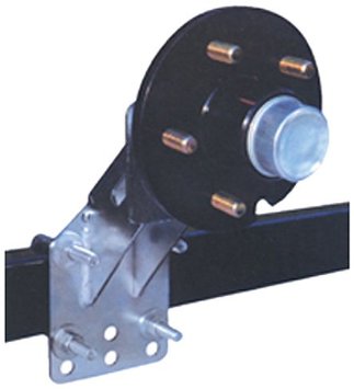

My brother rigged a stub axle mount (like a spare) to his trailer so he can have a spare hub at the ready when needed without having it bouncing around in his truck! Pretty cool idea, just thought I'd pass it along.

That spindle idea reminds me of the one spare tire mount I saw. It was about $70
