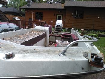

Been looking into starting my first boat project for a while now. Finally found the right boat for the right price. She's a 1980 Forester 15' with a 1950's (I think) Evinrude 40. Picked up for $350. She runs and floats.
It had been sitting behind the guys house, uncovered, for 3 years. Brought it home and starting tearing all the rotten stuff out. Next step will be to get that old motor running.
Re:My first project (1980 Forester 15') 11 years 5 months ago #110648
The interior before I cleaned it out.
Re:My first project (1980 Forester 15') 11 years 5 months ago #110650
After taking a few different sized brushes and some bleach to the top and a pressure washer to the bottom.
