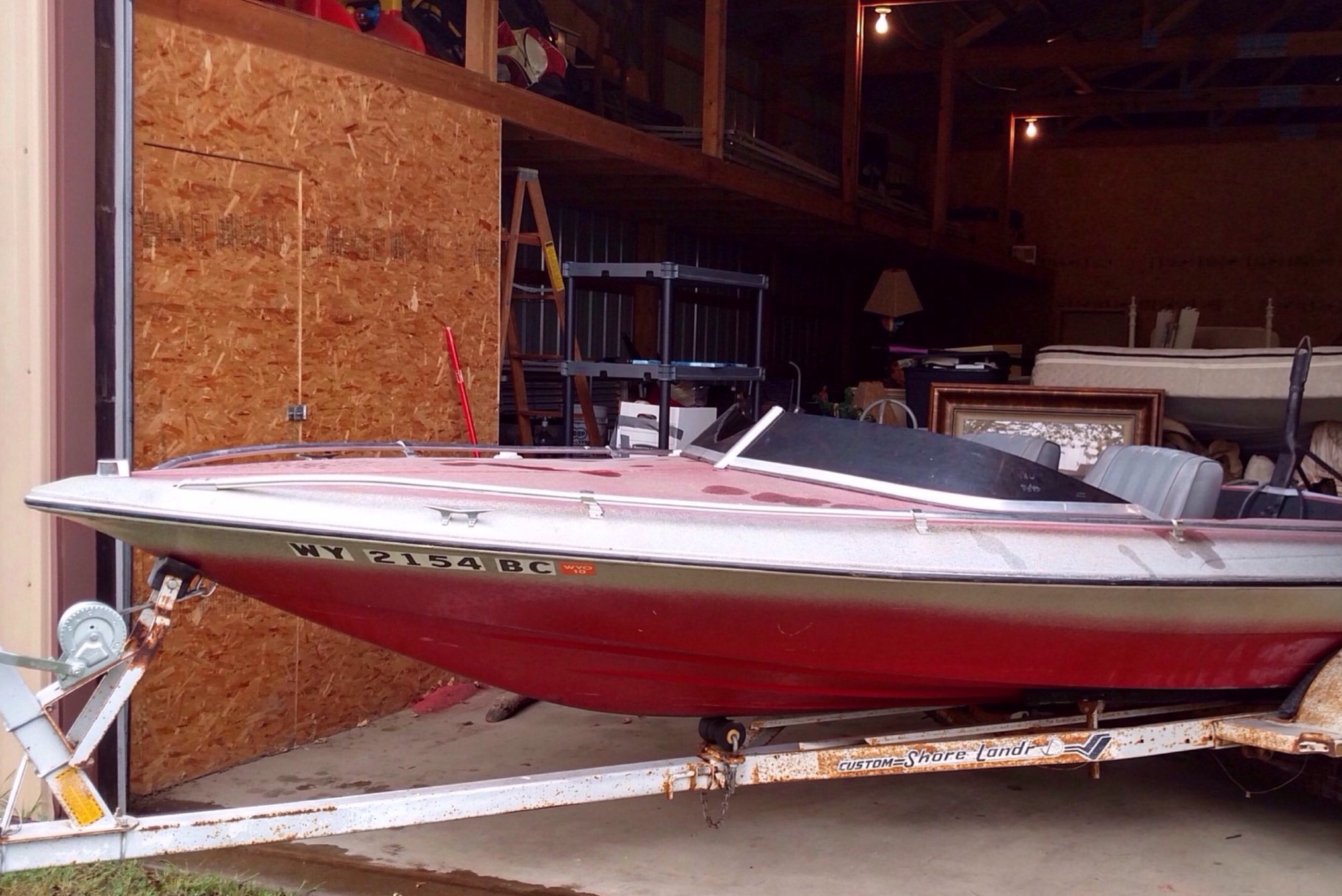

This is my "new" Baja. It needs a lot of work and I'm looking forward to the challenge. I purchased the boat and trailer for $500.00....I'm hoping that was a good deal.
I'm new to boat restoration and am all ears to what to look for.
Thanks everyone!

Re:My 1980 Baja 16 SS 11 years 5 months ago #110049
What engine is it running? As long as it runs, it's def with 500.

Unfortunately the purchase did not include an outboard

I believe they were rated for 120hp, check the capacity plate to confirm. What to look for? Start with the transom. Check for spider cracks in the corners and where the motor was. Drill a few small holes thru the fiberglass to check for rotted wood. Then check the floor for soft spots. If all checks OK, you got a steal! A bit of advice when shopping for power- get as close as possible to the max hp rating. You will be happier in the long run and down the road resale will be better.

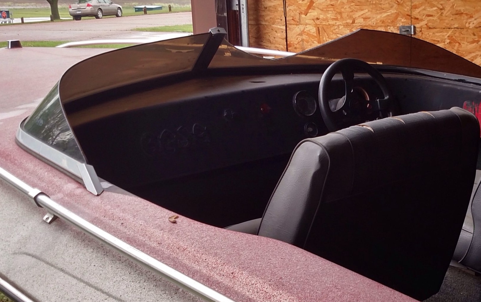

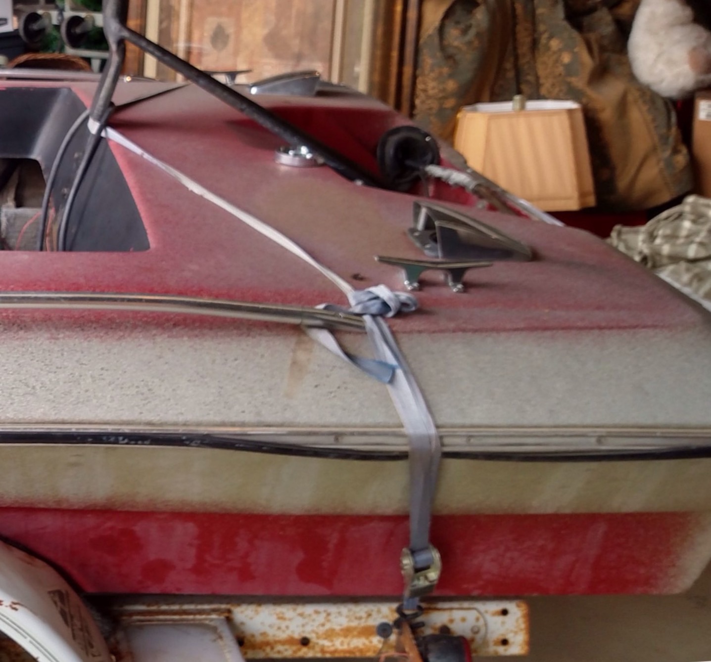

A couple more shots

Looks like those tiedowns caused more work. Not too sure about that ski bar either. If that transom checks OK, I'd say you got your money's worth. Next post, how about a transom pic, please?
