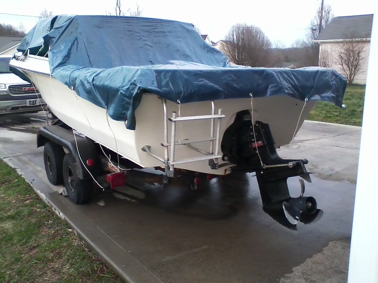

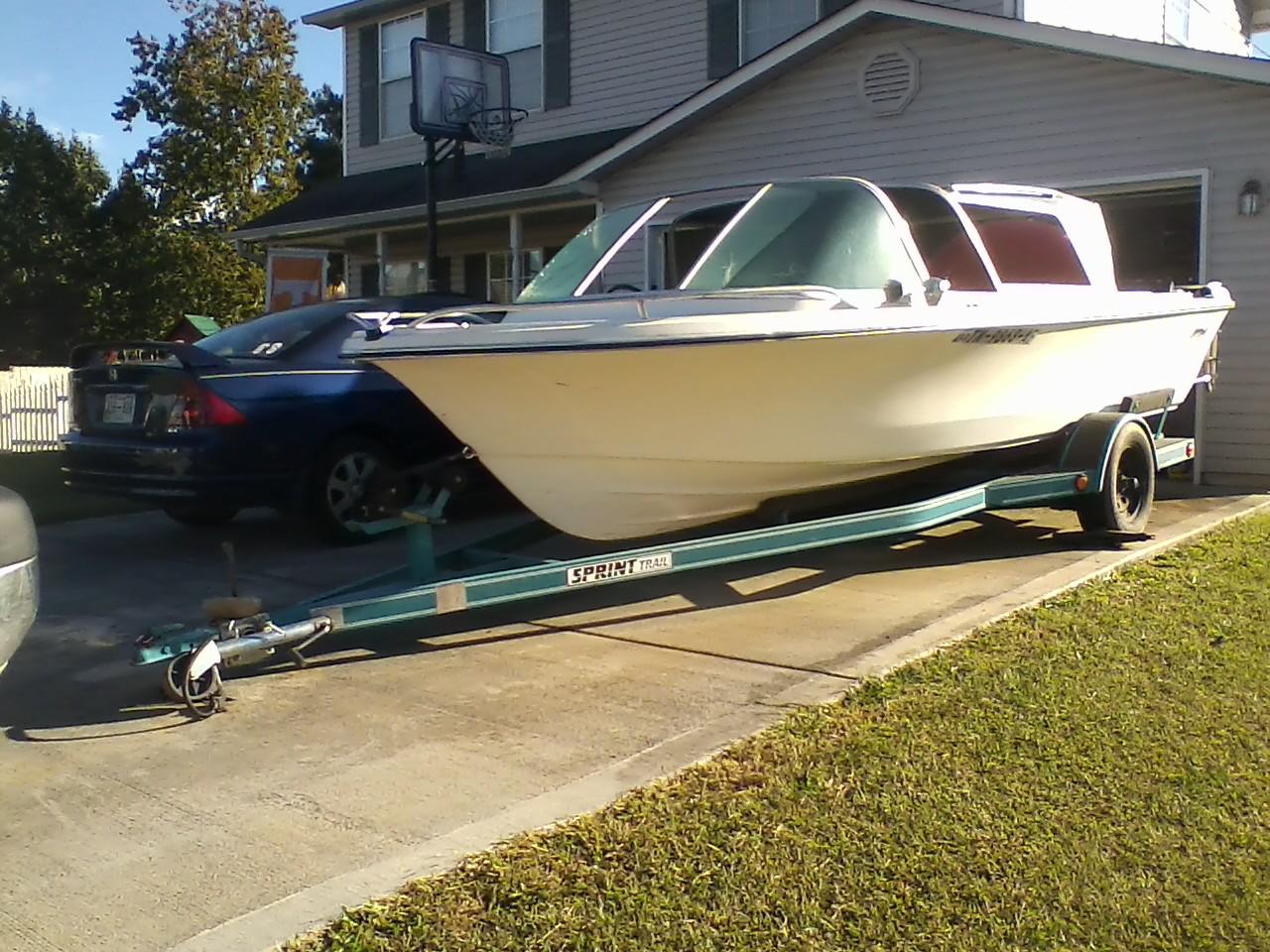

Found this beauty a days drive from the house for what i think may be a pretty good deal. needs work but the hull and gel coat looks to be in great shape.

How is your transom. I believe that the 19 has foar in the floor. and I am not sure what the stringers are made of. I have a 17 that has a half fiberglass and half wood transom. fiberglass stringers and no foam in the floor. If you have foam it could be water logged and it will never dry out.Does the boat seem to be overly heavy. if so it could be a hint that the foam is waterlogged. Lots of info on this site. just ask questions.
good luck
Fred
Re: 77 Aristo Craft Nineteen 12 years 4 months ago #96741
Transom seems solid, port side floor feels soft. Unfortunately the boat has sat since I picked it up and brought it home. Too busy with work and haven't done anything with it this year.
