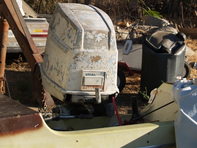

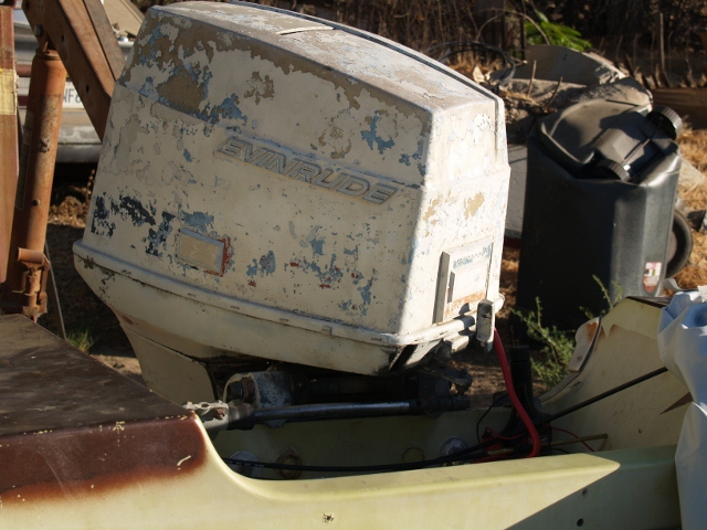

Okay I picked up this cheap(right)1970 16' VIP bow rider. It came with a 1963 Evinrude 40HP select shift motor and single cable steering. Well the 40HP had some issues so I repowered with a 1976 Johnson 70HP. it runs great except for remote cable hookup.
While working on it today I noticed that the motor will turn starboard side of the boat but very little to the port is there some way to adjust this. It worked fine on the old 40hp.

I just had a n epiphany in the shower a piece of 5/16 all thread and 2 heim joints will give me an adjustable linkage.
Re:1970 VIP steering issue 13 years 2 weeks ago #84379
On a 76 motor you would hook up directly to the tilt tube on the motor.--Then with a linkage back to the steering arm.--Research required here.
Re:1970 VIP steering issue 13 years 2 weeks ago #84384
Hi,
Adjustment is allowed by loosening the clamp bolts for the support tube of the transom mount, and repositioning (to starboard or port) the tube in the clamp. However, full lock to lock steering of your Evinrude is probably not possible as connected. The best connection would be via the "through the tilt tube" method as the Professor mentions. A longer steering cable (to reach to the tilt tube) plus the link arm assembly would be needed though. Please write me directly if I be helpful or provide some quotes.
Regards,
Joe
www.fergusonpoolemarine.com

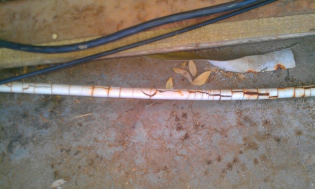

I started to fabricate a steering link last night and will try the adjustment per Joe. By the way Joe the starter motor you got me for the 400 Merc works great, it starts so easy now.
I probably need a new steering cable anyway as the plastic casing on this one is very brittle. The cable runs smoothly in it but the casing is falling off. I do not know however if the steering box is a Morse or Teleflex. I cannot find any label on the steering box itself.
