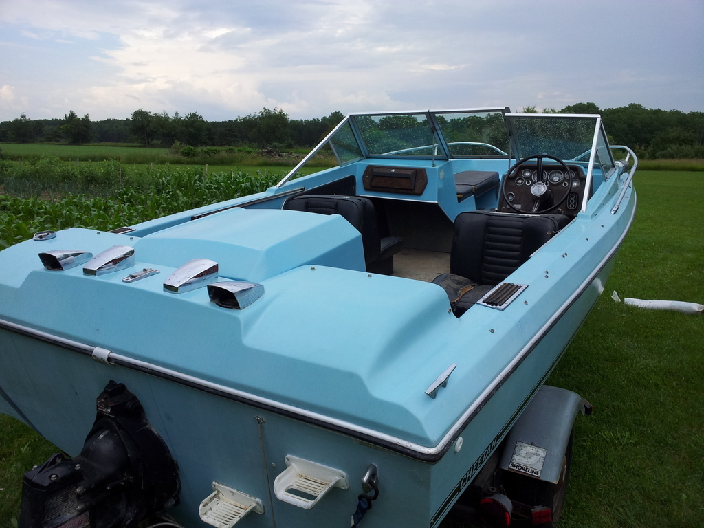

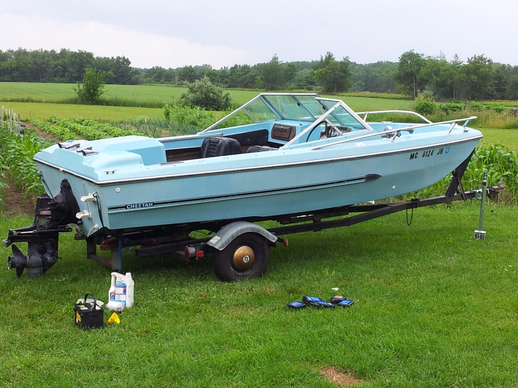

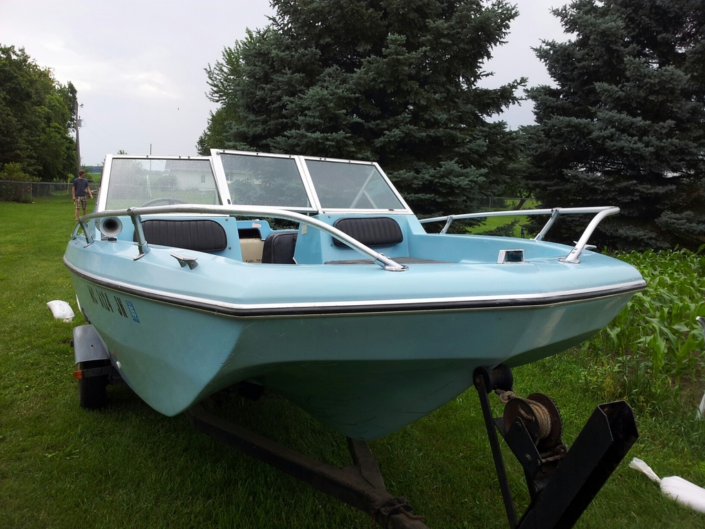

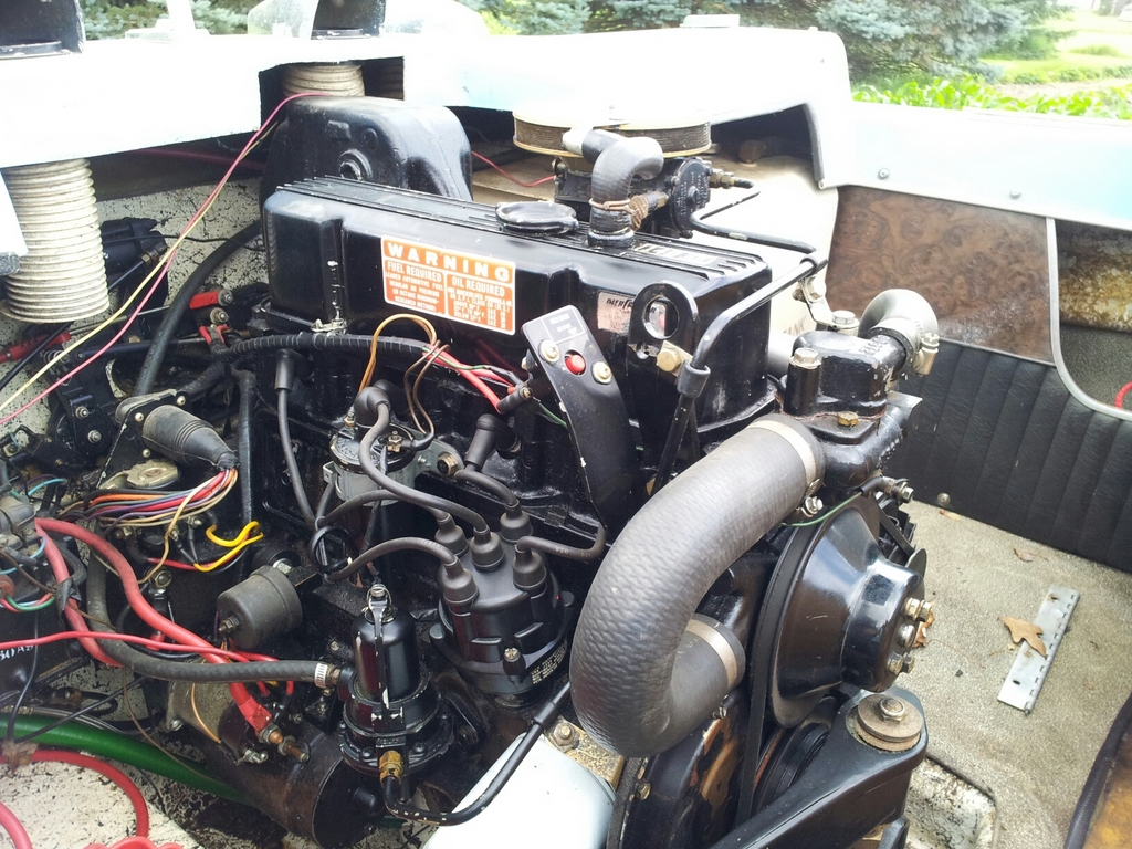

New to this forum, and to this boat. Was just given this boat from my in-laws (father-in-law bought it new in '73). It hasn't been in the water since 2005, and has been sitting in my brother-in-law's pole barn since then. As far as I can see the only obvious issue is a couple of soft spots on the deck, and a 5" surface gouge on the front center hull. Am expecting there to be more wood rot inside and plan to do a complete restoration. Luckily the engine and outdrive have been very well maintained, and I also have vol. 1 and 2 of the Mercruiser service manual just in case. Where would I find a matching color finish (gelcote?) for the exterior areas that need repair? Can't wait to get started on this project!

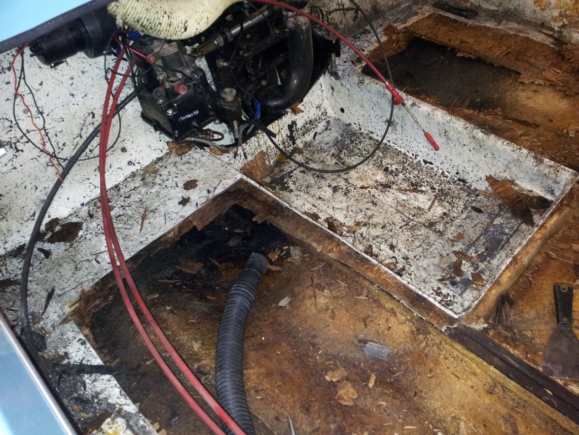

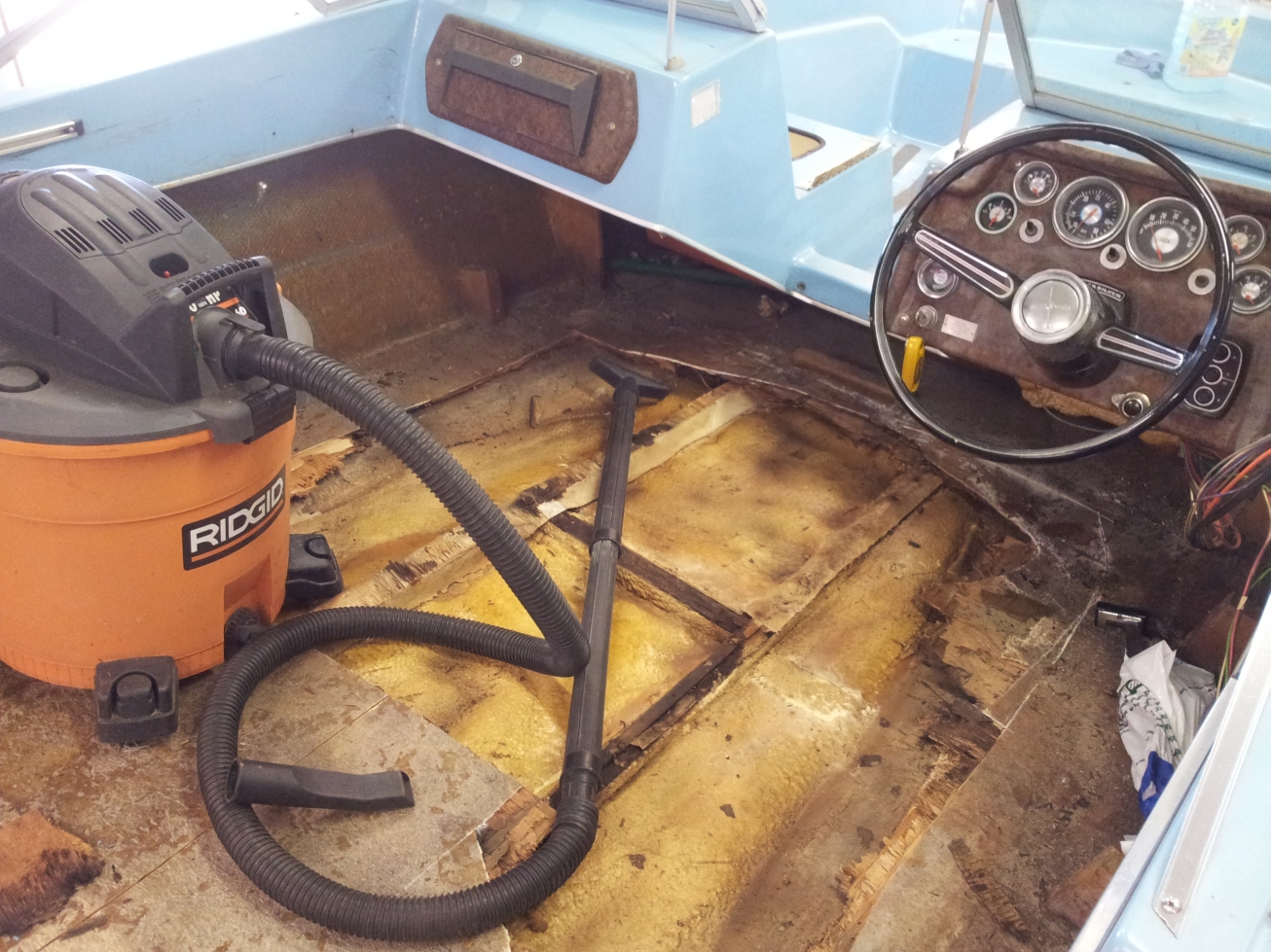

Well, now that winter is upon us, it's time to get busy with a little de-construction.
Have already removed the engine, and a lot of the deck. It looks like the cap is going to have to come off, and will probably remove the inside glass on the transom in order to inspect for rot, and to provide a clean surface for the new stringers to glue to.

Actually the transom appears to be fine, although I am still going to remove the inside fiberglass skin in order to reveal the whole thing. I suspect there may be rot along the bottom in the bilge area.
As much as I would like to NOT remove the rub rail,cap/top deck (sorry, still not well versed in all of the nomenclature), I think it will be necessary to do so. The problem is the wood rot extends into the bow and stringers (core?), and the only way to get to it would be to remove the top deck because the bow area is a big tub that does not leave any accessible clearance underneath it.
What type of wood should I use to replace the rotten stringers, and deck sheeting? The sheeting is plywood, but should it be treated, non-treated and glassed on underside. Not sure what wood was used for the stringers.

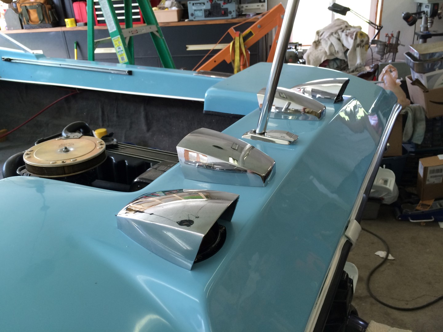

Re:Newly acquired 1973 Arrow Glass Cheetah 11 years 3 months ago #111765
Ok, so almost two years later she's almost done. Hope to put her in this weekend. Will be the first time in ten years she's been in the water!
Wound up completely stripping her down to nothing, new stringers, new deck, new upholstery, etc...
Here's the latest pics I placed in my gallery:
www.fiberglassics.com/gallery/category/422-1973-arrow-glass-cheetah.html
