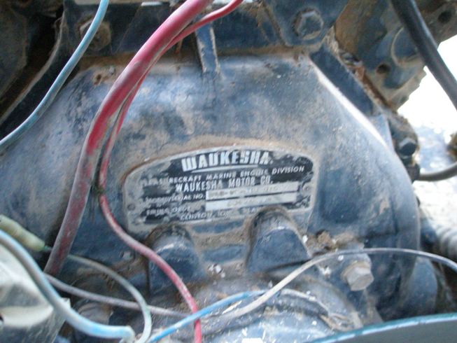

OK. On the trim 3 button switch ? I had to look it up as never had a Merc I/O.
"Pushing middle button trims motor up to when trim limit switch open. You then need to push middle and top buttons together to tilt motor".
So basic you push the middle and top button for "trailering" full up mode. Same the 2 bottom for full down. Just the middle button is for use under way "trimming" the outdrive for best angle of attack.
I GUESS anyway! Confusing the middle button as "up and lower out?"
Re:1973 22' BELL BOY new to me boat... 13 years 3 months ago #79730
Ok, so I think that all makes since...
So the way it is working now when I press the down button it works perfectly going all the way down using the motor all the way down. When I press the up button nothing happened. So I ran down to the auto parts store and picked up a Ford solenoid and plugged it in. Now as soon as I touch the power to the large lug it goes all the way up automatically to the trailing mode. LOL Ive been trying to find the correct Solenoid on line but all I can find is the solenoid's for the newer tilt system that requires solenoids in the system. Any idea where to find the correct older style single solenoid? Now that you posted up how it is supposed to work I think I can figure it out... Thanks soooo much for taking the time and posting up this info. Im sure it will help many more than just me now and in the future!
Thanks again.
Just a quick edit here... The replacement solenoid is the exact same as the ford solenoid that I got at the auto parts store today so I guess it is a wiring issue.

Pretty sure the switch /wiring is corroded. I got that pic off someone selling ebay. Search merc trim I/O 3 button switch. If not found, I'll get the link tomorrow.
Thanks again.
