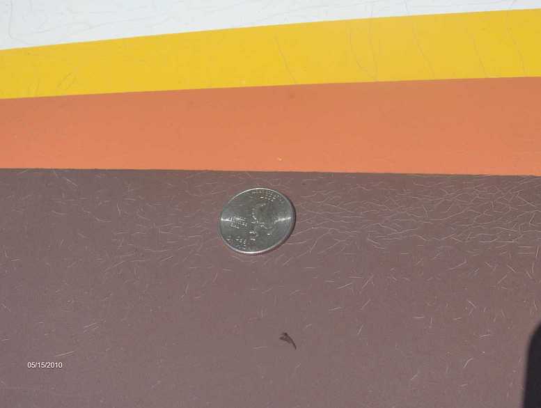

See attached photo, it was before I started cleaning and polishing and its a lot less noticable now, but its still there. Would I have to wet sand it down and recoat it to get rid of this?
I put a quarter next to it so you can get an idea of scale.
Its mainly on the bow area, which naturally is exposed to the most sunlight.

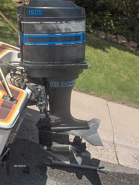

Ignore the motor picture, I attached the wrong image. its the second picture

Sunlight and flexing. Does this one have a clear coat? If not it looks like gelcoat failure - usually revealed as crazing but in this case these little cracks. Nothing you can to short of a total refinish.
Just my opinion
Peter
