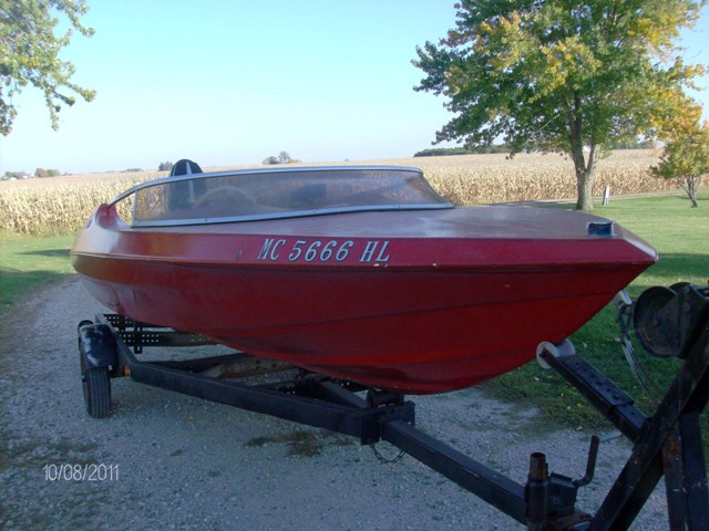

Picked up a '71 Tahiti early October.. I had been hunting for the right boat to renovate, it isn't a Sidewinder but by golly close enough for me.
Someone covered up the red and silver metallics with some crappy red paint...

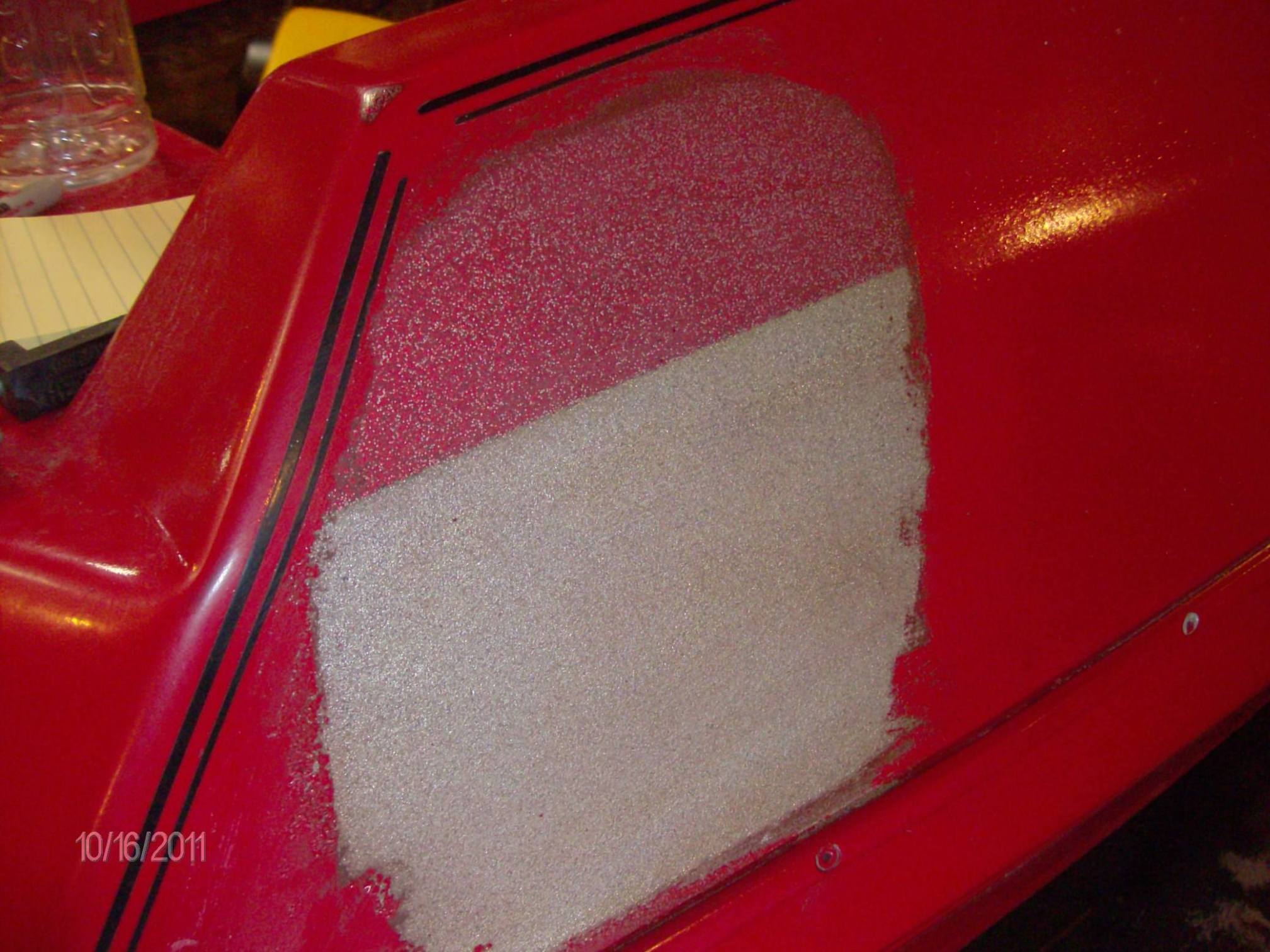

Stripping paint - has the nice tri stripes on the deck...on going

this is when I brought it home !

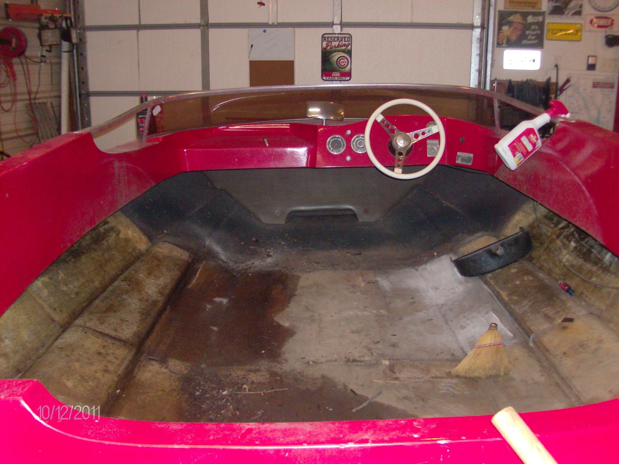

After pulling seats and carpet out and a lil sweeping

here are some pics from yesterdays work .. pulled the gauges and wheel... stripped the deck off, pulled the windshield, cut back a couple ft of the floor, chiseled up along the transom.. when pulling windshield found another soft spot, around the spot the sets were sitting...
side view aft removing some more of the red paint
gauges pulled ... notice the set of stripes...OMC gauahes .. most likely will get new gauges in the end...had an old hours meter. with a minute hand too?
Removed about 2' of floor in the back, chiseled out the along the transom.....

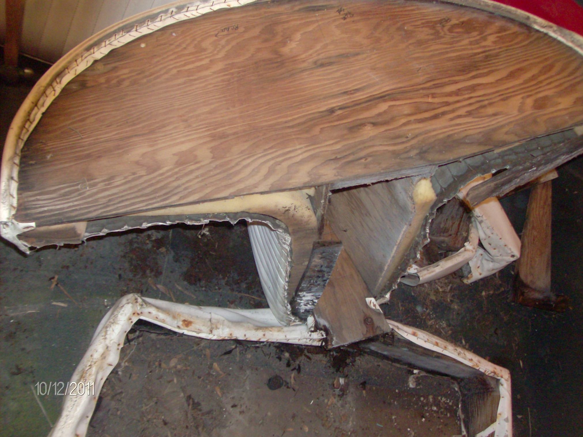

Well pulled the trigger...after much debate I hope all turns out good... time will tell...
splash well cut out !!
transom a bit wet!
the great hole
wetter .. i have not found one dry pice of dry wood back here
as I left her for the night..
Matt in Illinois

MarkS wrote:
Are you going to cut the floor back (forward) to access the transom all the way down to the bottom of the hull?
already did sir see pictures above....about 2'..need to measure out bilge well ..but will need to remove it too.
Its a bit strange on the structure of this transom.
I measured 1.5" for thickness. It was only glassed about half way up.
I am going into this blind, only help I have is from the helpful and supportive people on my forums I use.
So keep up the good work !!
