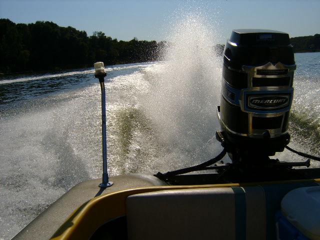

My "first" on my own transom rebuild was a 70s 16' sidewinder low profile. I did the splashwell cut, as the s/winder's transom only went in the middle, I bought the boat for 350.00 so I wasent out much if I messed it all up. I did learn alot......mostly what I did wrong.
1st thing was, I didnt clean off ALL the old wood to clean glass.
you must grind all old wood off to clean pure glass,not to deep though.
2nd thing I did was I used....treated wood........unless treated wood is several years old and dry, resin usuly wont stick for long. And mine only stuck for about 4 drives, I heard a pop and a creek and then the wood was seperated from the hull,though still strong and covered non the less it wasent attached.
3rd thing I did wrong was,when I tried to just refitt the splashwell I didnt grind the "crack" area at all, I used some screws and washers to level it and glassed it from below and removed the screws and filled in the "crack" , months later it looked crappy but it did hold.
I used this boat for several years but I had to use some angle iron on top and a aluminum pad on the back to keep it tight, It ran in the low 50s with its 115 merc and an 18p chopper, but I knew in my head I did it wrong. not so much the splashwell cut but the rest was a "learnd" experiance, Ive done several boats since and all of them came out very good.

Do you have pics of splash well you are describing?
Also I dont understand what you mean by adding angle iron to keep it tight?

Dave, that is the only pic I have that comes even close to the splashwell, I did it before digital camers where commen,
I cut 2" wider than the transom cap and went into the well area about 12", a rectangle cut, it gave me axcess to all the transom area. The angle iron went "later" across the top and a flat, the same width and bolted at both ends and the top holes by the transom clamps, the lower was just an old peice of aluminum pad. I also ran a 2x4 on the inside across-on end, and bolted the lower holes through it. before I did all that the transom was....rubbery, this tighened it up and when I used the trim it actualy lifted the bow.
