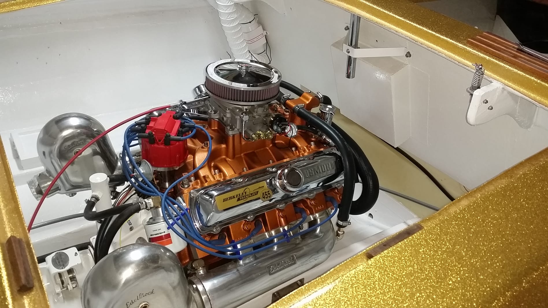

Thank you much , been a long time to get to this point , aside from a few leaks and and a couple of valves that need to be adjusted its almost ready to go back into the boat . Thanks to photobucket all the boat pics are gone so here are a few pics of the beast . Gil

Final timing check and carb adjustment and leak check , its got a nice lumpy idle at 850 rpms lol

1974 Glastron Carlson CV21 8 years 3 months ago #136902
The engine is in , just have to hook it up and then water testing .
