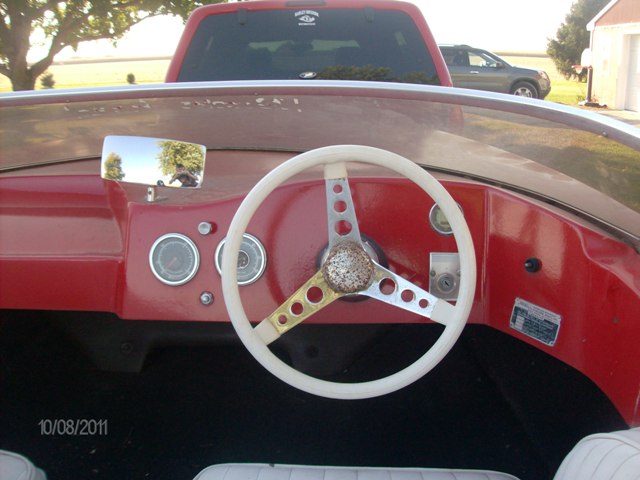

Congrats on your boat, I have a sweet spot for the 70's sport boats. You have an EXCELLENT candidate for a full restoration where all the parts and interior is there. I would use all that to bring it back to original. In the end the boat is worth more if it is correct, just like cars. I believe we all will find the interest in glass will continue to grow and the nice examples will be worth more, much more as original parts are discarded through carless restorations. Just my opinion.
Persoanally, I enjoy the challange of making it "right" it is easier to do it incorrect, so many take the easiest path, nothing wrong with that but it is pretty cool when you see something just as it was.
To do the boat right you will have to split the deck off, gut all the rotted junk and rebuild, it simply is the best way, it takes time but in the end worth it, it sounds complicated but it actually makes everything a lot easier. Keep the pieces as intact as possible for templates if you can. The good news/bad news is that the boats were not made that well so they break down over time but then again this makes it easier to remove all the broken down pieces. Keep all the original labels and tags, emblems for boat too. There is aguy who will laser cut emblems, I'll bet he can do very good original sidewinder emblems if you can obtain a good photo of one.
As far as the instruments go, and again this is my opinion, Think about what you want in there BEFORE you do the restoration.
That way you will know what to do with the dash holes. Also it is helpful to know what motor, so control mounting, steering, tilt/trim can be anticipated.
There are plenty of clean period correct instruments on e-bay all the time, look for matching some if you want tach and speedo etc.
I would consider having no gauges then you never have to worry about future issues with having to instal a non matching gauge.
I do it both ways, with correct vintage matching and also without.
If I do no gauges I still run a modern water pressure gauge under the dash so I don't have to put unwanted holes anywhere but monitor the single most important engine status, the gauge cna be hidden away at show time. You can use a tach in your hand to do prop selection, you never really need a tach after that, and just have a hand held GPS for speedo if desired. I find it just as much fun enjoying the ride and not knowing my speed /RPM, simplicity has it's virtues. Modern gauges take away from a vintage resto but that is my opinon only.

63g3:
Thank you...if paperwork all works out..i think it will be renovated back to original the best i can...as you can see in this picture dash looks unscathed...this boat is all original.(except the pain)t.still has original or at least looks like origianl coat of fiberglass ver the plywood for the floor..... Seats frames are trashed along with the bases...i did as you mentione actually before reading this, i pulled the seats out the other night marking seating and ever so gently pulled the main sectionals out... one base was 1/2@zz there measured it out and marked them down..
Seating ....

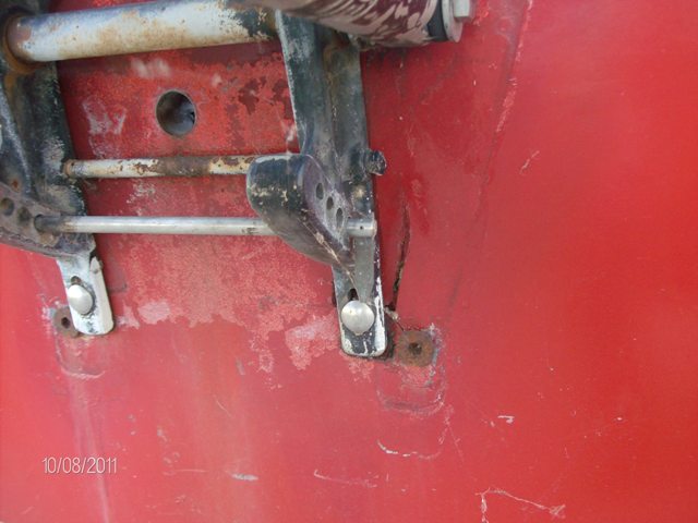

boat was equiped with a late 60' 65hp Merc...with control..no key...just so I had same set up at home and luck would have it SAME KEY !! motor already pulled...we pulled this a few days after bringing it home...unfort. the lower part of the motor bracket punctured the glass at the rear..wood inside is gone (mush).
thingking boat was stored nose up and water settled at back, plywood floor was saturated too...removed a small section and put a fan on it for 2 days w/ the hope of drying some what out.

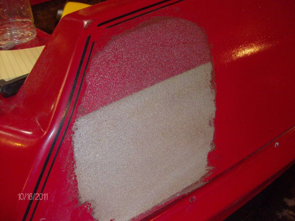

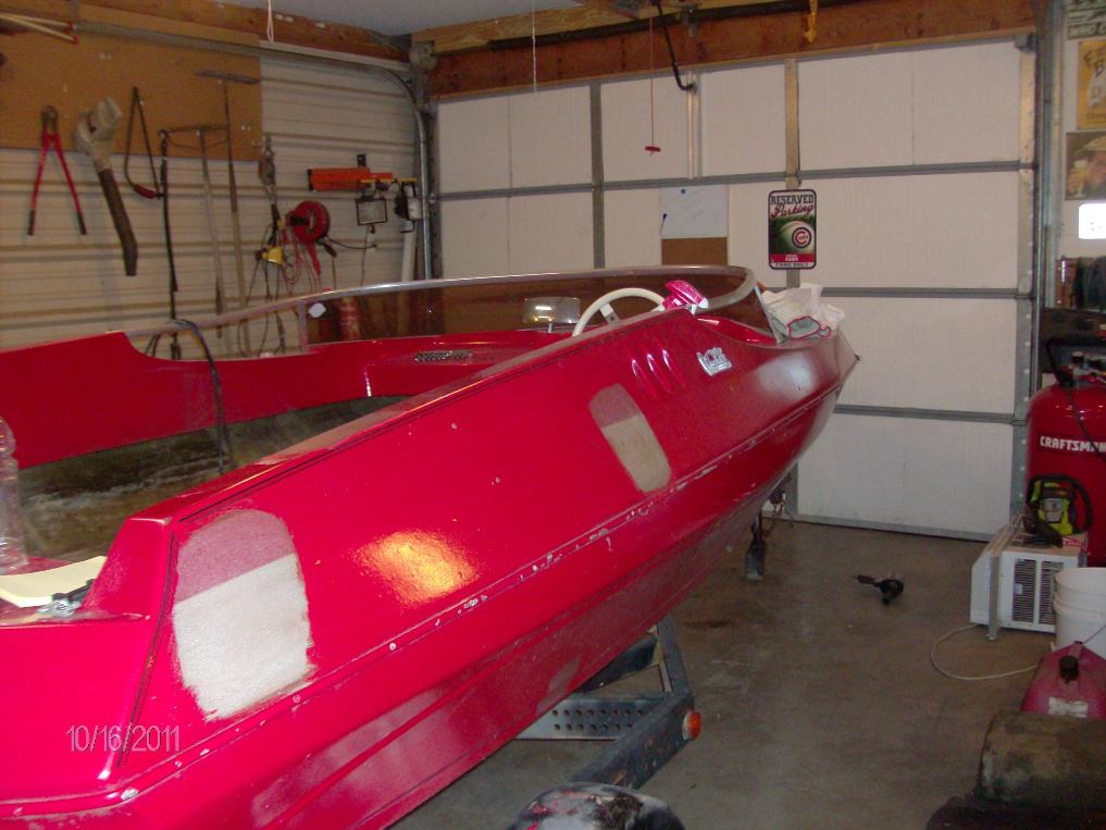

Picked up some Zissler paint stripper (for fiberglass) not the citrus one.
Looks like boats color scheme was that of a red flake accented with some silver.. thinking the whole boat if flaked no solid.
tried taking pics of it not the best quality due to being in the garage.
:unsure: ;) :P :ohmy: :ohmy: :laugh: :)
don't think it would be to hard to strip it down....if i had some help...

"Ataboy" for digging right in and getting started Matt. I know this probably goes without saying, but make sure you keep your "little helper" out of the garage when using the stripper. He's precious, and we don't want him getting that stuff in his eyes, mouth, lungs, etc...... (You too, make sure you have plenty of ventilation in the garage, and maybe some sheet plastic on the floor to make cleaning up the mess easier?) Looks like he's into the project there, great bonding time with Dad!
Keep the pics coming, great to see you're already "elbow deep" into the process. ;)

Looks good, do the hard stuff swhile you are cranked up about the boat! A tip on stripping. I get thin plastic, like the cheap dropcloth stuff at the Depot. Line the floor under the boat with it so after you are done, you just roll all that has dropped on the floor up and throw it way. Also very helpful: After you slather on the stripper, cover it with the plastic, this keeps the active ingredient from evaporating away and aids in lifting the paint off.
It cuts down on odor too. Just let it sit for a few hours and the paint will come right off with a plastic squeege blade. Do this in the shade not sun!
Randy

Thanks guys .. I stripped a lil more paint tonight to get a better idea of what it may have looked like back in '72.
I do need to line the floor that stuff I'm using i think is potent enough i think it was pulling my sealer out of my concrete thanks for those tips randy.
