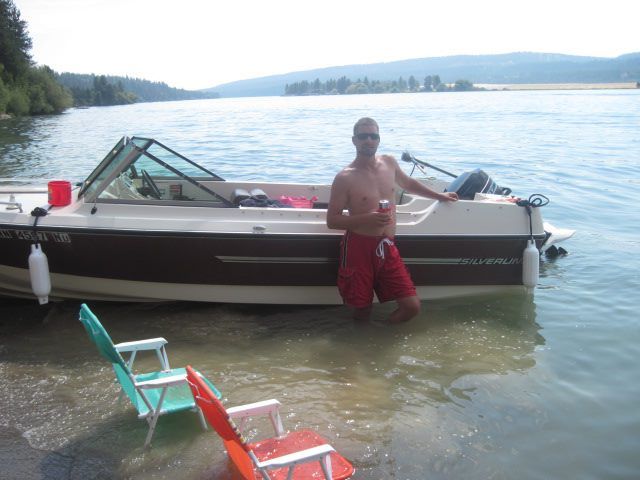

Here she is on the water last weekend...
