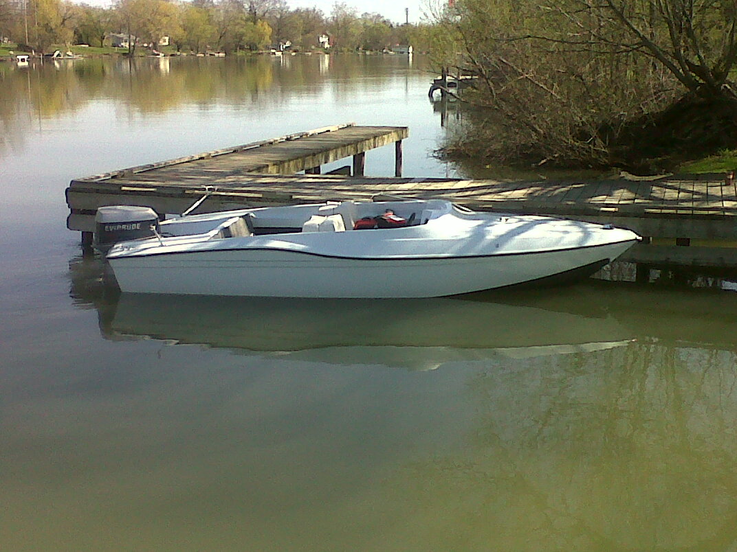

Here it is Docked! Beautiful isnt she!

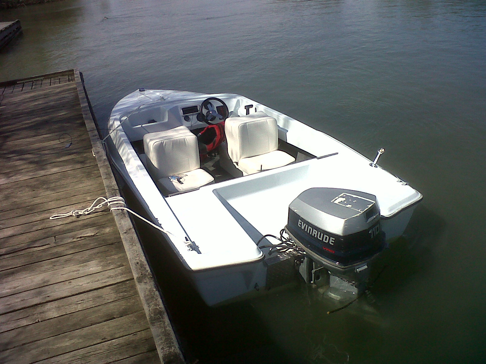

another shot.
Re:First water test after the overhaul! 15 years 5 months ago #31145
SWEET! :)
Love the lines on the Conqueror 15 years 5 months ago #31174
They look sleek just standing still. Did your boat come with that cut down windshield they used or not? Personally, I like the way they look without them. How does the lack of a windshield effect getting wet? Great boat and continued good luck with it.
