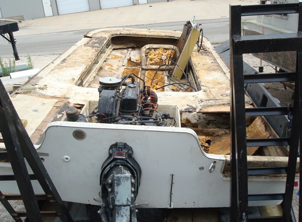

Well....I got my hands on a 1974 Deck Boat (Brand). It was totally neglected. I believe this boat has sat uncoverd on a trailer since 1995. It is 18' in length and powered by a 140 hp I/O Merc. The engine is missing a fuel pump; however, the motor turns freely and the old engine oil appears normal. Anything is rebuildable right. It might start up with a little fuel....Anyway, I'm not worried about the engine.....That is a very commone engine and simple enough to repair/replace.

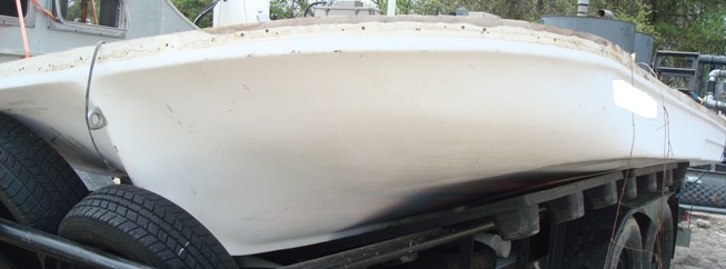

Initial inspection reveals the deckboat's exterior hull (upper & lower) is in very good condition with almost no spider cracks scrapes, dock rash or other blemishes. After vacuuming & cleaning the interior of the boat (almost two cubic yards (half of a small dumpster) of leaves dirt, tree limbs, mulch, etc. followed by pressure washing with hot water. I have found that the original interal decked floor of the boat is virtually gone.
Backing up.....This fiberglass (frp) boat was manufactured with solid wood stringers (Side keelsons) overlain with frp. Solid wood was a poor choice by the manufacturer. Internal structures (ribs & floors) of the boat were 7/16" marine plywood overlain with a single layer of frp (poor choice - but effective for a while). The intire area inside/between the floor & hull was filled with pourable polystyrene and covered by the floor. This construction method's premise was relatively good as the entire area between the original floor & hull was originally completely sealed as a composite structure. Since the floor somehow rotted from the neglect.... allowing rainwater into the originally sealed area....This area is now in poor condition. Is it repairable? Sure.....anything is repairable! Question is does anyone have any simple effective solutions?

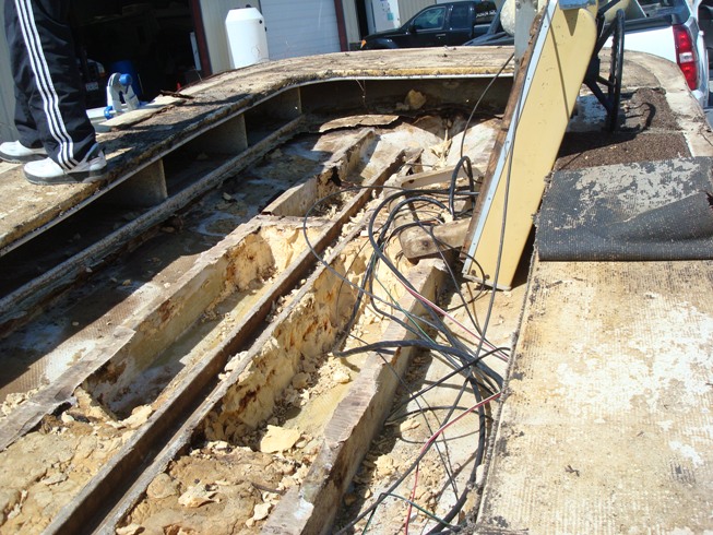

With the internal flooring or what was left of it removed...I tested areas of these side keelsons. I have found that these solid wood side keelsons (rib runners, stringers) are totally internally rotten. The frp tops of these runners can be easily removed; whereas, the rotten wood core can be removed. Can they be filled/fitted with marine plywood and/or a closed cell foam/frp product. Ideas? I'm sure someone has some ideas? Originally, the solid core keelsons & frp casing were bonded to the hull frp. I'm not sure if it would be a good idea or necessary to cut this completely from the inside of the boat's hull.
With the internal flooring or what was left of it removed...I tested areas of this waterproof foam. I have found that rainwater has penetrated the hull/foam contact. I have found that a water/fuel mix has penetrated and actually destroyed (saturated) the foam near the fuel tank area. Therefore, most of the foam has to be removed/replaced. Ok, fine....I can handle this too. They do make a pourable closed cell foam; although, I have forgotten the brand name. Ideas?
The transom plywood is likely in poor shape; however, I have found no significant breaches. I have found a small hole in the outer hull edge of the lower transom. I have not removed the transom's internal frp; however, if there is no viable cost effective solution(s) to the repair of the side keelsons & stringers mentioned above. I need a cost effective repair solution or I will not look further.
Don't get me wrong....I have replaced a transom before in a houseboat with twins & I had use of a chopping gun; therefore, I am familiar with the process. Right now, I do not have a chopping gun. I plan to frp any new repairs by hand with cloth & mat.
I guess....what I am asking is.....can anyone help me with a cost effective & timely solution to these repairs? Or do I need to get out a chainsaw & cut the boat up & throw it away. I mean...in good restored repaired & running condition....this deck boat is still only a $5K boat. Right now, I am budgeting no more than $3k for all hull/motor repairs. I plan to complete almost all of the repairs myself.

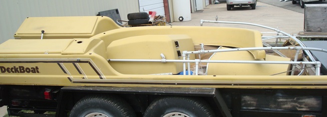

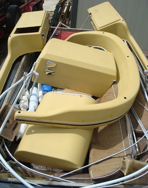

Thanks so much for your input! I am posting some more photos of the boat. The upper & lower hull components are in good to very good condition. It is the interior side keelsons, interior flotation (foam), interior floor and some of the seating supports that are in very poor condition. Oops! I don't know if the transom is bad; however, if I was to replace the other.....I certainly would replace the transom too.
I am not trying to defend your suggestions to strip & scrap the boat. I am trying to make an intelligent decision here! I just hate to scrap it if there are some good suggestions for the necessary repairs.
I would like for you to take another look. Please feel free to state any additional comments. Mean comments are OK! I believe in stating the facts.....Mean or Not!
This is an 18' boat (big lake boat!)with lots of room. There is relatively little exterior work to be performed. The foam core for the seats is still intact. Of course, they need to be recovered. The railings are all perfect. The instruments cowling, instruments, steering & motor controls (maybe) appear in good condition. Hell, I even have a prop!
Take another look at the photos. Please comment!

Ok, glad you posted the pics. The hull and the topside look pretty decent. My concern is foam and the stringers. If the foam is saturated it Must be removed and replaced. The cellular structure of the foam needs to be intact to act as flotation...very important in a boat :ohmy: Saturated foam will weigh a lot and your boat will never perform correctly and will be unsafe. Once the foam is removed you need to check all the stringers including the ones that were previously not visible. The stringers would have been fir encased in fiberglass. The stringers provide the structural support, the fiberglass just keeps the water out, or was supposed to. You will have to cut new stringers and they will have to run the entire length of the old stringer. You cannot just cut out the bad section and put some wood in its place. The stringer gets it strength from its continuous length and its vertical orientation. You can construct a composite stringer from plywood, laminated together with waterproof glue. Overlap any joints so that there is no continuous breaks in the stringer, just like a hardwood floor has staggered joints. Dry fit the new stringer into the fibreglass cavity that was created when you dug out the old stringer. When you are happy with the fit you can glass it back in. The stringer has to sit flat on the bottom of the boat, not just rest at each end.
When you get to the mounting blocks for the engine check them very carefully, they were fabricated the same way. These will have to be replaced with solid wood, not a laminated process like the stringers.
During all this the boat must be properly supported on its trailer or cradle since the hull will warp bend sag and buckle when the stringers are removed and replaced. The weight of the motor will be a big factor here. It is best to remove the motor and outdrive, if you find the transom is rotten you will have to do that anyway to replace the rotted wood.
Like I said, you really have to love this boat. Its a lot of work.

Ok! The stringers (side keelsons)...fir...solid likely; but, gone now. Yes, they will extend the full length of the boat. Yes, a plywood composite stringer of marine plywood would work. My question is how to go about it. Like I said...cut the top off of the existing encased stringer with frp sides bonded to the boat hull and stuff new composite stringer inside and then fill remaining gap with resin & mat (or other?) and recap with frp?
Or....cut off top and only one side of existing stringer while prebuilding a new composite stringer which could be pre constructed with frp coating. Bond this new composite stringer to the remaining single side of the former stringer and followed by bonding all to the hull? I hope this is not too confusing!

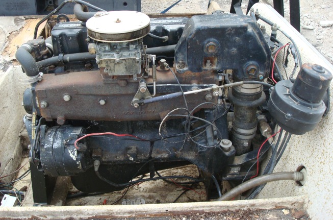

Here is a photo of the 140 hp Mercruiser I/O engine.

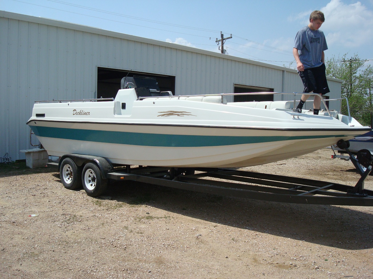

I think I scored a good one....I found something that will suffice as a large "deck boat". I found a 1994 VIP Deckliner.....It will get a new (remanufactured) 260hp Chevy engine with 3 yr wtty. Looks to be in good shape. Yes, the boat costs more than the $3K that I wanted to spend. It always seems you have to spend more!
