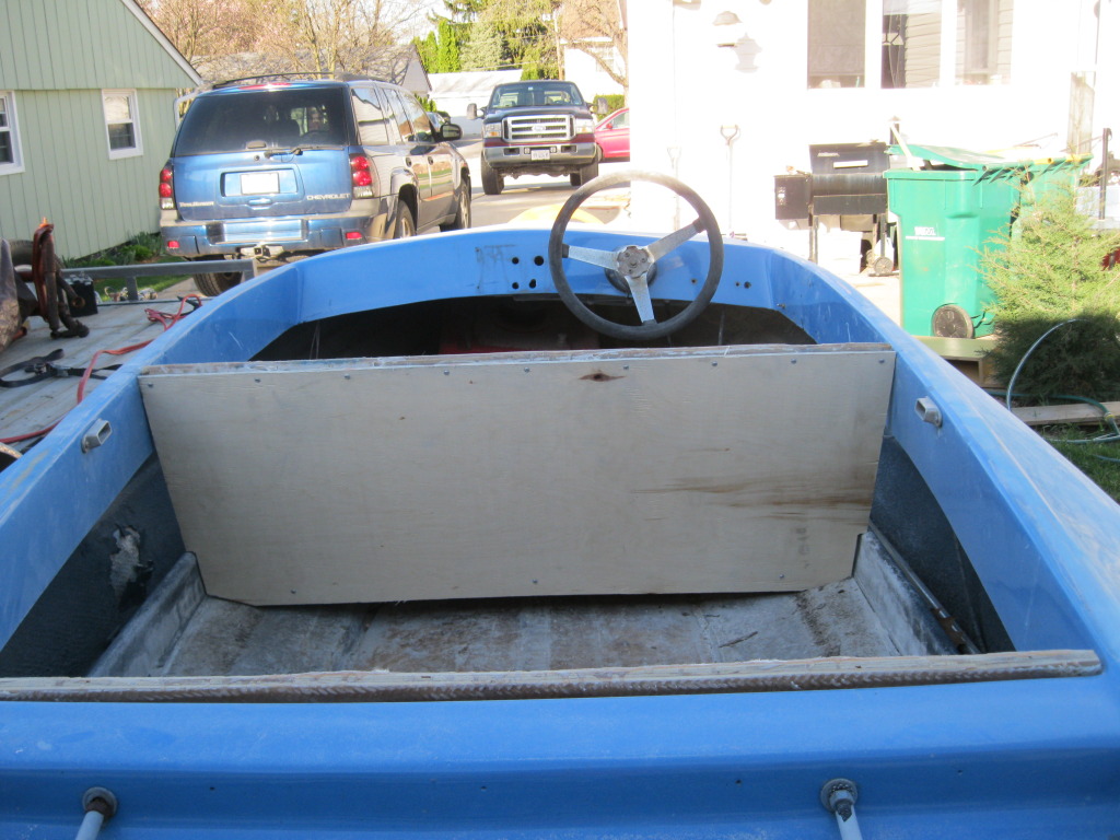

replaced the main stringer, talk about a job. I poured down some resin and then put the stringer in and weighted it so it would adhere down well. After an hr I went back, removed the weights and glassed it in. I used fiberglass mat and resin and it took way more than I thought, I was hoping for maybe 10 ounces of resin and it ended up taking 25ounces.
after taking a measurement every 6" and then trimming to fit, the main floor is ready to go in. Im using 4ply 1/2" instead of the 3/8 balsa that was originally used. Ill glass the bottom side before putting it in place.
Heres a shot of the ugly motor

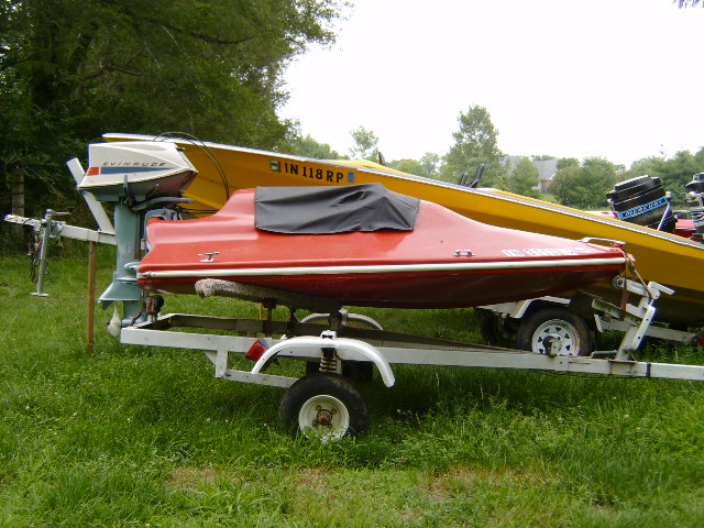

Nice find on the Invader, I live 30 mi south of Sharpsvill IN where the plant is...er was, I also have been trying to save an Invader Torpedo,its a tunnel hull though. the 85hp will be nice on that hull too, I run a merc 1oo and a 115 on my cobra witch is about the same hull as yours
Re:Saving a '72 GW Invader Drag and Ski 15 years 6 months ago #28428
I would love to have a torpedo! Always been a tunnel fan.
Re:Saving a '72 GW Invader Drag and Ski 15 years 6 months ago #28569
Ive had the tunnel out twice, what a weird ride......no bump from the other boats waves, I also have a 1966 8' single seat i run an old 18hp evinrude on, Its a real gas @ 28mph Oh and the torpedo could be bought.......

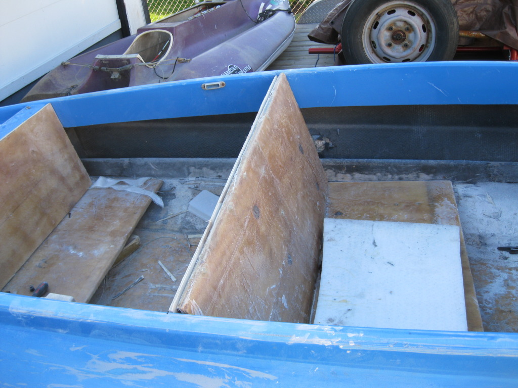

I got the floor glassed last night and glassed in a stringer for the seat deck. Im designing the seat base a little different from factory. What the boat had in it had the seat base completly enclosed, that meant if water got in there it just sat. I am building it as a pass thru so that water and debris can just slide right on thru. I ended up laying 60 ounces of resin and I lost track of how much cloth yesterday. Im glad its a small boat.

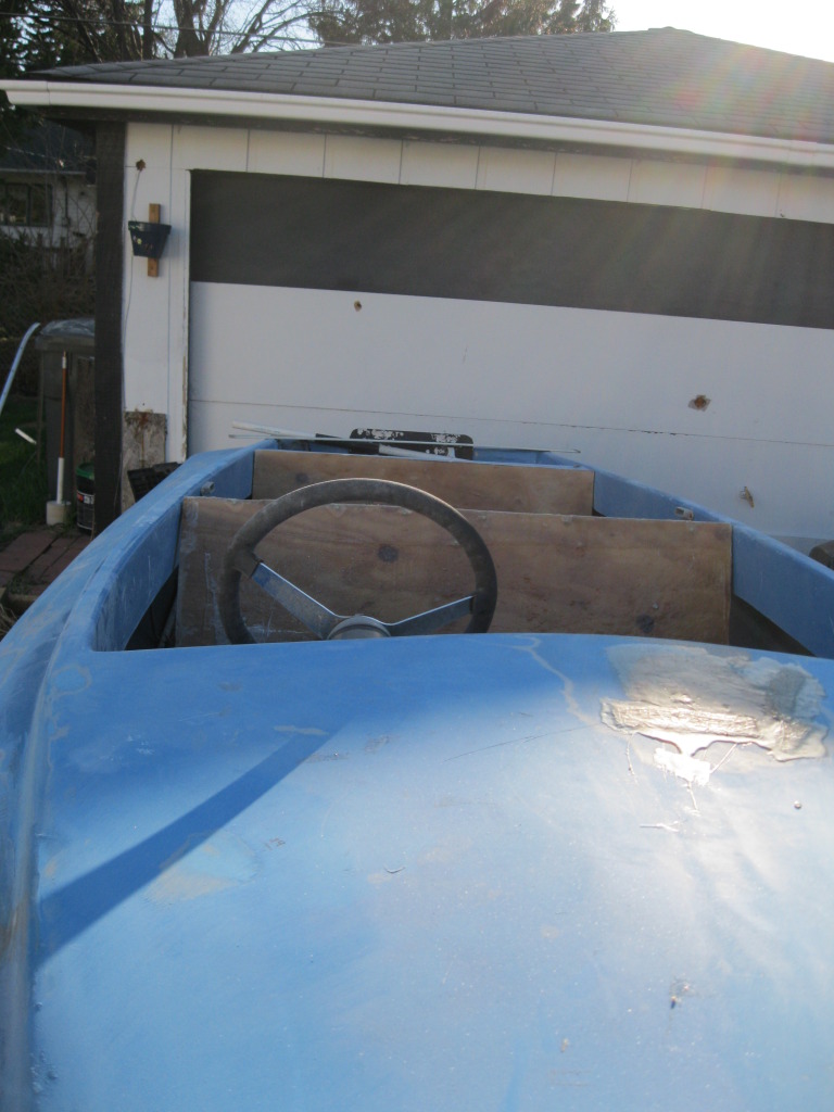

Ive been doing allot of work on the seats. It doesnt look like it but there are several hours getting them to fit and be comfortable. Ive used wayyyy more fiberglass than I would have imagined, using kevlar mat for the rear seats prolly didnt help the glass consumption I am sure. The front seat has a steel reinforcement that I welded together and screwed/glassed in place.
The foam simulates the foam padding so I could get ride height right.
I skinned the rear of the front seat with 1/4" so the vinyl would lay better when I upholster it.

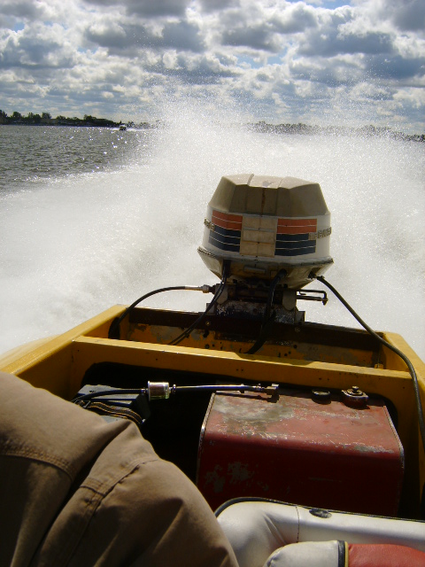

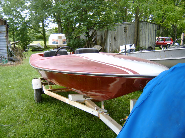

this is my cobra,in red with a white stripe, I hug a 115 on it today to see if I like it.......I LIKE IT!!! we should get these 2 boats together this summer.
