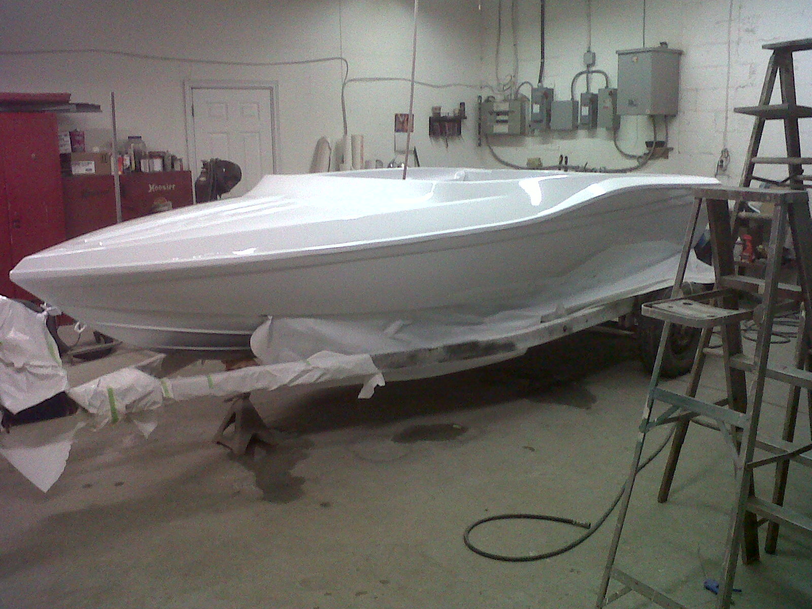

Well for everyone that is interested, I have finally got my Conqueror painted as of last night.. We suspended the whole boat from the rafter's in the paint booth, 3 coats of primer(not sure why he wanted 3 coats of primer) but none the less 3 coats of primer and 3 coats of paint the boat is looking fantastic. Will post pics later on when I pull it from the booth. I ordered some seats from ebay so its starting to come along.. Its moving fast now. Its going to be ready before the spring.....(not really) Have to figure out all the guages installing a bunch of them trim,volts,gas, gps,oil sensor gauge, speedo. and rpm guage. hopefully my motor will support all those features.. Thank god i bought the manual for it. keep you all posted onthe progress

Hey finally have some pictures posted with the primer and top coats applied to the boat. Hopefully everyone on here thinks it looks good. I poured my life into this boat.
Re:Painted my Conqeror 15 years 3 months ago #25225
That is looking great. It will be quite the looker when finished. Keep posting pics!!!!!!
Im just Curious what type of Paint and primer you use ? Enamel , Urethane , Epoxy ?? Ive shot Many Many cars and a few boats .Some Primers you can thin down and use for a sealer . Shoot 1 coat of primer , Let it Flash off then shoot your paint . Its Called Wet on Wet .It helps hide repairs and gives a uniform color to shoot paint over .But there we only Shot 1 coat of the Primer Sealer .Was told if you get to much sealer on the solvents of your paint can eat into it and youll get a reaction .Unless it was epoxy primer mixxed as a sealer and he let it sit awhile like hours and then Shot the paint .Whatever he did it looks Great and is gonna be a cool boat . Im just curious and use to spraying Cars .. If you dont ask you dont learn ..

We used 3 coats of epoxy primer, let easch coat flash over roughly 45 mins to hour each coat of primer and yes you are right it helps hid repairs. I had a bunch of spider cracks in the fiberglass from the boat twisting and what have you. Then we let it completley dry and what ever imperfections were in the primer we simply sanded them out and applied some more fiberglss putty let cure primed those areas again then shot the paint wet on wet for 3 coats. My step dad who painted the boat has worked for a few boat builders over the years and has a bunch of expirience building and painting them..
Im not sure the exact name of the paint he used but i know there was some reducer involved and some hardner in there as well. The paint that was used apparently has a 10 year guarentee for shine.

Hey Kevin ..That makes sense .I was reading your post late and must have misunderstood you . I thought you just shot 3 coats of paint over 3 fresh coats of primer ...L.O.L...Yes it sounds like your Step Dad knows what he is doing . Epoxy Primer Sticks like a mad man and is a excellent choice for UV and Water protection . By the looks of it Ild bet he used a Single Stage urethane Like Imron or Croma one . Gets almost a Clear coat shine but is alot tougher .Keep up the good work . You should have a Beautiful boat for a long time when your done .

If I remember correctly he said it was Imron.

Imron Excellent choice .Tought as stone . Just wear the proper resperator or better yet Air Supply when you spray it Otherwise Youll wake up Dead the next morning .Thats the same with most 2K paints and primers .Im sure your painter knew that tho .Its hard to enjoy your boat when thier throwing Dirt in your face to hold you down ...L.O.L..Keep up the good work !!
