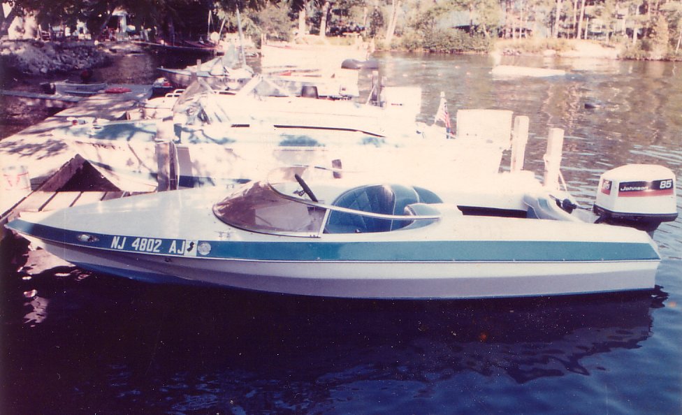

Hey guys, just found this site... And this is my first post... Im in the middle of restoring a 1972 Sidewinder 18SS...
THAT IS ALL!
1972 Sidewinder 18\\\\\\\'SS in resto. New transom, stringers, deck, knee braces... 1976 Merc 1150... Rebuilding my original with help from the all elite Dr FrankenMerc!!!

Yeah, but mind you its in the middle of resto.
http://i1227.photobucket.com/albums/ee430/cturboaddict/72%2018SS%20Sidewinder/October2010weddingandb
You can follow through the pictues on photobucket if you wanted to.
Just look up Cturboaddict.
I purchased it with a 1971 85hp Evinrude on it, also it has a 1972 EZloader trailer. The boat itself a 1972 18SS.
Whoever owned it before me, deceided to make it into a "fishing boat" of sort? So i ripped out the three fishing seats with swivels on them, tore up the carpet to find a fresh layer of marine plywood unglassed looking at me.
Ripped that up to find a rotten glassed deck... I think you know where this is going. Ripped that up to find rotten stringers and ribs... Ripped those out and figured while in there RIP out the transom. Which i did, so i put it all back together so far adding kneebraces and a thicker horizontal brace to the transom. Glassed everything in, and right now im in the process of fabbing an interior for the boat. Looking to get my hands on two bucket seats and make two long benches for the sides... Its a work in progress, but it will be great when done.

I should detail the extend of restoration.
Stripped down, new transom, added knee braces (extend 3' into hull), stringers, deck and fiberglass seat boxes. Flipped boat, new gel coat on hull along with all repairs. Flipped boat, interlux brightsides (roll and tip) on the hull sides and top. New NFB steering, new perm moeller gastank, new guages, custom fabricated stainless switchplate, dual battery setup with switch, new radio with 5.5s in "kick panel" area and 6x9 in the gunnies, custom fabricated solid rub rail.
CMC PT130 with inside transom washers. 76 1150 rebuilt w/ new or rebuild rings/seals/lower bearings/bleed restric/carbs/fuel pump/dizzy from the doc/.
All work was done in my backyard, by myself while attending college full time while working full time (2jobs), raising two kids, and holding down a household.
Most recently the original owner from the 80s had discovered my photos online and we have chat. He was SOOOO happy to find the boat and that someone has taken the time to bring it back to life. After a car accident left him in a wheelchair- that didn't stop him from cruising Blarney Island with his wheelchair in the winder!!!
