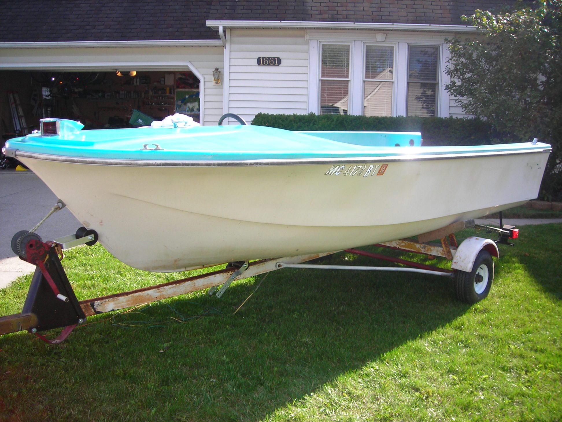

Here's a small picture of the boat when I bought it. I hope to get it outside tomorrow to work on it and will take pictures of what I've done.
Anyone ever hear of Silvercraft boats? All I know is that they made boats in Washington state in the 70's and 80's. Who knows how this boat got to Michigan!

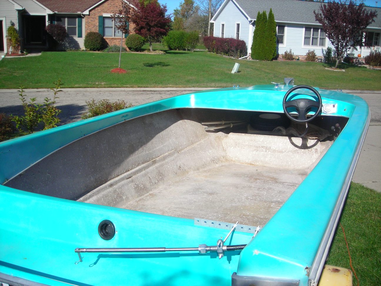

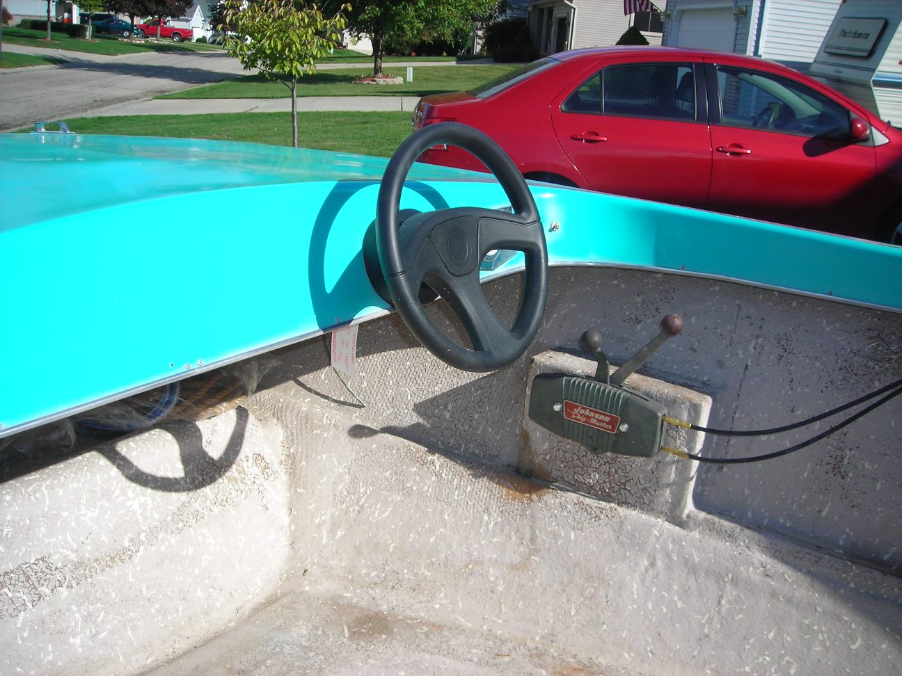

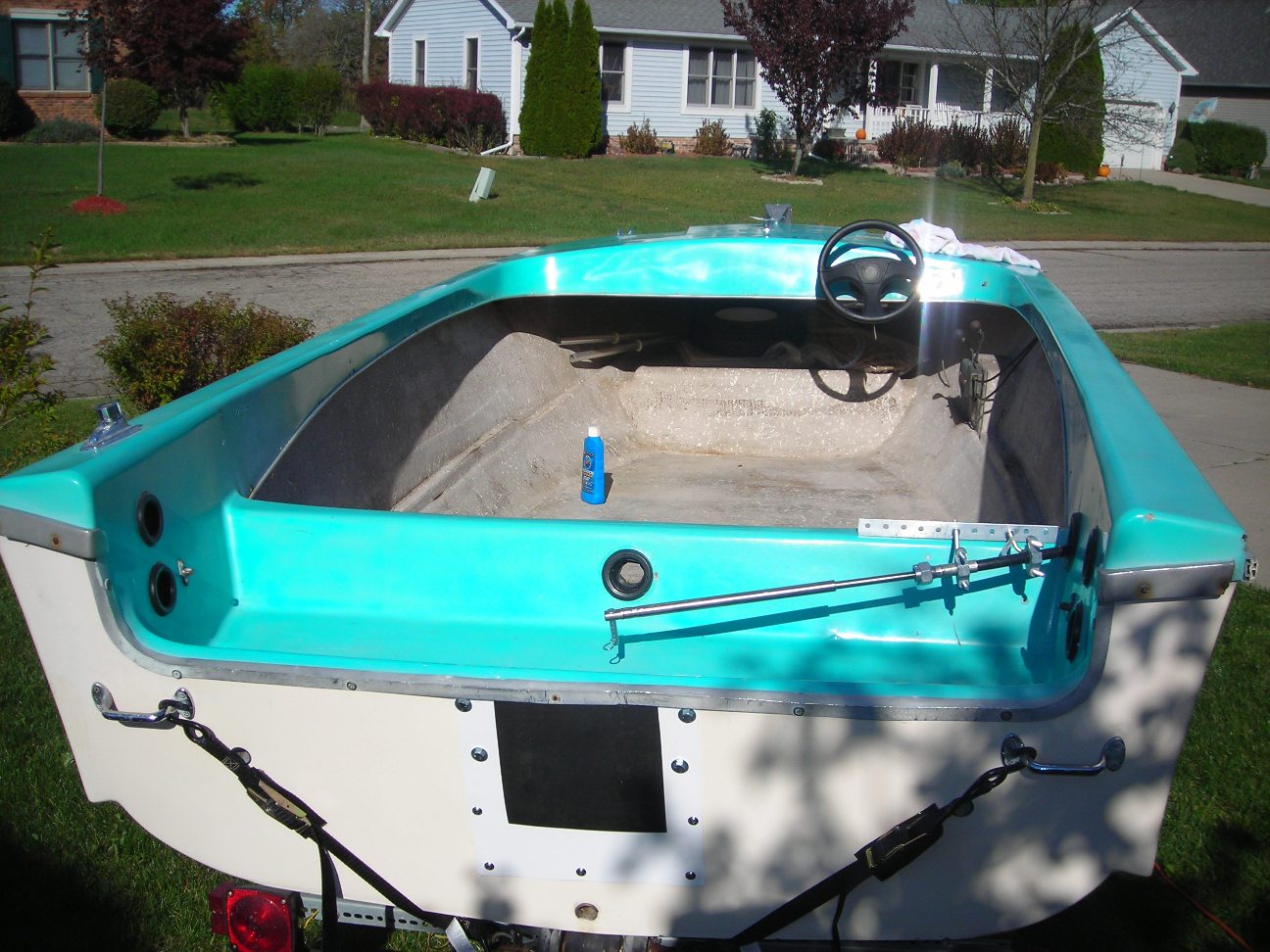

Took the boat out to buff the hull. About an hour in the buffing wheel broke, so I cleaned things up and took some pics.
Any ideas for seats?? Still looking for a windshield too.
Re:75 Silvercraft 15 16 years 1 week ago #16938
Looks like it's buffing out pretty nicely, been there on "blowing up the buffer"! I think buffing out a Glassic qualifies as "severe duty", and the inexpensive ones like I had just aren't made to handle it. (Saving up for a good unit now.)
You can do a "search forum" in the little box in the upper right hand corner of the screen and type in any subject you like, it will pull up any posts on the given subject. I like the lounge seats personally, hard to beat the selection and prices at:
www.iboats.com/Back-to-Back-Lounge-Boat-Seats/dm/cart_id.816648939--session_id.883107515--view_id.473666

Got back to buffing tonight. About half the hull has the oxidation buffed out and I have most of the deck waxed now. My next goal is getting the boat and trailer registered. I have the old registration for the boat, but nothing for the trailer. I haven't found any serial number for the trailer - any ideas? It's a Tee Nee - from the 60's? Definitely not original to the boat.
I may have to register the trailer as home-built. That would involve getting the trailer weighed. Logistically I can't figure out how I would get the boat off the trailer, short of launching it. Will have to think more on that.

For the oxidation I am using Meguiar's #49 Oxidation Remover. My boat has some pretty heavy oxidation and this stuff works.
As far as the buffer, I am using a variable speed drill with a buffer pad. Not the best tool for the job, but it's working. I use moderate rpm and work the product until it just starts to dry. I immediately wipe the cleaner off.
I am following up the cleaning with pure carnuba wax. The process takes a while, but it's looking good. I'm glad it's only a 15 footer!
Anyone have a trick for removing black (rubber) markings from rubrail? In the picture it looks like my rubrail is black, but it's actually white. Sanding it with 120 grit sandpaper will take it off, but it's work. I plan on replacing it, but it's not at the top of the list.

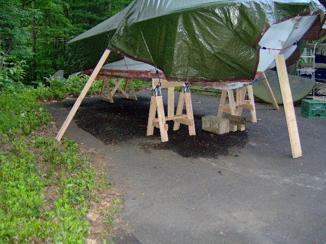

Re:75 Silvercraft 15 16 years 1 week ago #17285

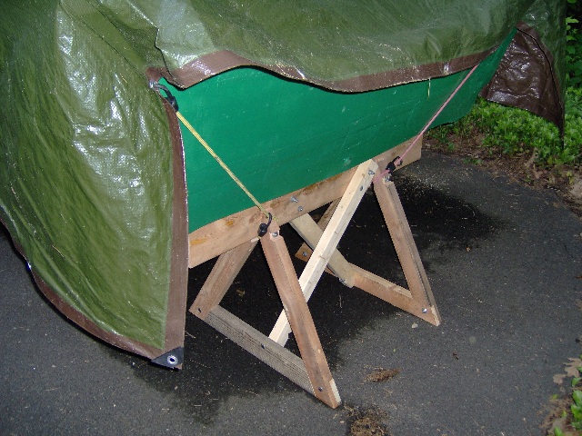

Aquatech,
If you need to remove the boat, here is what I did on a 1000 lb boat.
Get three sawhorse bracket pairs. (mine was a tri-hull)
Build one for the transom. Cut the cross piece to match the shape of the hull.
Build a second one for 1/3 from the bow. Use an extra bracket and legs for support in the middle. (you will have an extra)
Again cut a cross piece as close as you can to the shape of the hull.
Some jacks help in this process.
At least one other person.
Now are there rollers or bunks on that trailer?

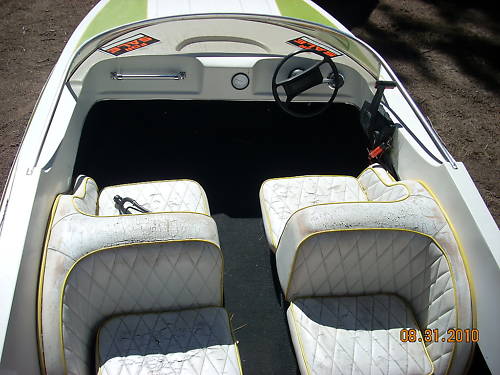

Re:75 Silvercraft 15 16 years 1 week ago #17286
That is going to be a sharp ride when you are done.
Seats? I like back to back lounge seats, but it looks like it may be tight in your boat, and I like original if possible.
How about seats like these? 16 years 1 week ago #17307
Back to back but not lounge seats or buckets/bench.

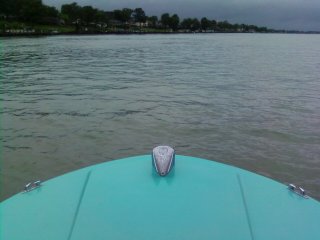

Re:75 Silvercraft 15 15 years 3 months ago #35246
  • aquatech
  • aquatech's Avatar Topic Author
  • Junior Boarder
  • Junior Boarder
  • Posts: 95
  • Karma: 3

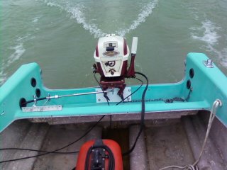

Took her out on the river today. Everything went great. Not going anywhere quick with the 18hp - think something in the 35-40hp range would be good.
Still need a windshield and seats, but it's a start! To this point I have less than $300 into the boat, motor and trailer. A work in progress...
