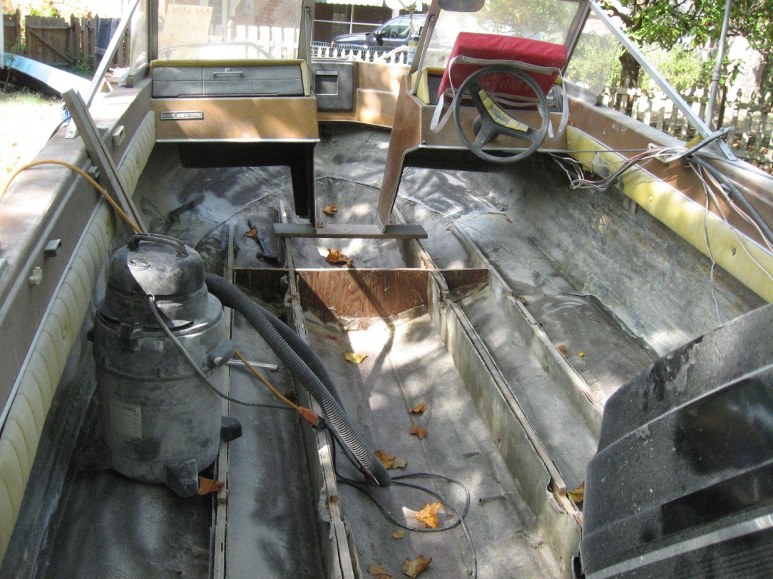

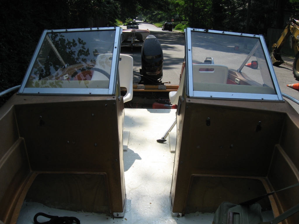

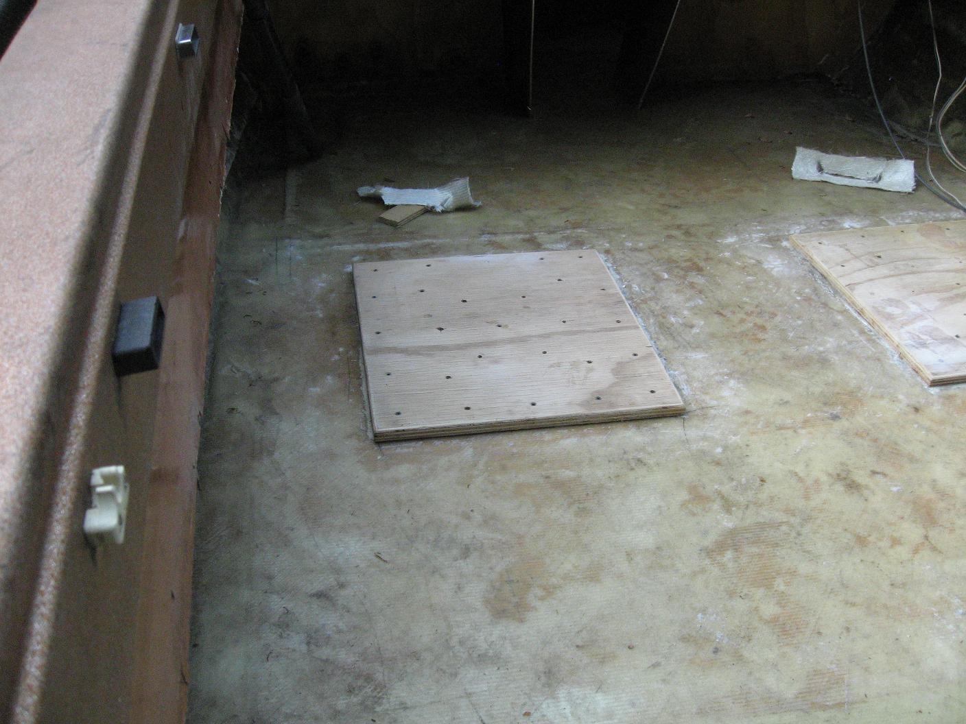

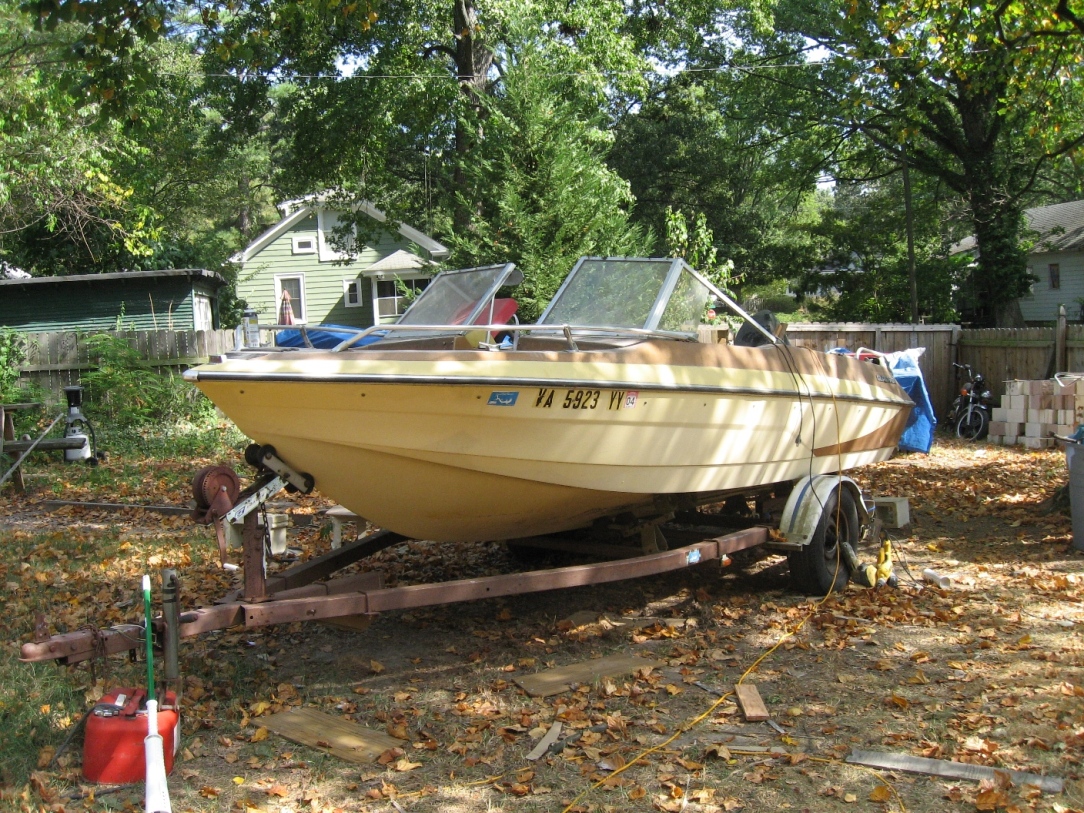

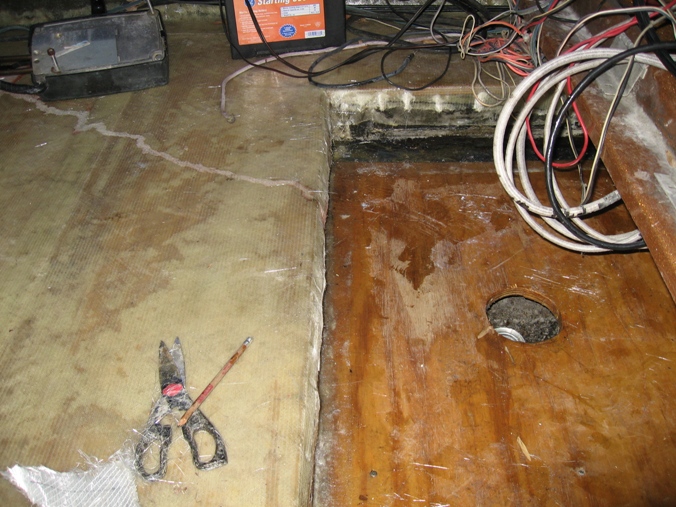

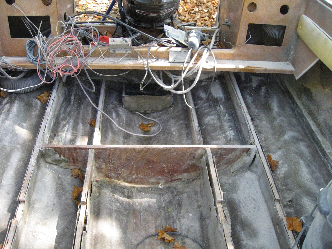

I had picked up this Glastron about 5 years ago and just this summer have found some time to work on it. I got the title straight also and bought a $100 wiring harness to make sure that the engine ran before starting to work on the hull. The floor and stringers were shot.
Getting the rotten wood and grinding out the glass and removing pounds of marine foam flotation made me pause several times to think, "what have I gotten into"? I was especially concerned about the transom as I didn't want to have to redo that. But it seemed solid and I got started on it.

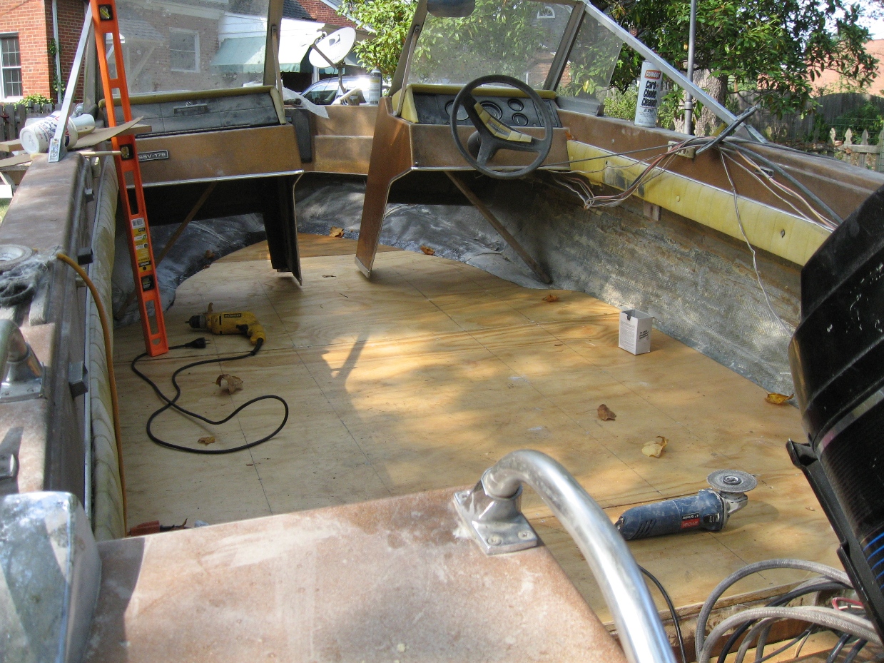

The stringers were solid wood, my guess is fir, encased in fiberglass. I didn't remove the entire fiberglass part, just cut the very top of the stringer off and was able to dig out each of 4 stringers while keeping the fiberglass 'form'. I measured and cut 3/4 inch AC ply, coated several times with fiberglass and reseated new stringers into the original forms.
These things really take time. I have got the new floor in as of this weekend and now have 2 layers of matte fiberglass cloth to finish it off with. I'm taking a 2 week break first...
Anyway, when it's done I'm naming it "$25 Boat". If anyone asks, I can tell them about the $800 (so far) in materials and 100 plus hours of labor I got for paying my $25.
By the way, the trailer is usable and I think the Merc 1400 will really run well.
I took a few pictures, hope you all enjoy.
Hello, World!!
Re:'79 Glastron SSV176, "The $25 Boat". 16 years 2 weeks ago #16624
Nice find Ken! I'm a little disappointed you've been holding out on us, not sharing your project. LOL Looks like you have the worst of it behind you, enjoy the break and keep us posted on your progress, okay!? (I've got the same project ahead of me with my 73 V178, but I think the G'trons are well worth the work. Mine's probably going to need the transom replaced too.) Lookin' good buddy.
Re:'79 Glastron SSV176, "The $25 Boat". 16 years 2 weeks ago #16635

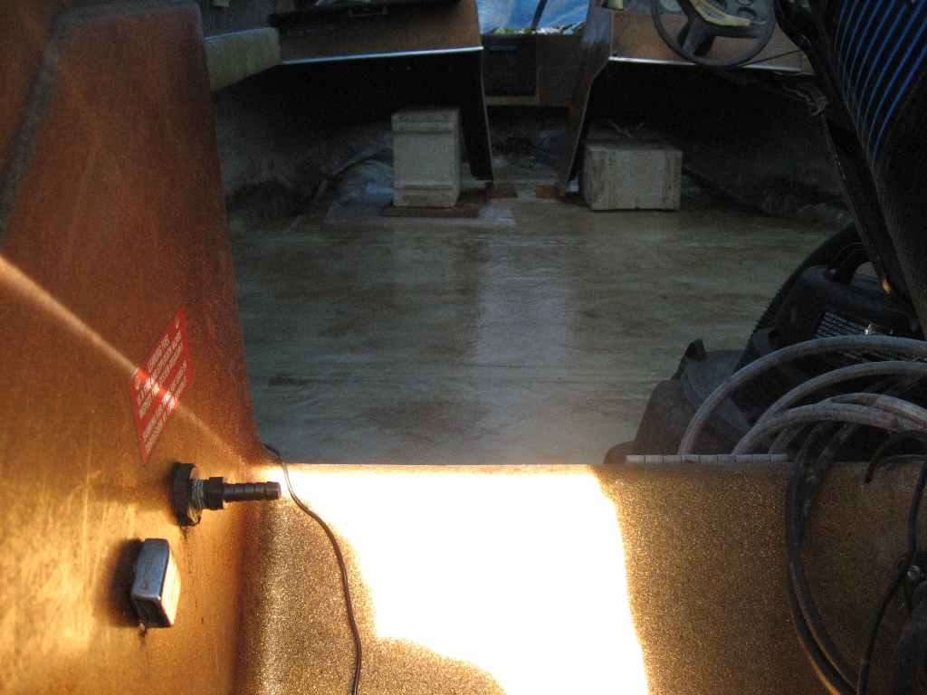

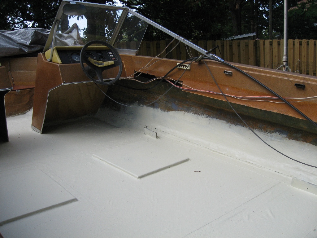

Ok, after a lapse in my posting duties, I am back on it.
Since last update I covered the wooden 5/8 " floor with 2 layers of thick fg cloth.
Alot of various finishing work...
Today I'm recoating the floor with final fg coat that has WAX in it to make it non sticky.
Next will be a 2 part epoxy primer followed by Awlgrip with antiskid.
(Floor is covered to keep the leaves from falling on it and sticking while drying)
Hello, World!!

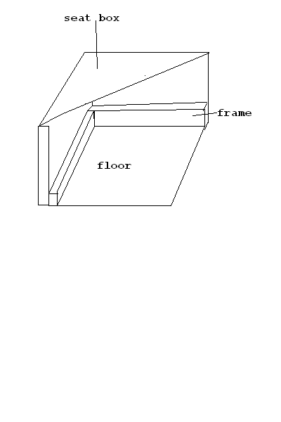

My thought on seats has ranged from pedestal to back to back to a set of singles. Here are some ideas:
1. Pedestal: I don't like the idea of that much pressure or force concentrated in a small area. The floor is solid glass now and putting holes in it doesn't appeal to me. However, I like the idea of having alot of floor space.
2. Back to back: certainly the easiest option as this was what was there origonally. However, they use alot of floor space.
3. Single seats: if I do this, I could build a "box" on the deck large enough to put the seat on. So the attachment bolts would not go through the floor. This would distribute the weight more evenly on the floor. And if the seat needed replaced, the top of the box could be accessed by a deck plate for example. There would be a bit of storage inside that box also through the deck plate.
How would the "box" attach to the deck? If the box is 20 x 20, for example, I'd attach a smaller 2 x 4 inch smaller frame that the box would fit over to the deck. I can enclose that frame with glass for strength and waterproof.

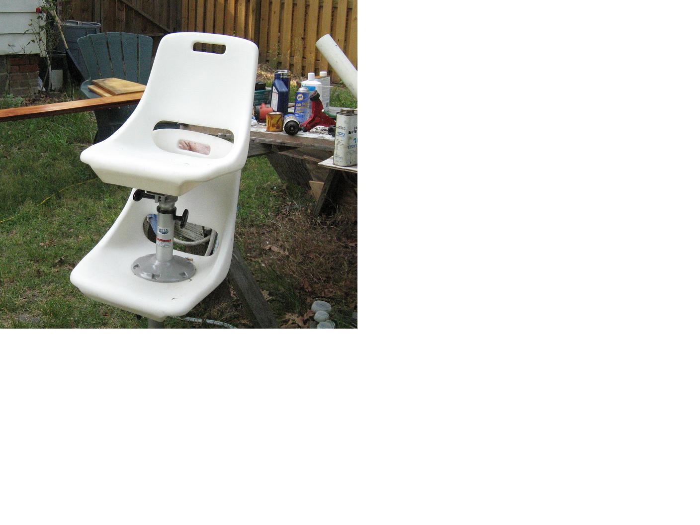

I broke down and bought some pedestals from West Marine:
.westmarine.com/webapp/wcs/stores/servlet/ProductDisplay?productId=18863&catalogId=10001&langId=-1&storeId=11151&storeNum=10118&subdeptNum=10822&classNum=10825
Making the bases was going to be iffy: I actually tried to do a dovetail joint and realized after a few hours that it wasn't worth it.
The bases fit perfectly to the seats plus I got them for less as you can take an Internet ad in to WM and they'll match the price! It was about $55 each.
So, to mount the pedestals, I made 2 18 x 20 inch 5/8 ply bases and put some T nuts in them. Then I used fiberglass to mate them to the floor (should have used epoxy), but then put some deck screws (the ones that don't corrode) and am going to epoxy 2 layers of fg cloth over.
I promise pictures today!

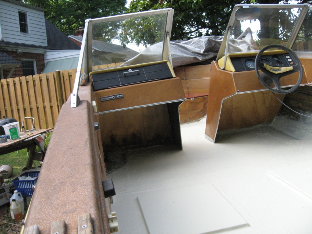

Some updated pictures. Primer
more primer Gunzite primer
