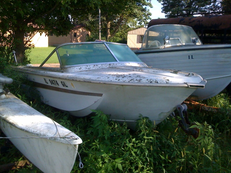

I read one needs to be careful with old fiber glassic boats that have been in the weather...
I found an old HydroVee which I think is just kool but transom is VERY gone along with interior...wondering what it takes to bring that old fiberglass back to life....
Matt in Illinois

I'm no expert - still working on my first restore. (Rinkerbuilt Project)
It's a lot of work, but that one looks like it would be worth the effort.
Use the Mr Clean pads to clean that surface dirt & mold. You will be amazed how quickly it comes off without damaging the gel coat.
You will need a place where you can lift the cap (unless you want to jury-rig it like I have to), and then tear out all of the wood. Stringers will most likely require repair or replacement, but you won't really know until you remove the flooring.
Can't really see from the photos - what shape is the hull and cap in? You will probably have a 3/8" skin on that old guy - easier to work with than thinner skins on newer boats. Mine is, at least.
I tap the knowledge and experience of the guys on iboats.com for a lot of what I am doing on my boat. They've saved me enormous amounts of time and money - because I would have done everything to this point ass-backwards had I been on my own.
Oh, a great book to use as a guide is Runabout Restoration. Found it on Amazon.com Some of the info re: glass work is a bit out of date, but really a terrific resource to have at hand. Well written and funny, to boot.
Good luck with this project!

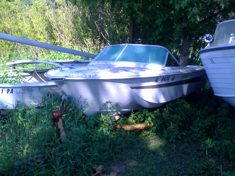

I removed the motor and cotrols off this one...I looked at it last year but the owner was crazy on price.....now they are wanting them gone and talking about scraping out the trailer and well Burning the hull to get ride of it....
There are two hole on top of bow area horn and radio antenea...I removed the horn already.....
Looks like where the winch straps hooks up too there was some damage there too....what I read on these Chrysler boats were they were one of the first boats manufactures to used FOAM in the hull...so guessing the inside the hul is junk....last stickered I think in '98.....
Anymore feedback or positive thoughts (or negative) please post'em..
Matt in Illinois

You won't know what you're dealing with until you get the cap off and remove the floor. As far as the hull ... there can only be so much foam, and the rest is glass. Glass can be repaired. Look at the project as one step at a time. Appraise one step at a time. Look at my boat ... mine is well worth it to me. Doesn't matter to me what I wind up having to do - it will be worth it to me.
I think you have a great project - you have to decide what it's worth to you in terms of effort and expense, but you could well wind up with a terrific 'new' boat at less cost than a 'new' boat. That's how I look at mine.
I am moving very slowly and carefully with my project boat. Mine will be new when I'm finished, and exactly what I want in a boat. I will also know exactly what's in it and where it is. For the next 20+ years. Can't put a price tag on that in my world.
I'm having a ball with mine. Look to the positives & enjoy the pride you'll get from working this boat back to life.
I, too, wish I were closer.

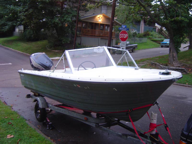

Windshield looks a little hazy, but other than that jump in.
Mine was $650 and I am now at about $6500 spent in 5 years.
We are on the second season of use.
It is a really fun project, just finish it if you start it.
