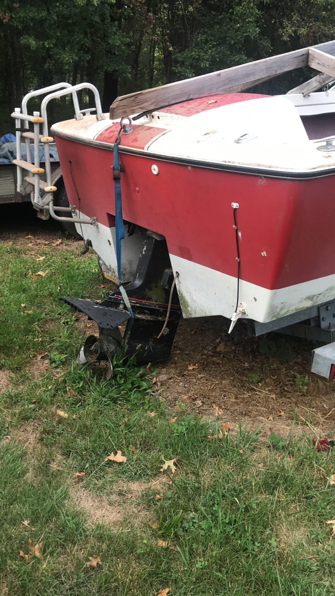

1971 Lancer Outboard 4 years 5 days ago #147352

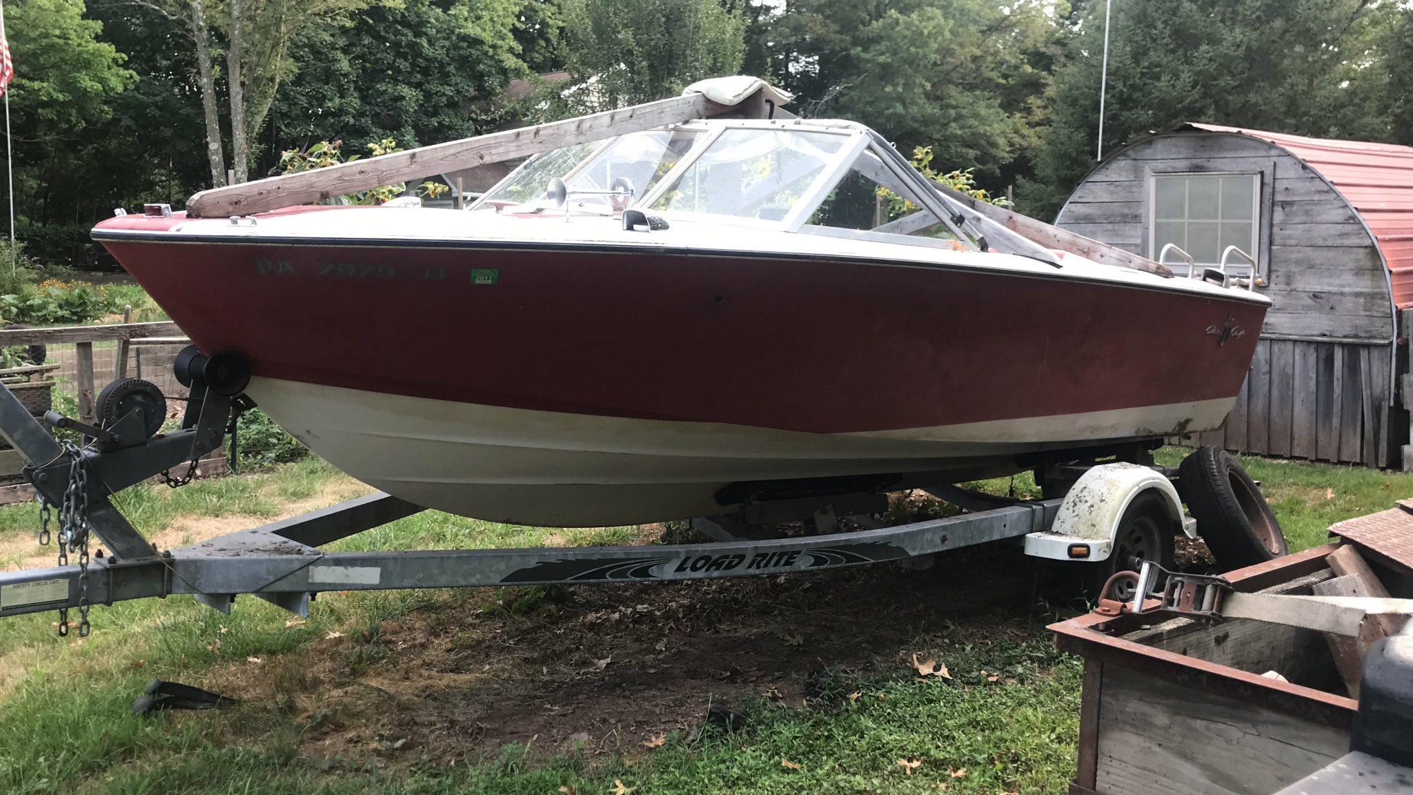

I found this pic of what it looked like all red.
Those gray seats are not so good looking. The originals were on 8" bases.

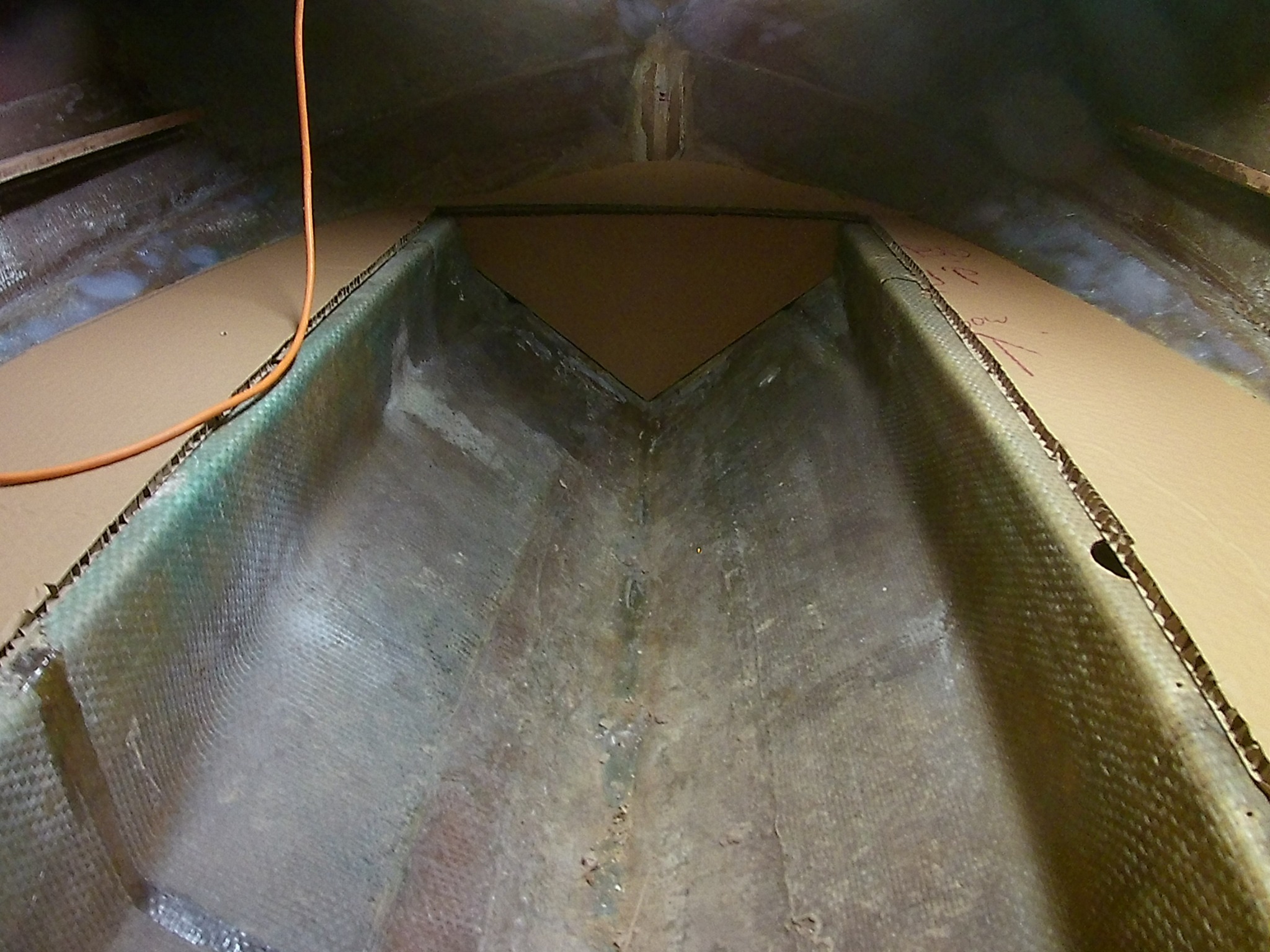

Even though it has been pretty cold, I continue to make progress. I have the entire thing stripped down to the hull and the deck cap. I separated the halves and filled in all the bolt holes so that it is not swiss cheese anymore.

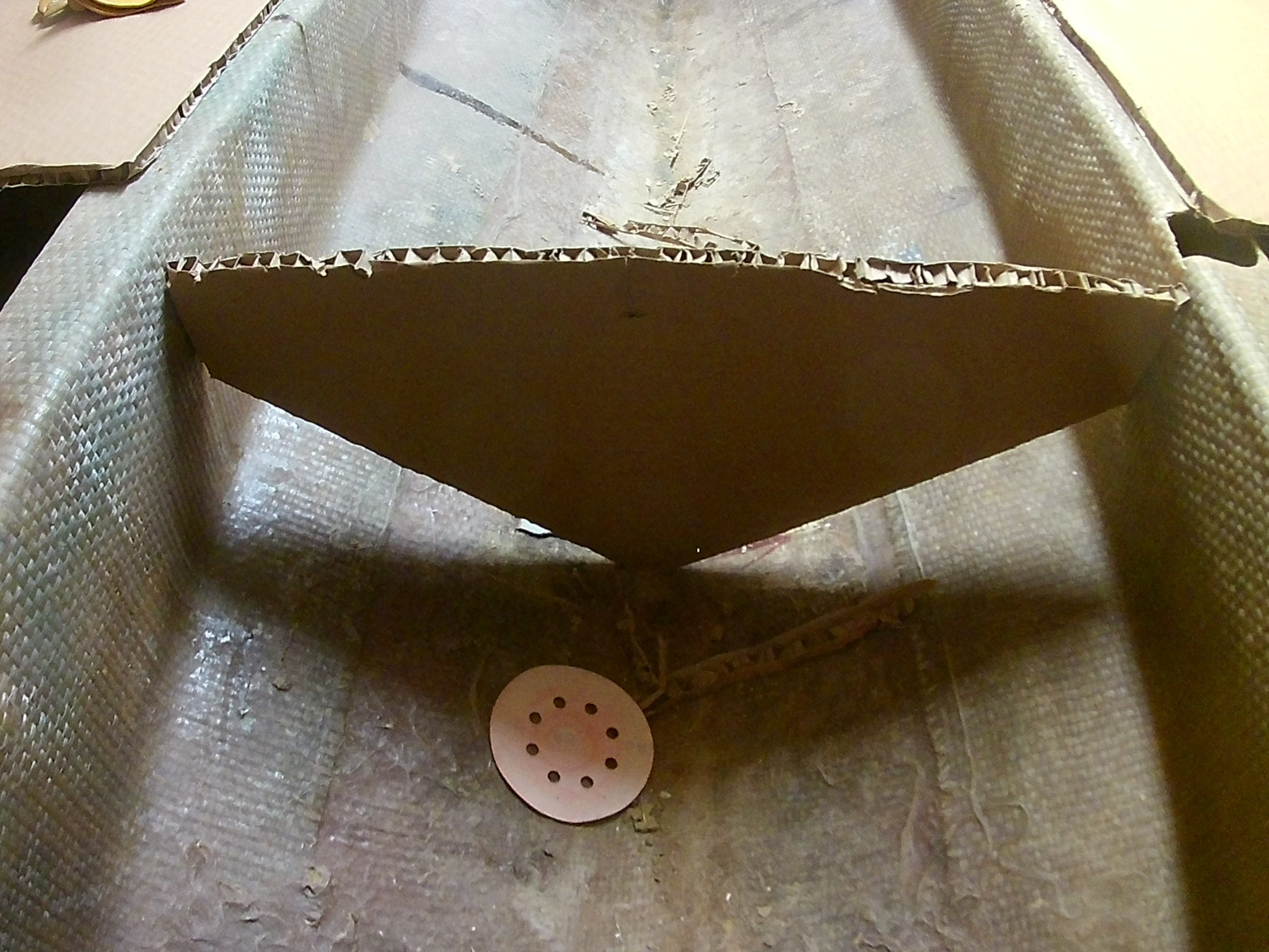

The plywood that was used to form the stringers was soaked and rotten and the stringers were filled with flotation foam so getting all that out of there has been a huge pain but there is so much other work to do that it can still be start/stop efforts. I am making templates for the new deck and bulkheads for the ends of the fuel tank area. There was a crack between the holes where the bow eye was mounted and that needs more grinding. I found a fab shop to replicate the lifting ring attachment bracket out of stainless to replace the original. It lost about 1/2 it's thickness to rust where it laid up against the wood puttied into he bow to bolt it to. The hull appears to be pretty solid and no major damage repairs are visible. There were some bubbles and some poor layup of the glass in a few places that I ground all the way out and filled with TotalBoat polyester structural repair putty. I like that product for this purpose.

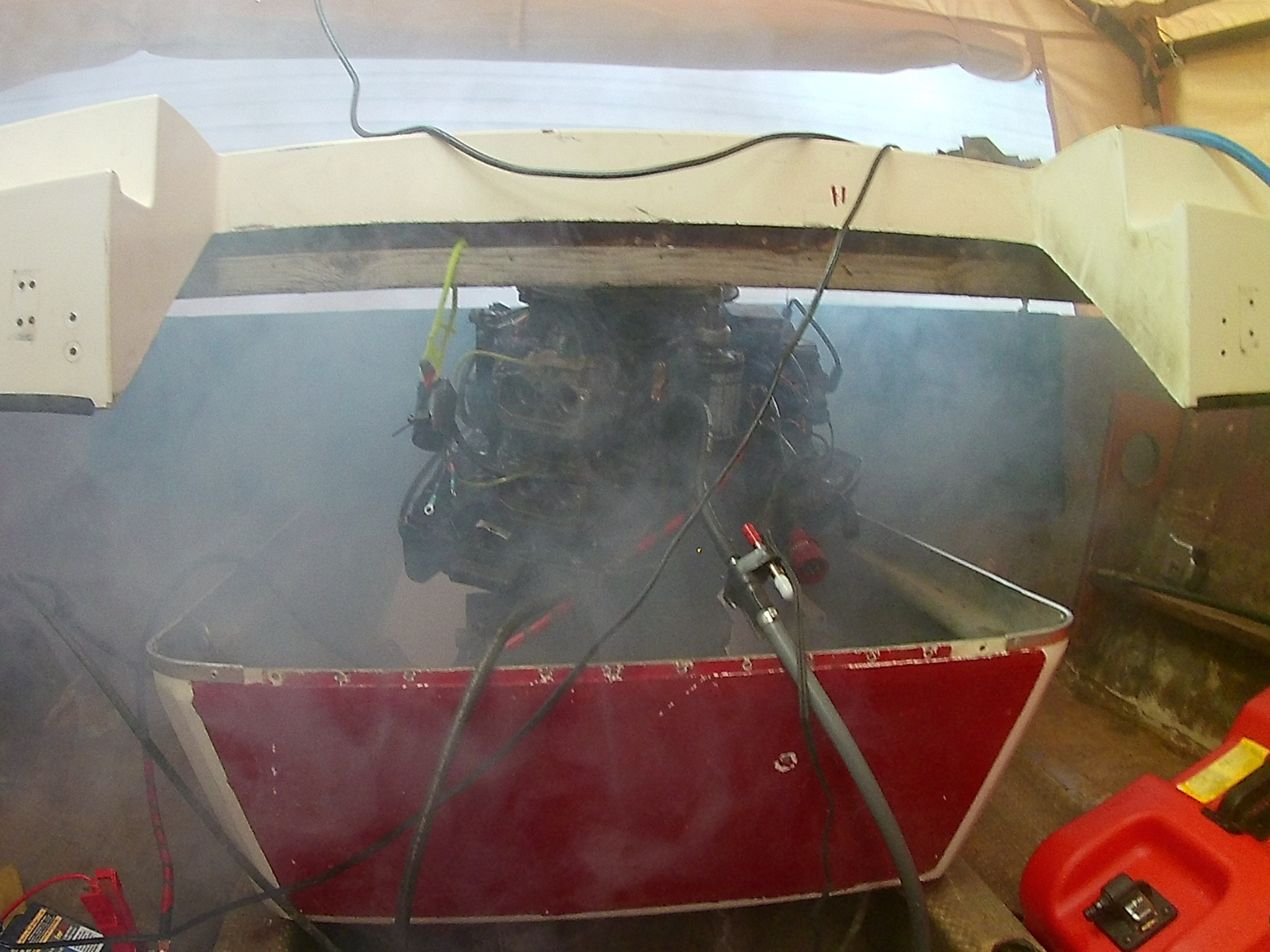

The fates were kind to me and the motor started. That is a huge plus now I can take it off and know that it at least runs. Once I get that off there, I can finish cutting out that doghouse and the wood original plywood decking underneath gone.
This photo about sums it up well.

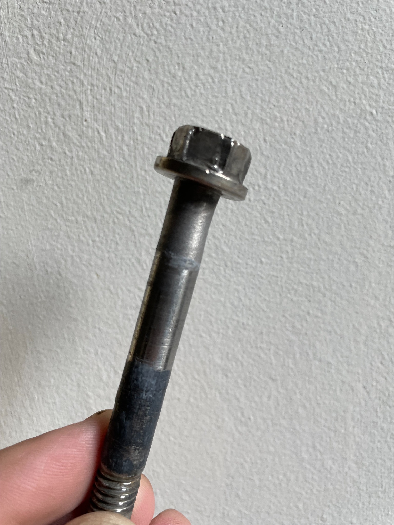

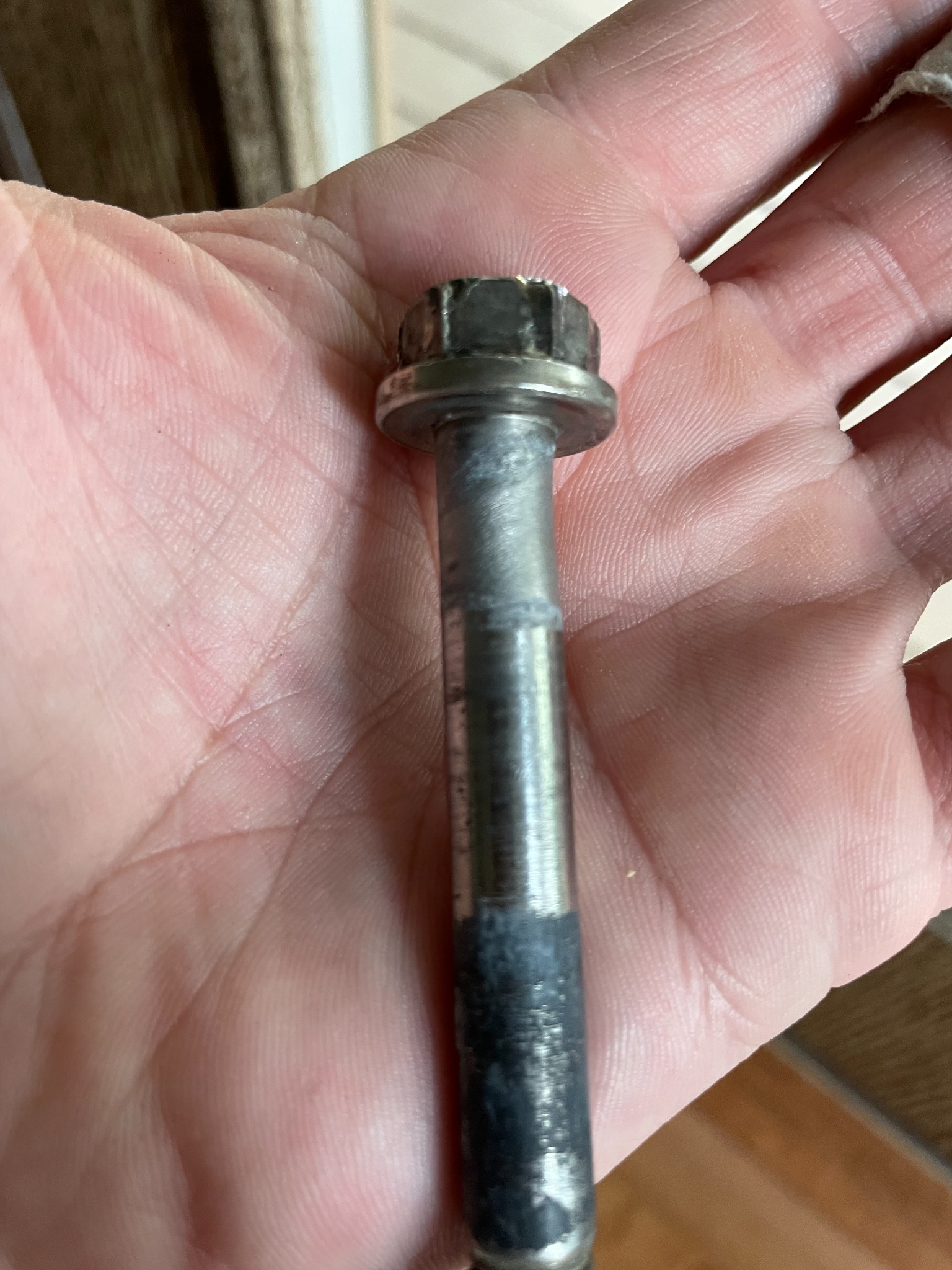

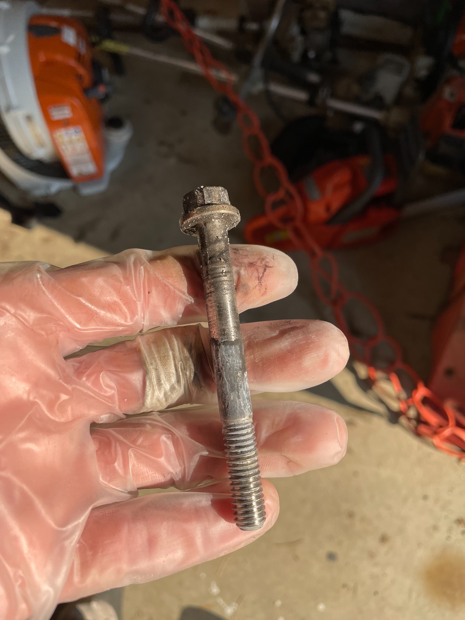

Not entirely boat related but the engine. The centermost bolt holding the gear housing to the exhaust shaft was epic stuck. It turns out that the body of the bolt where it passed thru essentially a sleeve of teh aluminum was mechanically corroded into place. It took quite a lot of time and effort to get it to even move and when I finally did get it out without breaking anything, it is clear the bolt twisted a lot but did not fail. That was impressive.
