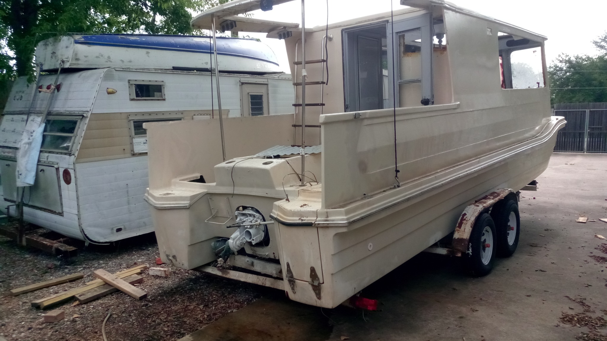

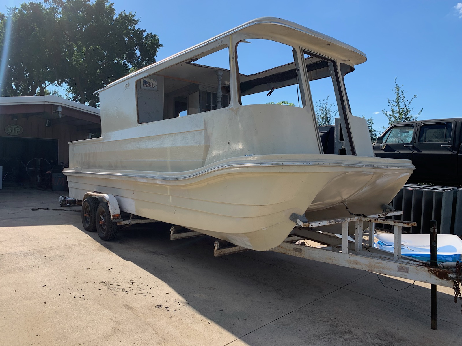

Hello and thank you for the add to FiberGlassics. Im looking for some help to identify this boat. It has a OMC 190 electric outdrive with a ford 289. I am trying to get in touch with the previous owner but he is old and not very responsive. The hull is a catamaran style and appears to have been factory produced from some type of mold. Please help me identify the boat and where any hull ID number may be located. It is not in the right rear corner where most boats have the number engraved.

Welcome. That is a nice looking hull and should be pretty stable with the twin hull. Someone here likely will be able to help you with your questions. I believe it was about 1972 when hull ID numbers were required to be stamped into the hull starboard side on outer transom. Who knows if there might be a hull tag screwed or riveted in somewhere. On this website I have seen random tags show up in lots of different places. Good luck with your project. Someone likely will identify the boat and maybe even direct you to the library in case their may be good information there to help you.

With that Omc stringer drive I suspect late 60's. As the Dr. said probably no stamped in ID. Wondering if you looked real closely at the helm area or maybe in the bath area might be some type of label for the builder. The Ford 289 is a strong runner, later upped to the 302. I had the 289 in my '67 Ford XL and the 302 came out in '69. Slap a couple Cleveland 351 heads and you have yourself a Boss 302.
Sorry couldn't name the boat but at least you now have a year to work with.

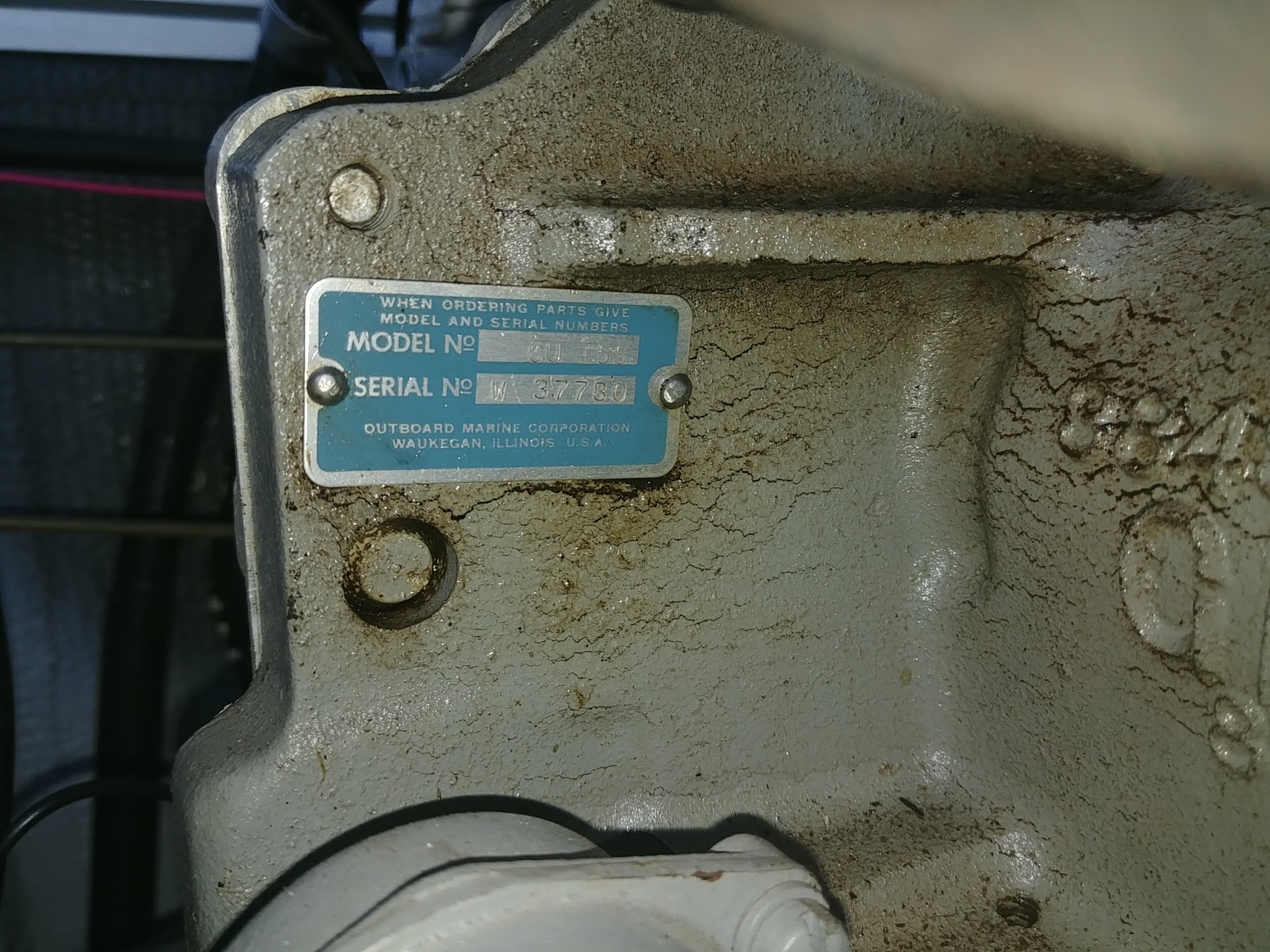

I was able to find the OMC outdrive model 990220R. The tag is on the upper part of the outdrive inside the boat on the top of the bellhousing. According to the model info the outdrive is an OMC Electric shift 1974 model. It looks like the motor has been rebuilt so im hoping I dont have to do much more than just get the outdrive back in order before we can take it for a test ride. Holley makes a nice supercharger kit for the 289. Its expensive but then we could really have some fun.

That model # is a 1974 190 HP 302. I don't see where they ever used a 289.

I think someone changed the block or maybe just rebuilt it. I was told that a 3 bolt crank pulley is a 289 and a 4 bolt is a 302. But i could be wrong
Please help me identify this 24' 1970's houseboat 6 years 3 months ago #142935
I don't know about that but if it has the OMC data plate riveted on then it it probably the original 302.
Here is the data plate on my 120. I live & breath electric shift OMC I /O's

I believe the boat is a land and sea camper model.
