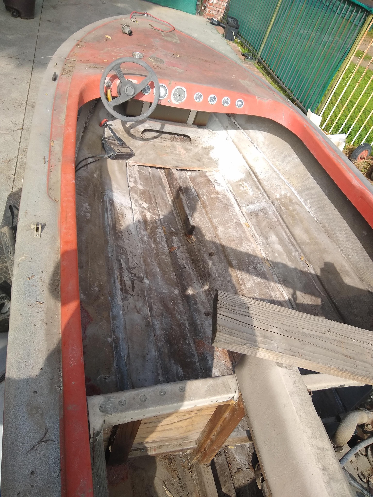

My name is John, new guy here hoping that I can contribute learn from everyone here. I have a mid to late 70's tahiti and I'm hoping someone can shed some light on what model it might be? I did an engine search and it looks like it was manufactured in '77 but not positive. My plan right now is to replace the floorboard, do an engine overhaul (roommate is a boat mechanic), and put new sets into it. Maybe paint if I'm feeling up to that challenge. My dad left me this boat and I don't know too much about it, so any info anyone can provide would be huge. Thanks all glad to join you and I'll post pictures along the way of this rebuild!

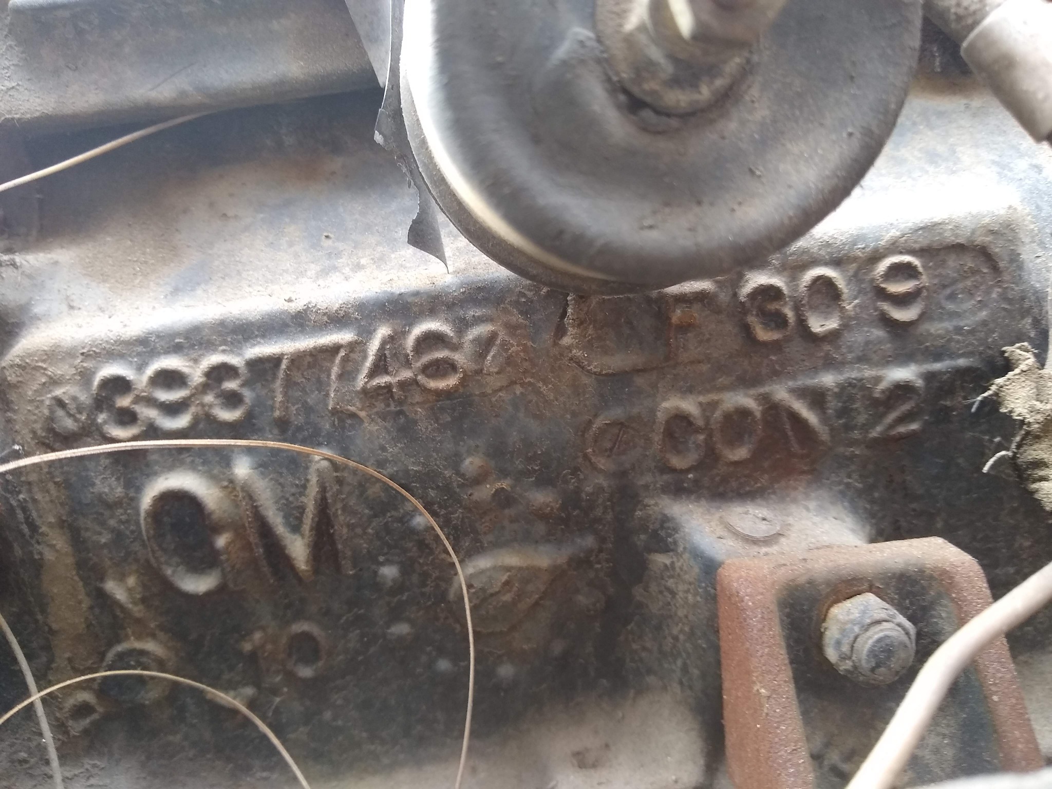

All the DMV needs is your Dad's Info on a bill of sale and the CF number. You may need to take it the DMV. The boat that I am restoring they did not have a record of it and I just had the fill out new affidavit. boat had not been registered for 27 years. $120.00 boat and trailer. Get the block number on engine run it that will get you close to the year of the boat.

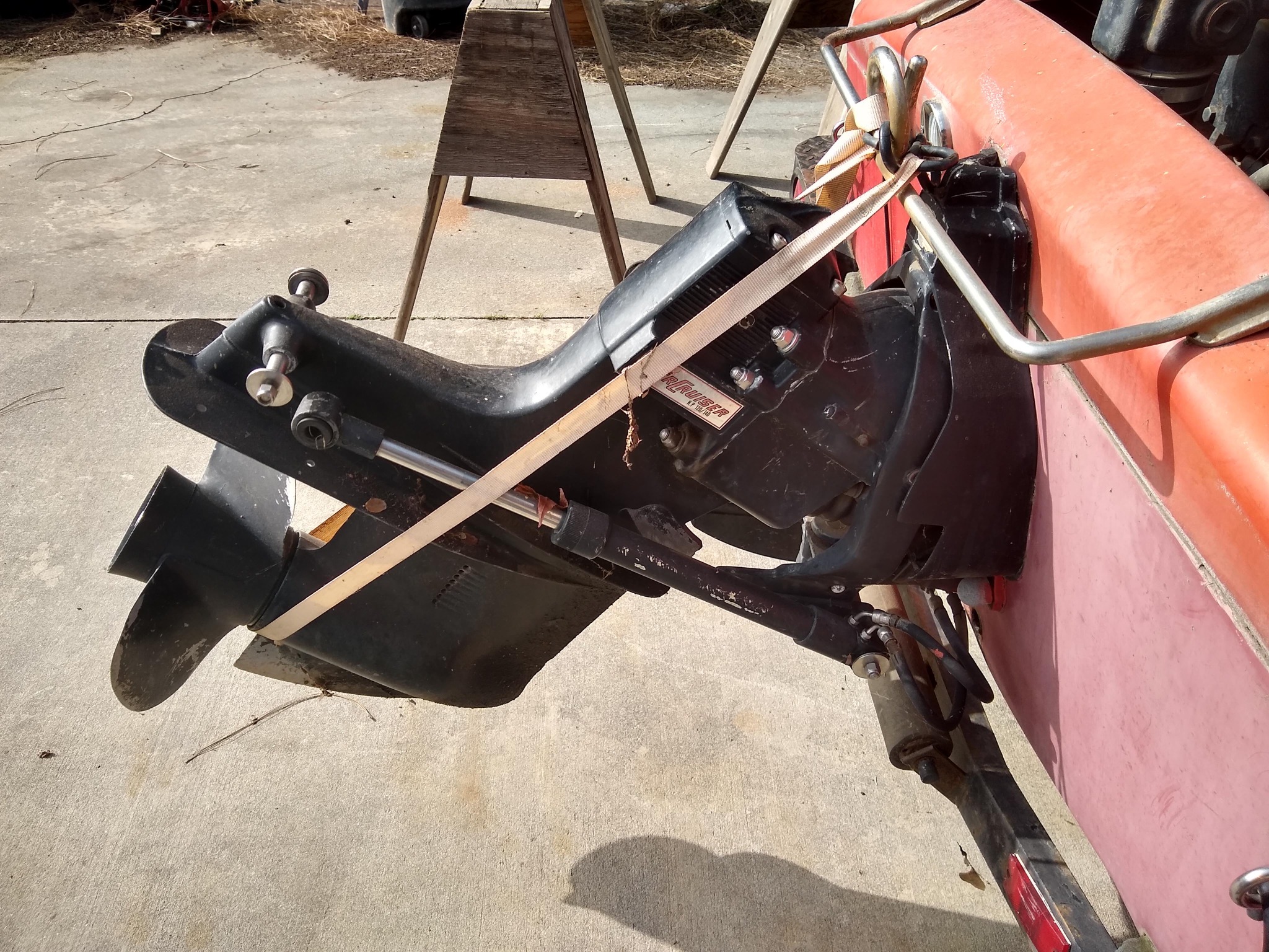

Your outdrive is a pre-Alpha. You might consider changing to an Alpha One...a much better outdrive and a lot easier to find parts for.

I probably have all the parts you would ever need: outdrives, gimbals, bellhousings, manifolds, etc. What engine do you have? Your engine will determine the gear ratio of the outdrive.

It's a 4 cyl 120/140. I can see that from one picture where I can see the cooling hose. So 1.98 ratio. That #1 drive will last forever, no need to just install an Alpha. I can also tell that is 1970 or newer as the trim lines come out the bottom of the transom plate. I'd guess mid 70's.

welcome. Your outdrive is the same as on my 72 Sea Ray. It's a Pre-Alpha. Mercruiser called it a MC-1. Parts are readily available, but people who know how to work on them are not. If you don't want to do the work yourself, ask around the various shops for someone who works on old outdrive packages.

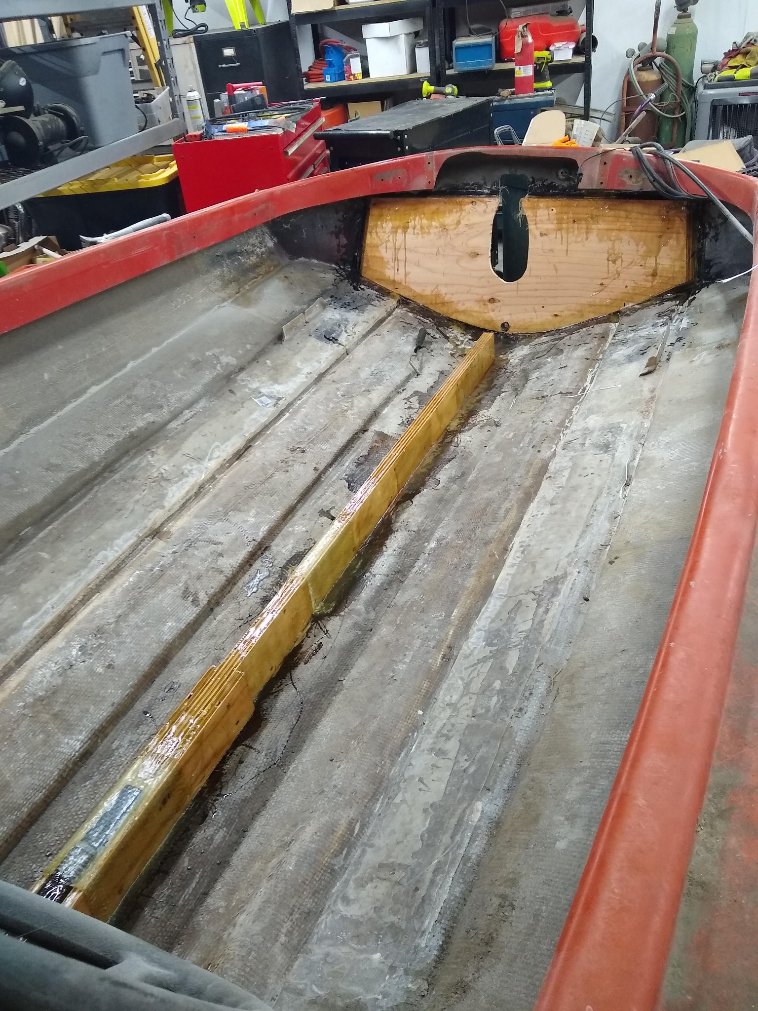

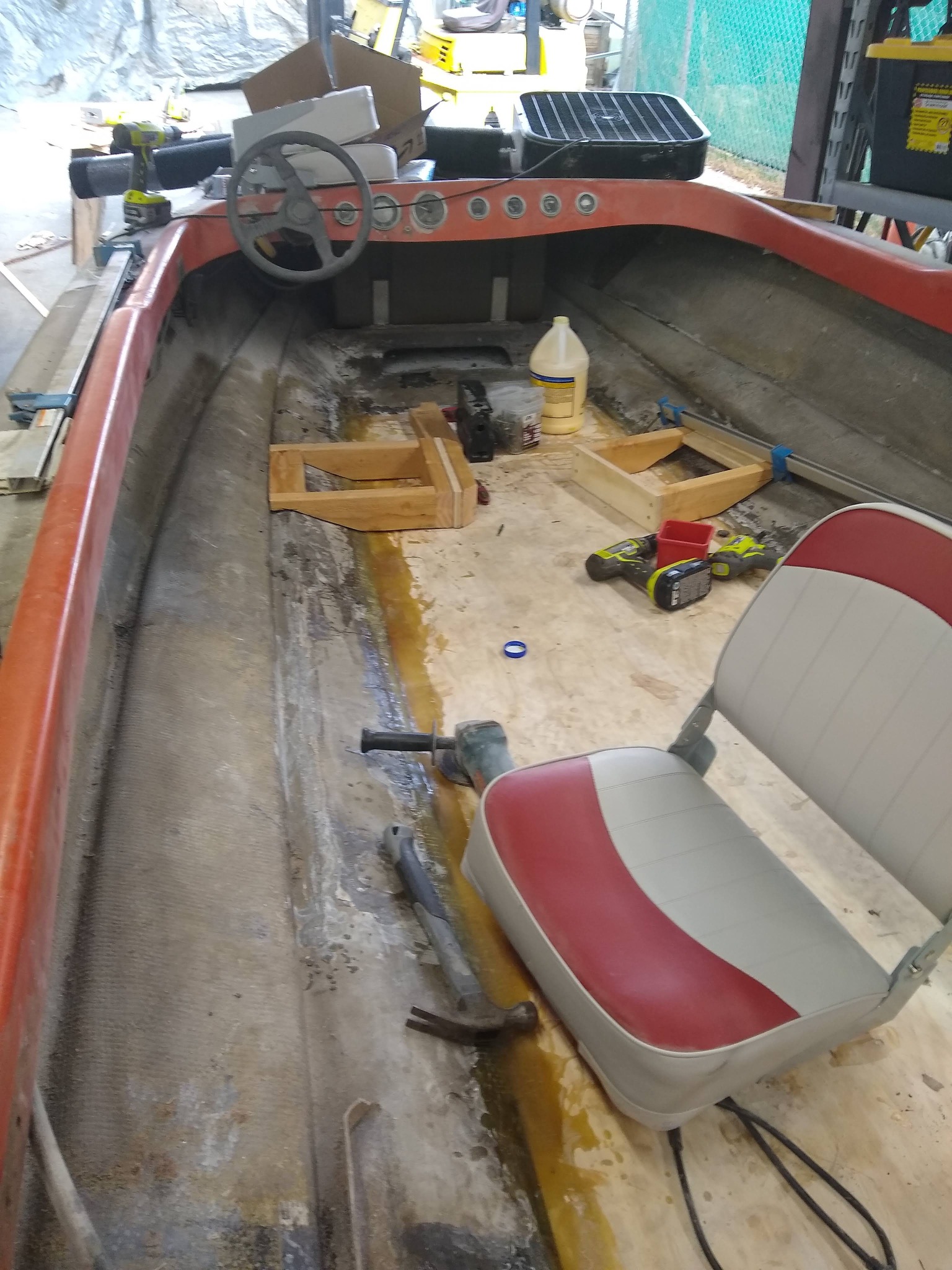

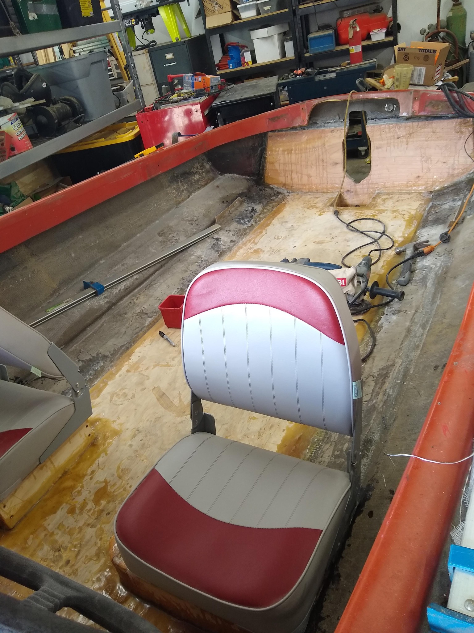

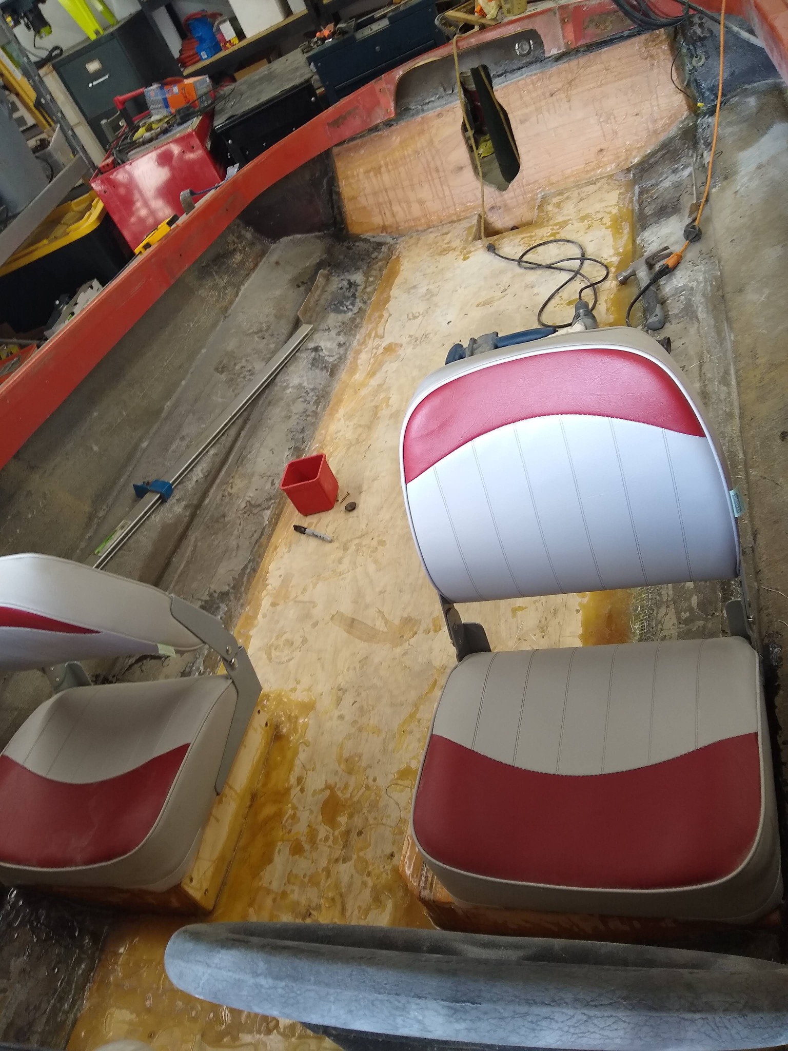

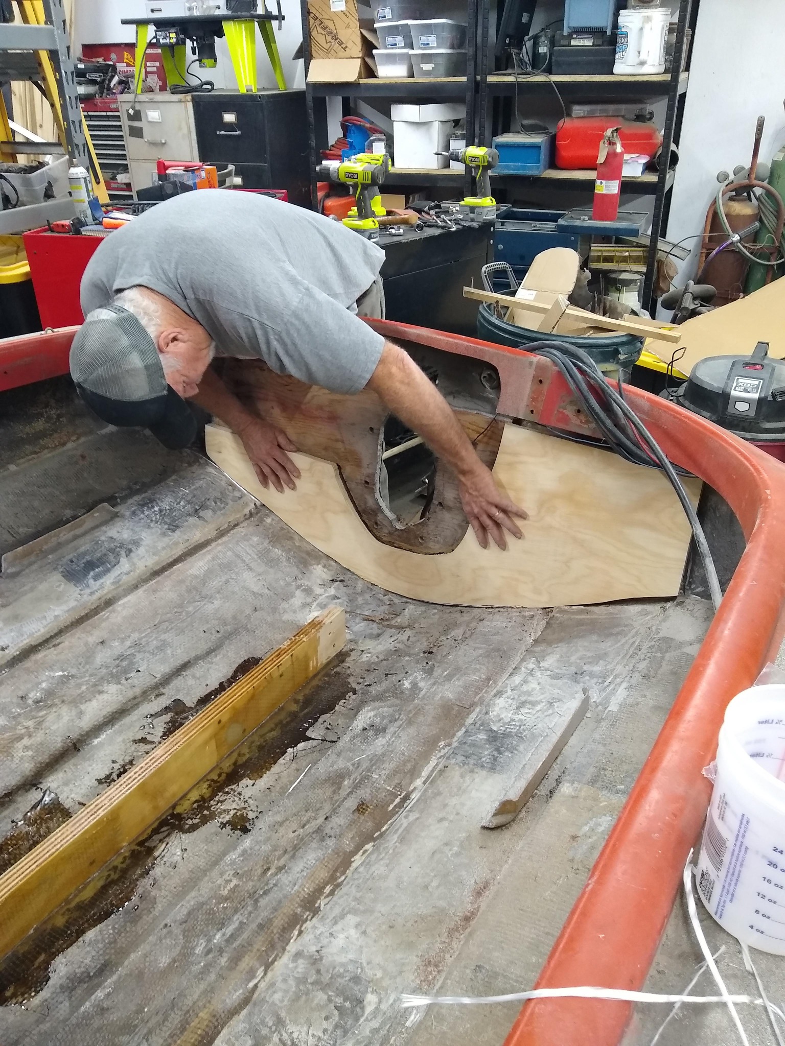

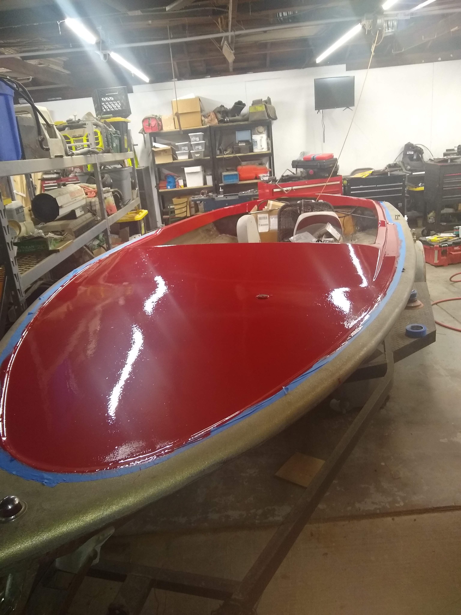

New Member - New boat! 6 years 1 week ago #142619

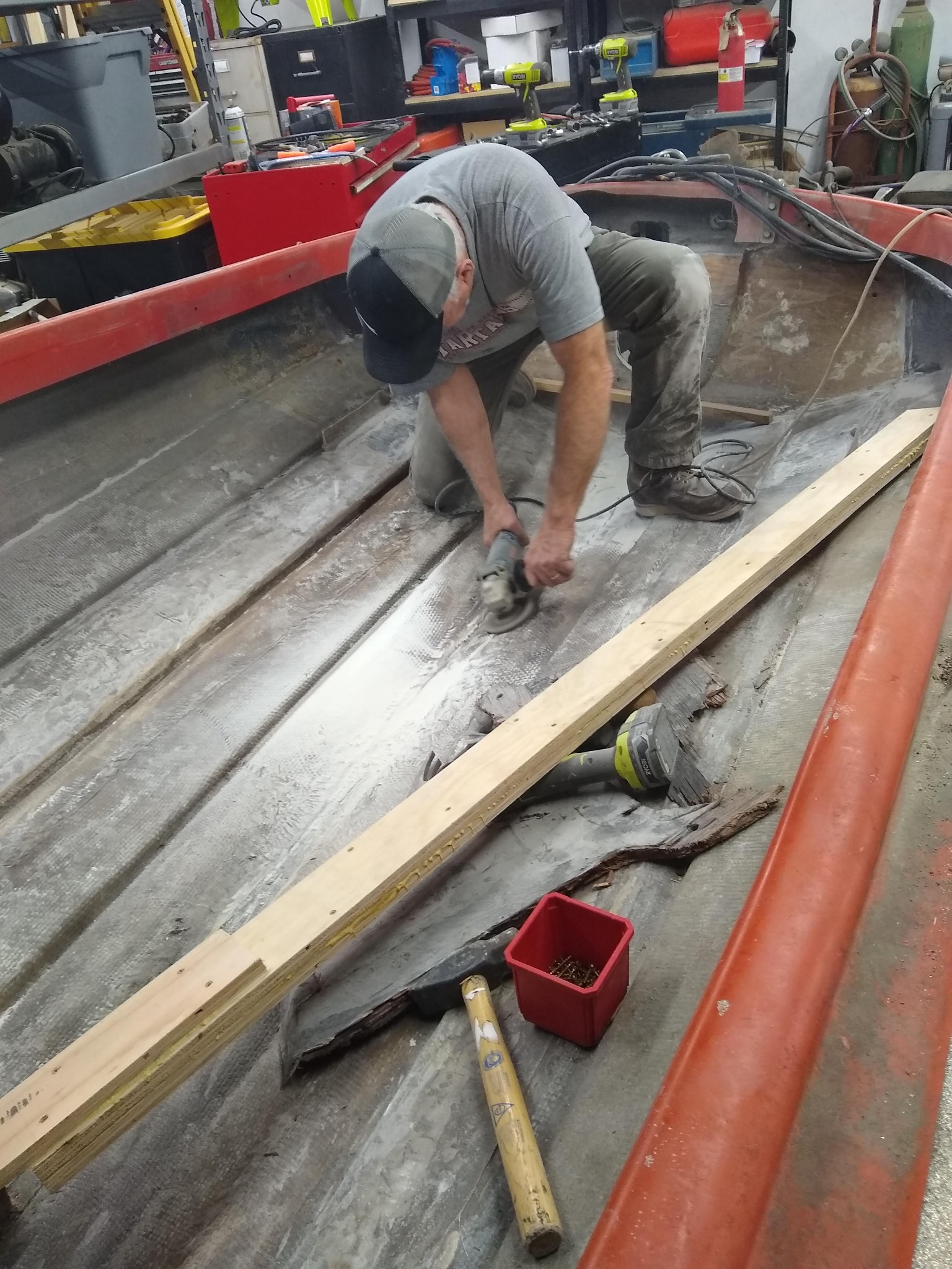

So a little bit of an update. Progress has come along nicely, we took out the engine and outdrive, my roommate is a boat mechanic so he is doing the maintenance on the outdrive and I'm handling the engine. My dad was in town for a bit and he helped me replace the stringer, floor, and transom wood. We fiberglassed it all in place and it feels much more solid. I then painted the topside to cover up some old spots where the fiberglass underneath was showing through. Sorry if the images are huge, not sure how to make them smaller on here!
New Member - New boat! 6 years 1 week ago #142621
Sweet! A labor of love no doubt. Glad to see the pics. Thanks.
