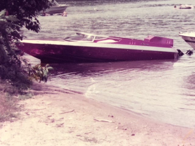

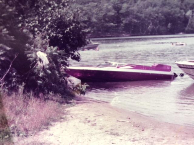

here are 2 pictures of friends sidewinder from the late 1970s. Notice the tall motor hatch. It was a 4 cylinder with MerCruiser outdrive, BUT it had a Turbo added. It would run over 60. I drove it once and saw the speed for myself. Rode in it many times and skied behind it. Maybe you could find someone with the right sized turbo for a crazy good price. I know nothing about them. I just wanted to share another thought to keep weight down. The extra power allowed for more speed without too much trim so you could avoid chine walking like some of the high powered outboard sidewinders that would trim out to crazy chine walking. My memory is fading... maybe this was one of the splashed copies of the sidewinder.

Thanks, kinda interesting. Do you know if he made that engine hatch? The side looks like it has the same molded shapes that the hull has, but yet the engine hatches I have seen were more shapely.
Mine is completely missing so I have to build something up.Thought about using foam boards to glue together and shape and nice form to glass over but I've been told they use polyurethane foam board for glassing over, it's expensive from what I've found. Great for saving weight but harder on my wallet than I want lol.

That turbo charged boat was bought used, so don’t know about engine hatch. I thought I remember them saying previous owner custom made it. With the notches and perfect color match, they did a great job. Maybe a boat repair shop or even perhaps a body shop that did fiberglass corvette work. That boat was a cool sleeper. Hard to tell from the old picture, but it was purple metal flake with a silver metal flake stripe.

Dr.Go! wrote: That turbo charged boat was bought used, so don’t know about engine hatch. I thought I remember them saying previous owner custom made it. With the notches and perfect color match, they did a great job. Maybe a boat repair shop or even perhaps a body shop that did fiberglass corvette work. That boat was a cool sleeper. Hard to tell from the old picture, but it was purple metal flake with a silver metal flake stripe.
Makes sense being the shape of that hatch. Was a nice touch with the notches. Purple could be cool, like the Plumb Crazy Purple that Mopar used back in the day of cool cars! My Sidewinder has been repainted at some point, and not a very good job. A lot of it is peeling so I don't think proper prep was done on the primer before they sprayed the color coat. No biggie. I have a Binks Model 5 spray gun that I've used quite a bit so I'll repaint it. I kinda like the metal flake too.

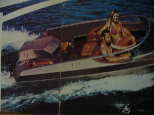

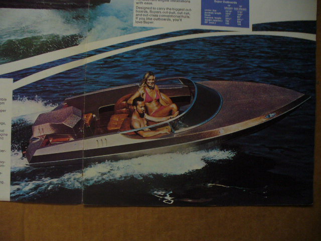

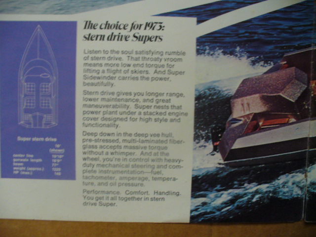

Hi,
My family was a Sidewinder dealership from 1970 to 1974. After Thompson bought Sidewinder (Sidewinder amassed huge legal bills for legal suits again it's patented design - the Sidewinder Super 16 Outboard was the most copied patented boat design ever), it is my remembrance that Thompson switched to upholstery over wood motor boxes (as they did for their other boats), so that is likely why yours is missing along with the rest of the interior. The purple and silver boat, in my opinion, shows a factory stock fiberglass motor box. I have added three pictures from our 1973 Sidewinder brochure of the 16' Stern Stern Drive. There was an aftermarket turbo charger kit back in the day for the Mercruiser 140. The Mercruiser 470 was not introduced until the 1976 year model (we were a Mercruiser dealer from 1962 to 2003). I am not aware of a turbo kit for it however.

Well that cover looks like it. And I do believe they had the 140. Sorry I wasn’t paying attention to that detail. The Dad did remove the name put on the boat... Purple Haze... I kind of liked it, but I was 16 and he was 55... still made him an instant cool Dad in our eyes... was a big step from an Evinrude sweet 16 in grey with about 90hp. Thanks for those dealer brochures.

Thanks, Joe. Those picture do look like the ones Dr Go put up. Guess I'm going to have to find Thompson specific literature or pictures. I did find a couple Thompson Sidewinder pictures, one was a jet so not relevant here, the other was an I/O w/120 but it was a 1984 and the deck was different than mine. I may have to get creative and built something to suit lol. I really don't like the lines of the '73 engine hatch anyway lol.
That's interesting that a turbo kit was offered back then, turbos really haven't gotten any popularity until fairly recently. to offer them back then seems like some pretty gutsy thinking. I like it.

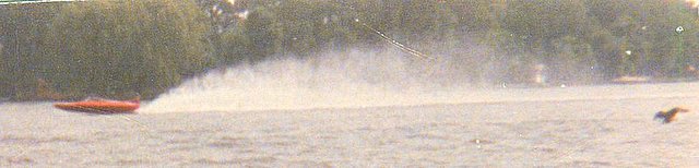

Friend mine had one with a 460/Berkeley jet. Raced him one time with 4 people both boats. My Switzer/XS Merc had him top end easy. I lay off the foot, and he shoots in front and with JetOVater up. I saw it coming like a fire hose and a front seat "DUCK"! The two back didn't duck as never saw it coming! Too much fun in the crazy 70's.
But I got back at him when HE wasn't looking!

Crazy side thought. I am not sure if your 3.0 or 4.3 will give you 50mph, but I do know that one of those Land-n-Sea Torque Shift Props in the lower pitch will give great hole shot and acceleration. I/Os usually use the 26 pitch that starts at 11 pitch and adjusts variably to a maximum of 26 pitch. There are set back screws that will limit the maximum pitch several pitches. I run the 32” pitch that varies from 14” pitch out to 32. For me, my limit screws are set at 26. I can launch my 20 foot 1000 pound open bow with a stock 200 outboard. I will try to post a picture and also try to link a video. I see them on eBay here and there from 250-350 or 400. They sold for over a grand. I was saving 300 bucks in gas over a low pitch ski prop when pulling a lot of skiers... maybe 21 days on the water. It won’t push more top end than your hp would produce with the perfect prop, but the acceleration will smoke a standard speed prop. that picture is from an idle and not jumping any waves.

Here is the old video. It is low quality but should show you how 2 identical inboard/outboard boats perform side by side. The company is out of business, but someone bought remaining items and believe they are making some replacement internal parts. I just checked eBay and found 3 props when I searched for Torque Shift Prop. Look for the 26 stamping. I can read it on 2 of them, but can see the number on one. 2 have solid hubs and one has the rubber shock hub. At these low pitches, they don’t bang into gear too hard because they start very low pitch. Mine is a solid hub and been running almost 20 years.
