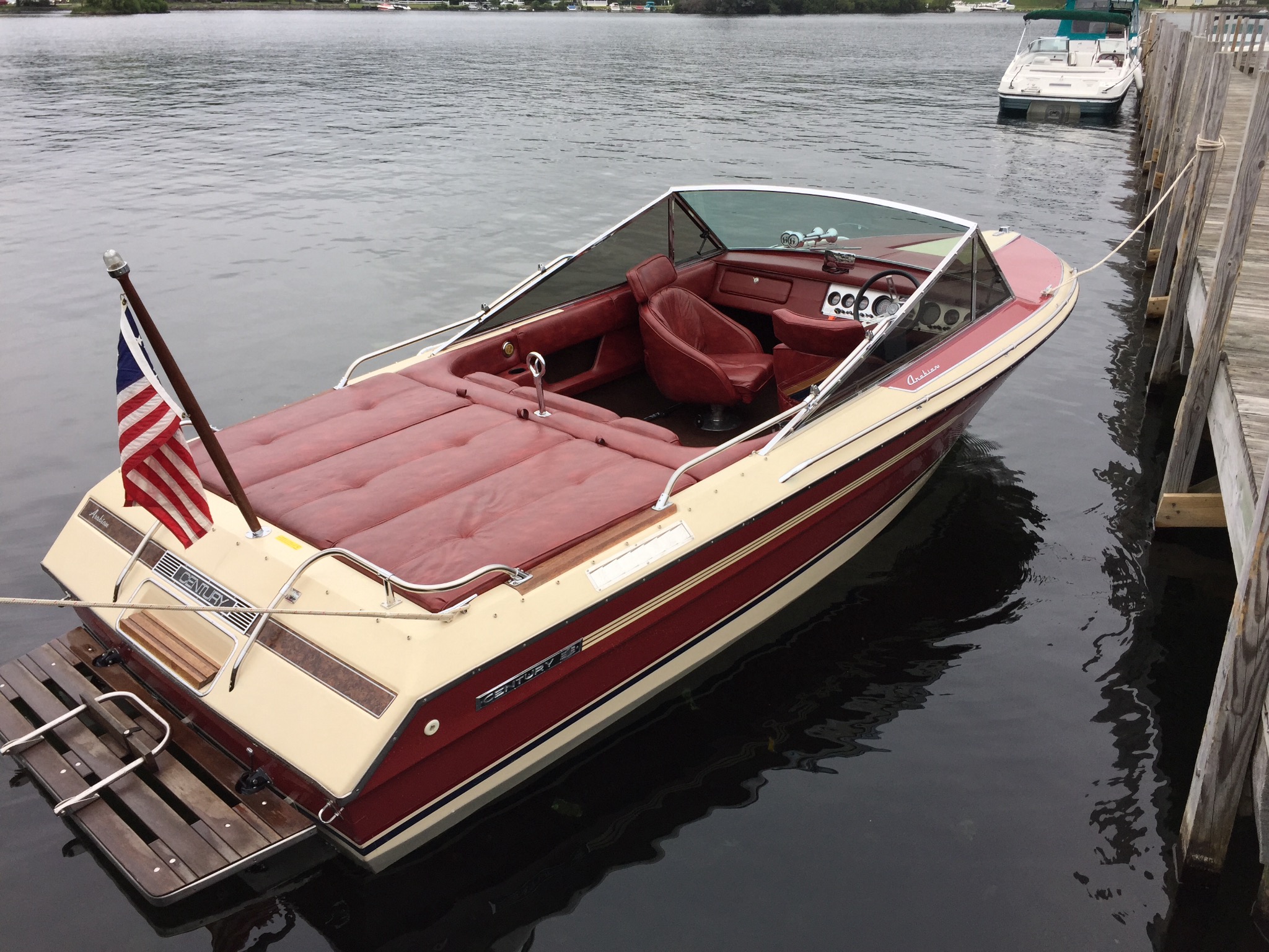

Oh here are a few pics of my Arabian I restored a few years back, still have it , one of my favorites even though at heart I am an outboard guy.
A garage queen that still had issues due to poor build quality, all 100% now!
