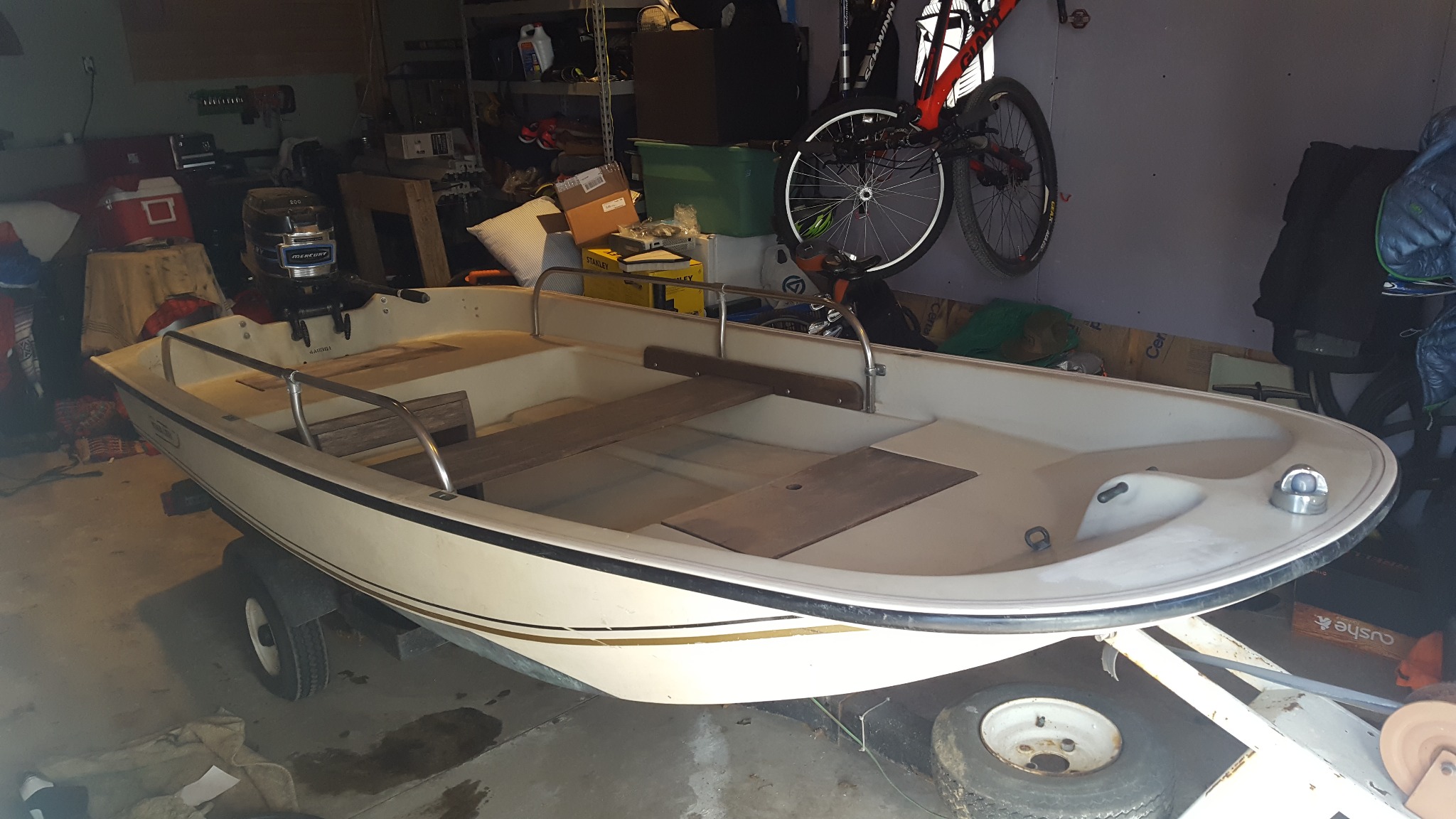

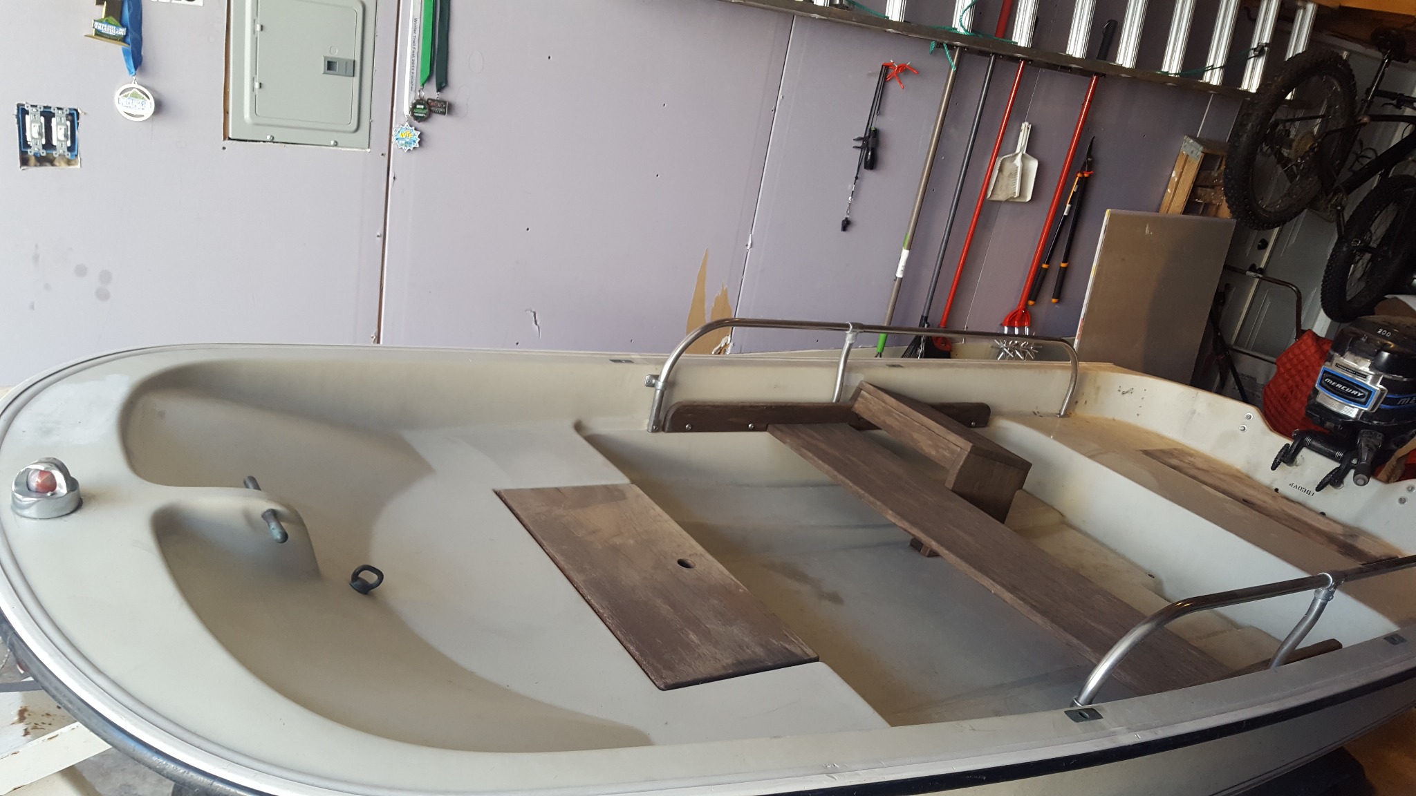

I picked up a 11'4 Whaler last weekend for what I thought was a good deal, but when I got it home and cleaned it I found a ton of spider-cracks. There are two that are pretty deep and the rest are just surface cracks.
My question is, being this is a foam filled hull, do I need to fix these immediately or can I run it for a year or two before I tear it down? The hull doesn't have any water in it and my fear is water will somehow make it to the foam and this 150 lb boat will be 1000 lbs.
My original plan was to redo the teak (replace or refinish) and call it good, just using it on some small lakes are Northern Michigan when camping.
Attached are some pictures.

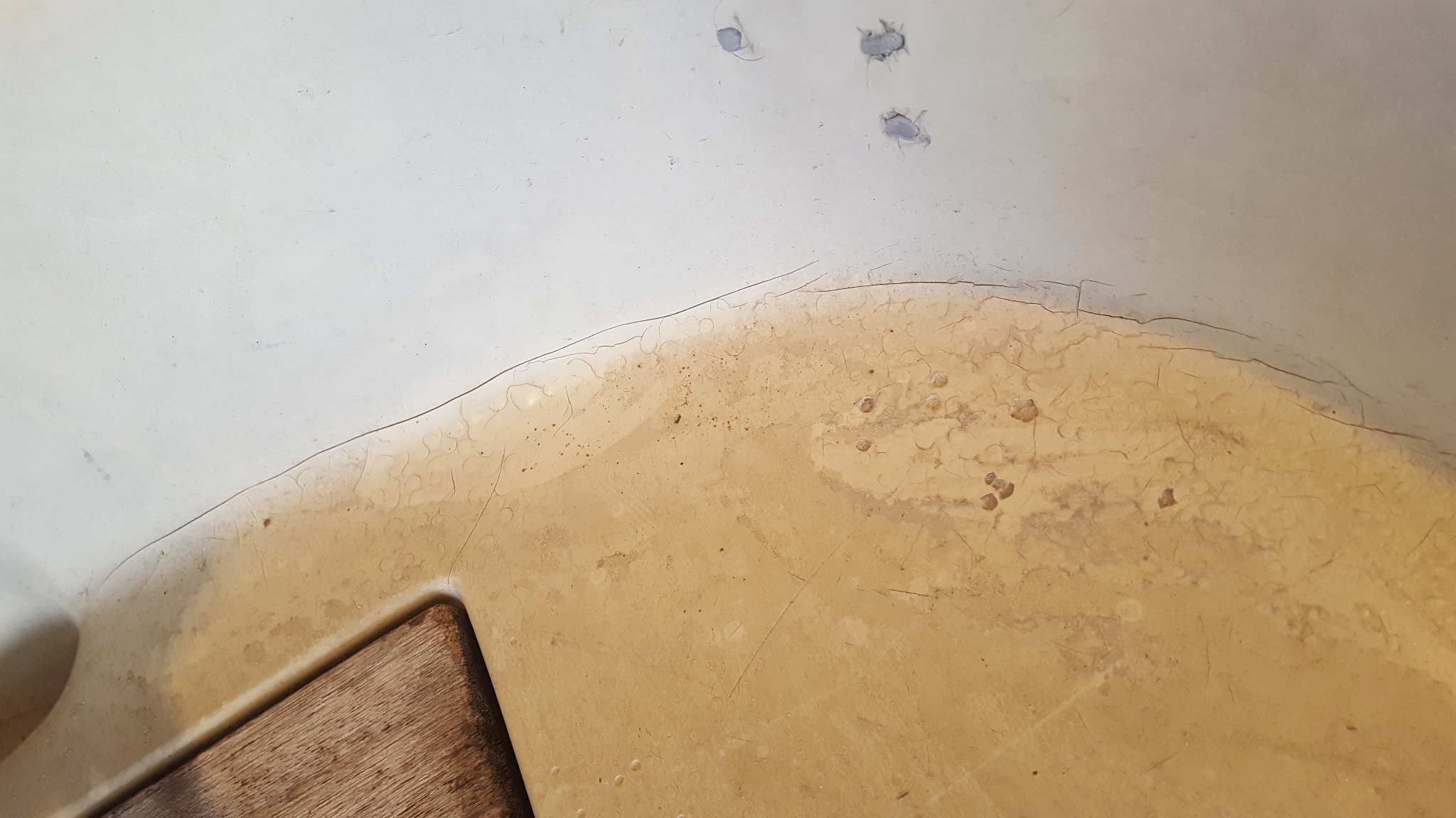

Thanks for the replies! I'm located near Grand Rapids, MI and the boat is stored in a garage when not in use so I won't have any issues with weather. I've attached another image showing some of the cracks.
Most of the cracks are on the floor and the creases around the floor. The transom is strong and there aren't any soft spots so I'm guessing it was just beat up a bit.
I think I'll patch the 2 or 3 largest cracks and save the rest for later, unless the picture gives you guys some hesitation.

The hole in what looks.appears to be the side wall is most likely a Scuffer Drain and if so don't plug that. As for the rest of the cracks...that is some serious Gel Coat Cracking and it looks deep enough to get into the Glass below and let water seep in. I am sure I have seen a roll on deck anti slip coating that seals the cracks as well as gives some grip to the feet.
Just not finding it right now.
This might be something that would work for you.
www.jamestowndistributors.com/userportal/show_product.do?pid=56089&familyName=KiwiGrip+Non-Skid+Deck+Coating#
Karsten

Thanks for the link. I agree, the more I look at the cracks the worse I feel about them. I may just have to start the resto this year, or sell it and try again with another boat, but with a lesson learned. Hmm..decisions decisions.
