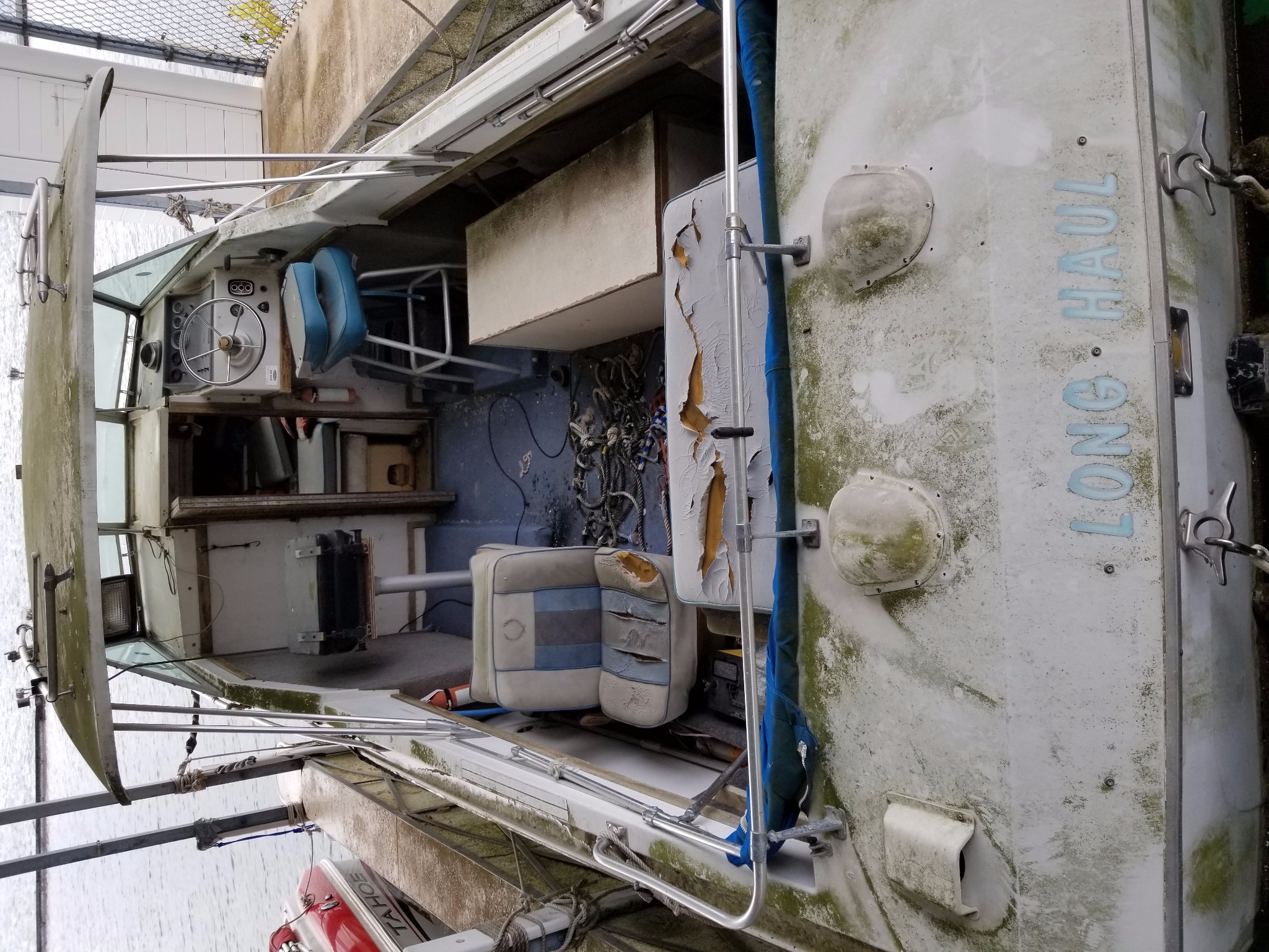

Ok I know this might stir up trouble but thought I'd post regardless. I have a 1975 Wellcraft Airslot 24. Not special, nor rare, just a really cool old boat that rides like a Cadillac. I am leaning toward modifying (updating) the electrical system, adding convenient goodies like electronic ignition, lights, modernize control panel, and basic upholstery upgrades. If I were rich I'd drop in a 5.0 Coyote just for grins. All that said, I can just as easy... maybe easier, restore back to original and sacrifice a bit of ease of operation. Right now she's rough and needs a make over. Thoughts?

Thanks, You and Sailor make good sense. I have "cleaned" the boat but still have a long way to go. I bypassed the fuel system and ran a line direct from the fuel can to the fuel pump. Engine fired right up and sounds awesome. I am taking the wiring in stages i.e. critical areas first like battery maintenance and bilge pumps. Then I will run my neg and pos mains to the terminal blocks and work out from there. The billows were replaced 4 years ago so hoping still good. The trailer needs attention so I have to address its issues before I can haul it out and give her a good servicing. But very encouraging so far! I will post pics as I wade through her.
