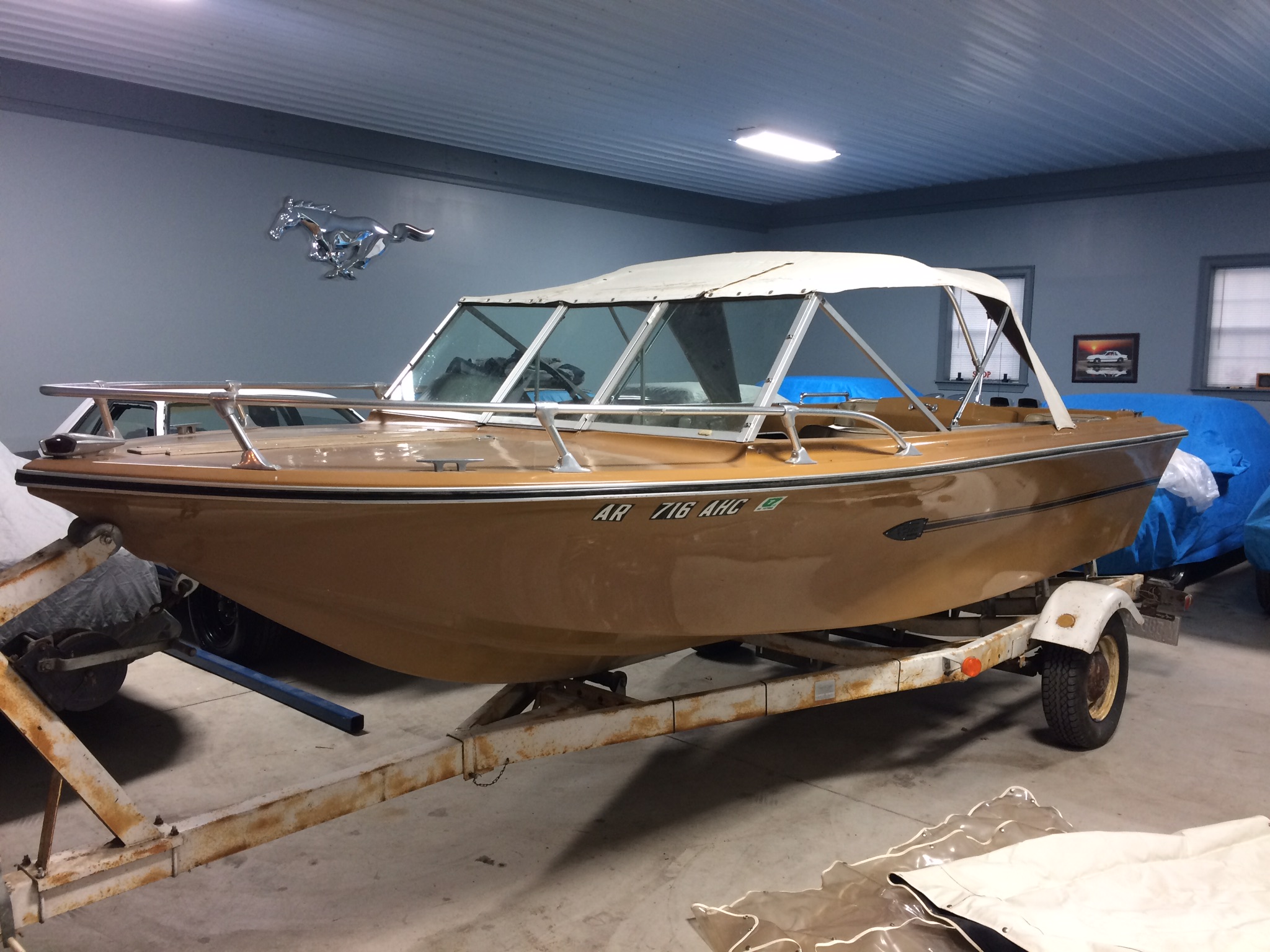

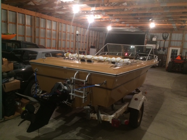

In 1971 my uncle called my dad on the phone and said come look at my new boat. 46 years later I went to northern Indiana and rescued the old girl from a slow death in an old farmers barn. She is in incredible condition considering she has not moved in the past 17 years.
1971 Arrowglass Javelin I/O merc 120 hp sitting on the original Dilly tilt trailer. My uncle and his family named her Old Mustard.

Welcome aboard. I think Old Mustard looks like a pretty nice rig! I am not the expert, but there are plenty on here if you have any specific questions. Great that you rescued the forgotten boat.

Nice looking boat, and it's fantastic that you saved her from deteriorating in a barn forgotten. It's great to have a boat or car that has family history, makes it all that much more special.

nice boat it deserves to be inside
Newbie with an old boat. 8 years 11 months ago #135055
Ditto Dr. Go. Nice shiny rig. I see in the background a nice mustang logo and some cars under wrap so I'm assuming you know more than an average person about motors. If that boat has been sitting so long than it would be prudent to go through that motor, seals, pumps etc. Shouldn't even turn it over without at least squirting oil in the cylinders, the lower drive probably has dried seals and water impeller also.

thanks for the nice comments guys. I have spent the last week or so doing some cosmetic things. I gave her a good bath inside and out and them buffed the boat with a good rubbing compound to remove oxidation. Then I buffed her with a finish polish and lastly put a good coat of wax on. She shines like a new penny now. I am waiting on my cousin to find the keys for the ignition switch. She says she has them "somewhere". I may end up having to swap out the ignition switch if she doesn't hurry up and find them. I took off all the railings, and other chrome accessories and will polish them ll before re installing them. My upholstery guy that works on my car interiors for me is also a great boat top guy so I have going to have him make me a new set of side curtains and put all new stainless snaps back on the boat in the original snap holes. I am going to install a couple of flush mount cup holders and a 12 volt receptacle for a phone charger as well. The interior seats and other vinyl trim is very nice and will not need recovered. The floor is a solid as it was when new and the floor covering is still in great condition as well. If all goes well I plan on building a teak swim platform to install across the back above the outdrive. I need to get the boat running and in the water to determine where the swim platform will go first though. I bought three new tires for the trailer and plan on sandblasting the old paint and rusty scale off, spraying the trailer with a good rust prohibiting product and then new paint. I actually found a set of like new, mint Dilly hub caps on eBay for 40.00 lol.
