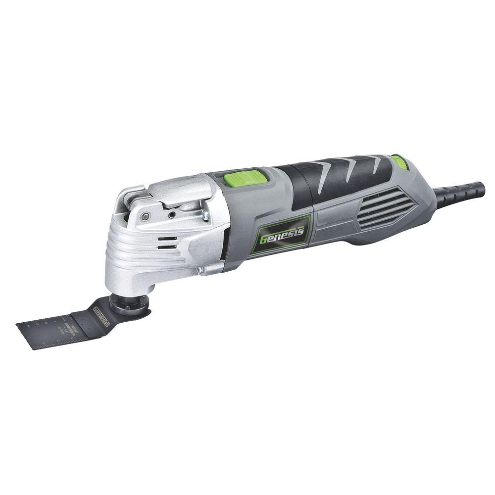

One of the tools I found almost indispensable when working on the old girls is a cheap Harbor Freight oscillating saw. You can cut right through the old resin and glass and wood and bolts etc. Go on line and get some of those % off coupons and you can probably pick one up for around $30.

That's the exact kind of tool that I've been using to cut the old glass from the transom, also started cutting the back half of the stringers with it. I've also been using it to cut the resin/epoxy (not sure which one it is) from around the pump intake.
