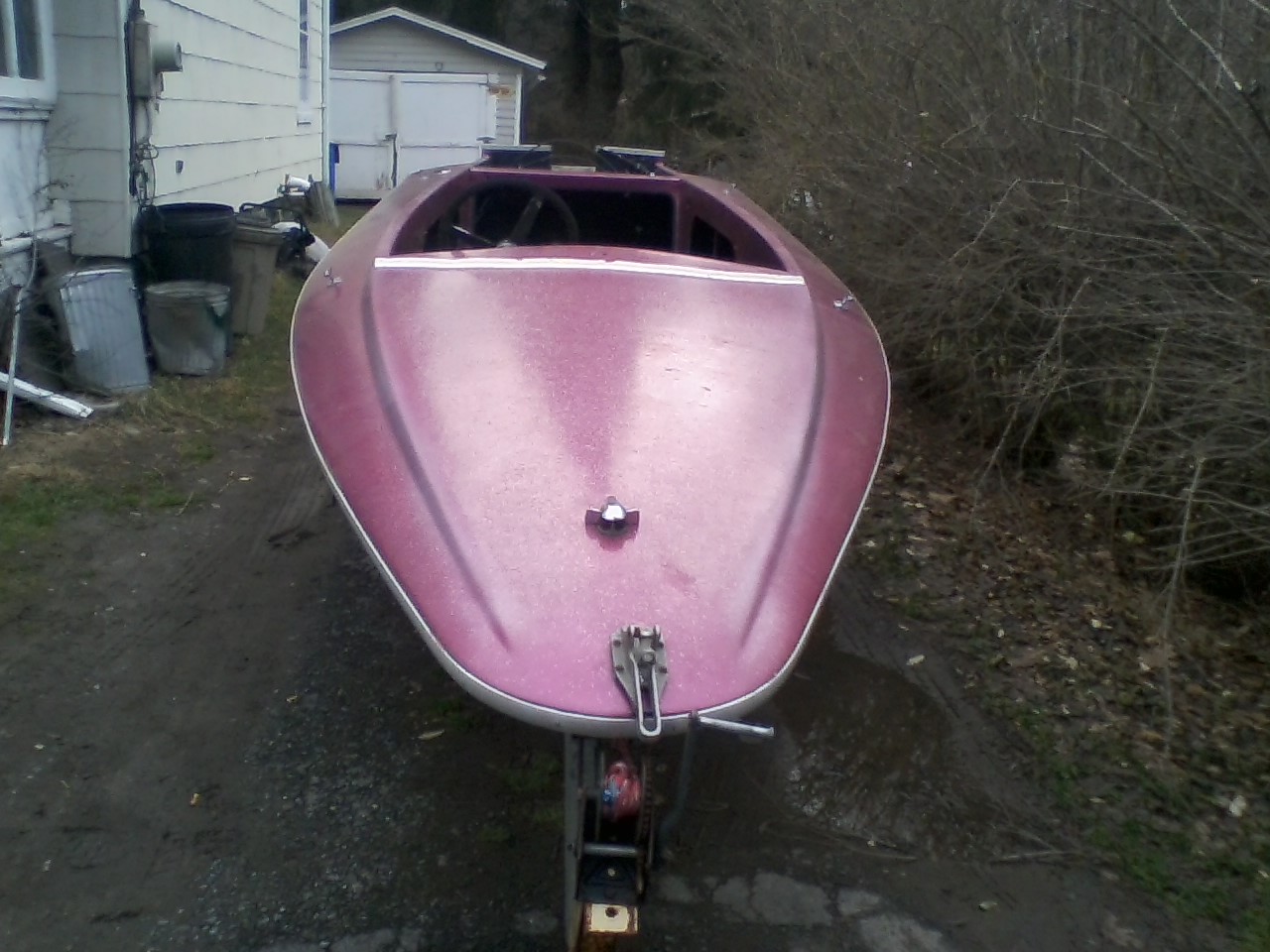

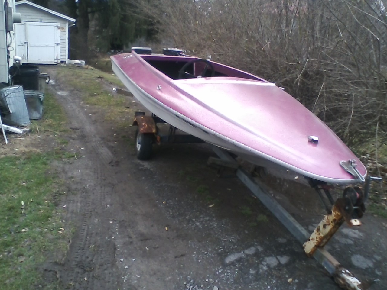

Paul. If you don't want it could you get it for me and keep it till I can drive the 650 or so miles to come get it?
I've been trying to figure out how the heck to get it but can't till I get my van out of storage.
You should get it, i'm going to start restoration of mine in the spring and we could help each other out! They are rare and it needs saved.
