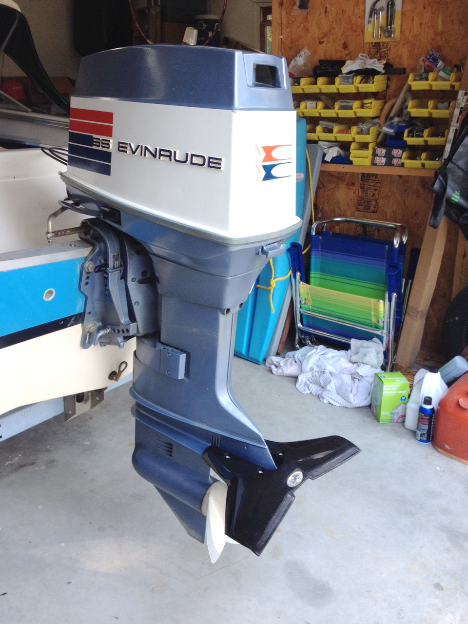

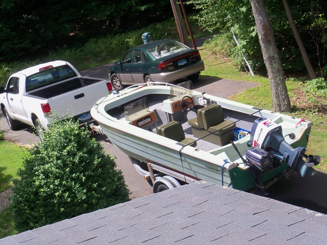

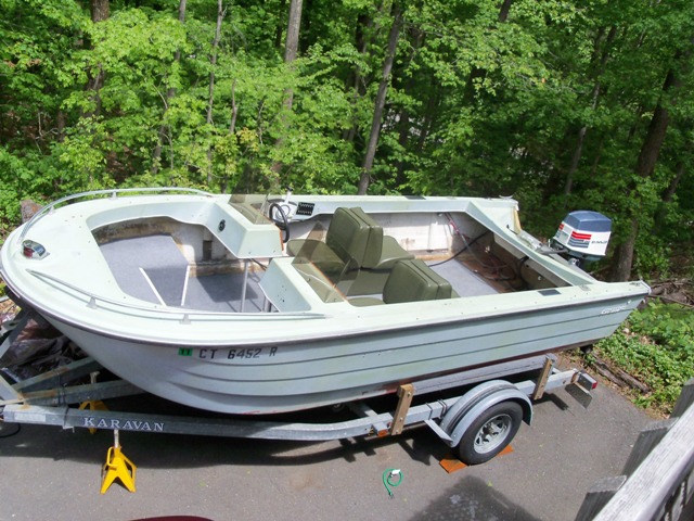

Hi All;
I took my 73 Crestliner out for the day on Saturday with the intent of testing RPMs at light load so I can choose the best new prop.
What happened is this:
First hour or two the max RPM at WOT was 4,800 at 25 or 26 MPH. This led me to think I need to go down from a 17 pitch prop to maybe a 15 pitch.
After changing to second tank, I looked down and noticed RPMs were up to 5,500 (and we were cruising at around 30 MPH.
Here is the info:
Engine is 1973 Evinrude 65HP Long Shaft with less than 80 hours on it from new (boat was used by my Uncle very little - lived most of its life in a dark dry garage). Until recently, the boat was last out of the garage before 1998 (last registration expiration).

If the second tank had the Seafoam in it, it may have cleaned out a bit of gunk in the system. Or, simply bad gas in the first tank. Continue the Seafoam anyway, never hurts.
