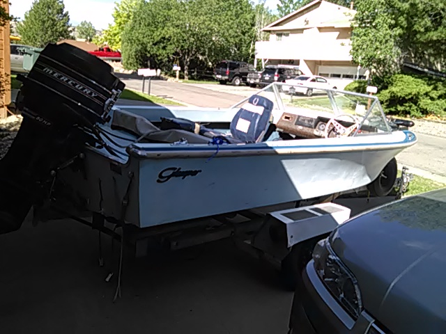

Hi all. I just bought my first boat. Its a 1971 Glasspar. Im not sure of the model because the post 69 glasspar info is scarce. Hoping you folks can help me to identify. Pics coming soon...
Itsa 1971 15 foot closed bow. Outboard, v hull, split wind screen. Fuel tank up front. Has plywood carpeted floor, and 4 seat post holes. regular driver and passenger seat post holes, plus a third center behind, and a fourth on the bow. Theres grip tape in stretegic locations around the top of the hull to get from front to back.

Despite its rough appearance, this boat is a real runner. The big merc is hard to start, but runs out well. Ive got trailer lights working, boat lights working, horn works, tachometer works most of the dash lights work.
18 gallon fuel cell is good, no leaks, but not plumbed in. Missing some metal details. Fish finder works! Just got that figured out last night before the mosquitoes came on bad.
Couple of jbweld repairs that dont leak, will get glassed and hopefully repainted (gel coated?) this winter.
Ive got questions regarding the plumbing of the fuel cell, and general diagnostics on the mercury 800. For now, heres picturs.

I was tearing into the interior trimm to replace the mercontrol box, and have discovered the identy of my boat. Its an avalon. Had to replace the mercury800 with an evinrude 75. It looks more appropriate actually.

Well, its definitely a glasspar avalon, but might not be a 71. Badges say glasspar, and some ink on the inside of the wood panels say avalon.
Last summer in some research, I think I also found the last year for this model was either 66, 67 or 68. That makes the speedy four even more appropriate.
Heres another angle though. When I removed the 1971 mercury 800, it became evident that this was the original motor. No signs of previous installations. No replacement transom. This boat was 100% original before I got hold of it. Side panel where the control box was mounted didnt have any extra holes, it was original.
The big merc looked out of place,, looked newer than the boat, even if they might be only 3 or 4 yrs apart. Im no expert on these things. The big merc looks more modern than 1971 in my opinion,, but yes, its for sure a 71 as confirmed by serial number.
So, left over 68 glasspar avalon, outfitted with a 1971 merc? Could be one of the last avalons ever.
