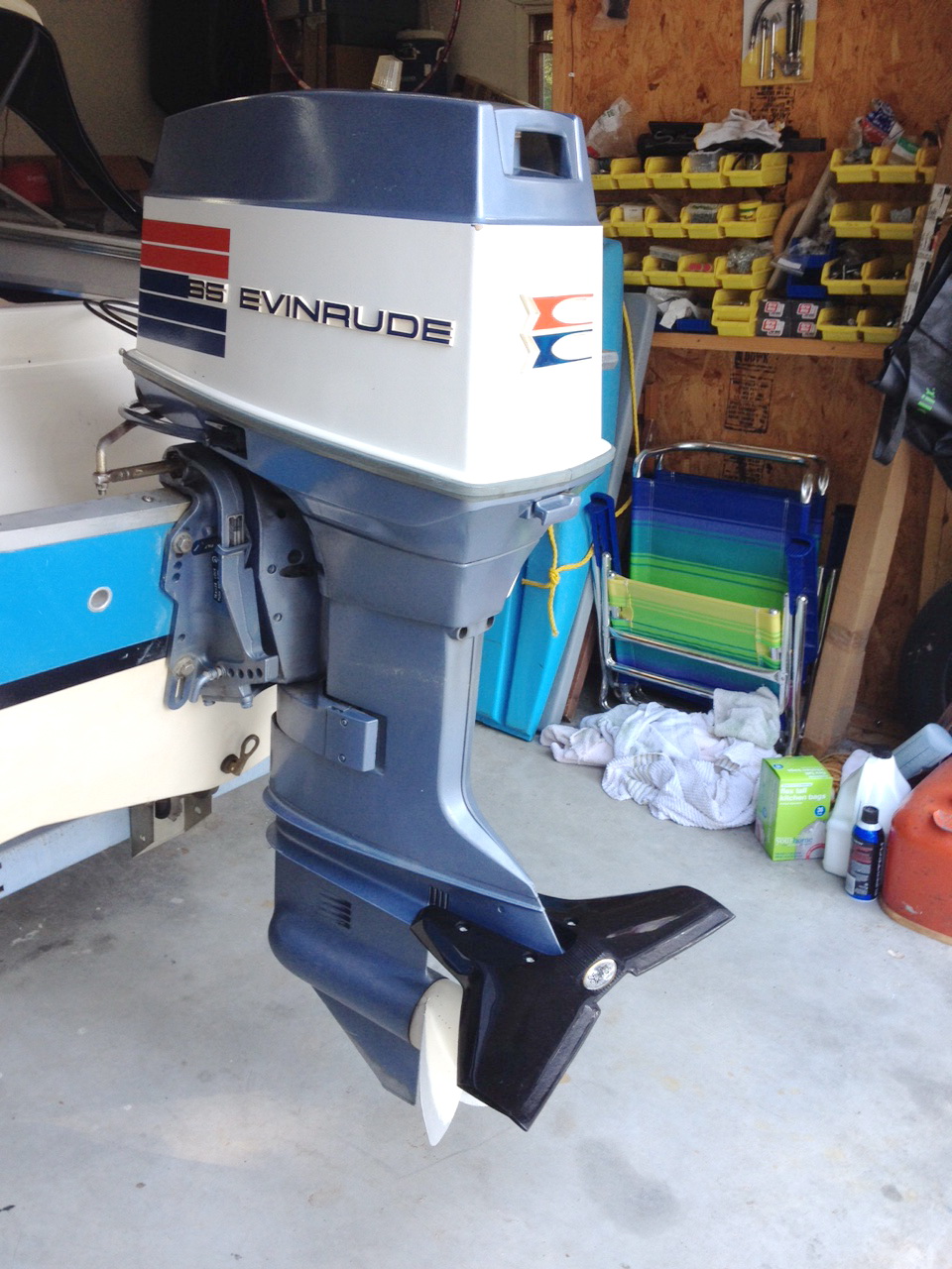

the motor looks like a full gear shift to me, there are two cables going to the motor. but I have been wrong before. it is a very nice boat, looks like new. frog
Re:40th bday gift to me: mint 73 Crestliner Muskie 17 11 years 3 months ago #111527
Good call Frog, the motor is a "Powershift II" , which is hydraulic assist on the shift mechanism - good unit IMHO! Looks like a great score Smalltownguy2, and welcome aboard. ;)

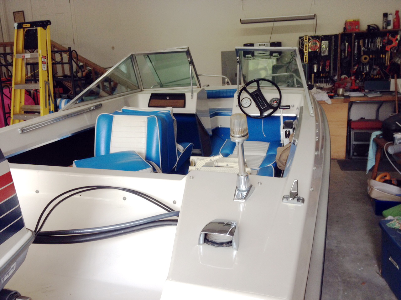

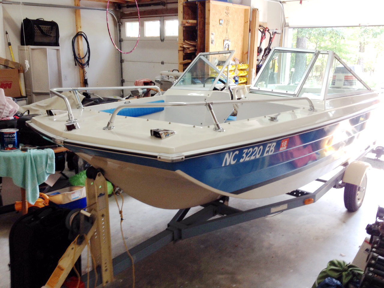

More pictures. I have it up on U-ship right now. I'm getting excited!

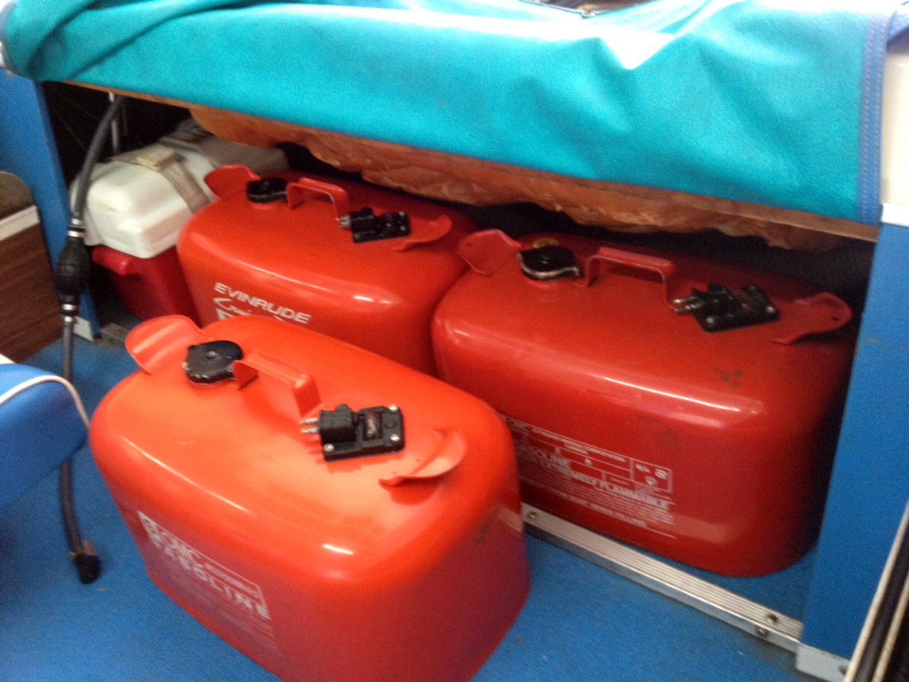

Stupid question here - do my metal 6 gallon tanks have a vent on them? I didn't look too closely, but is there a vent I should be opening to run my motor?

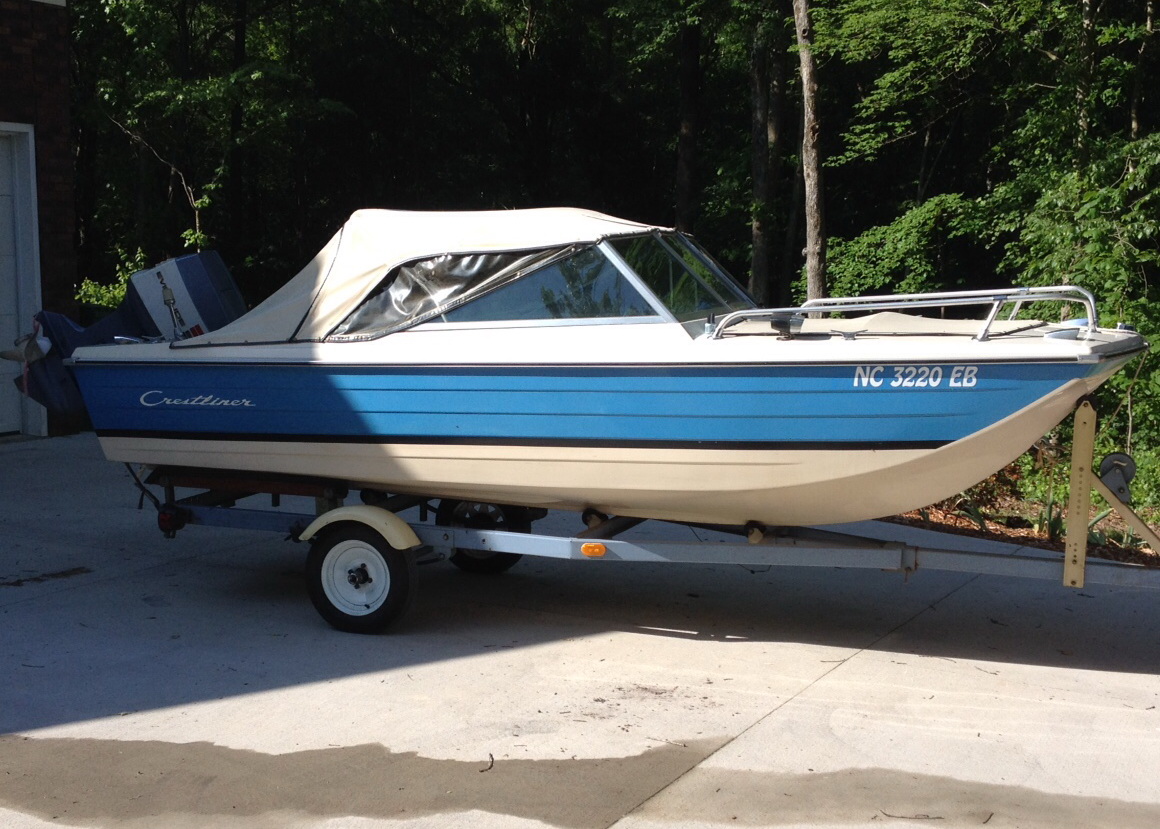

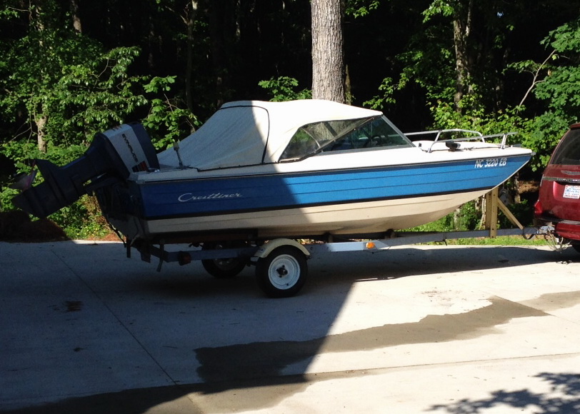

Here is a picture of my 73 Crestliner Muskie 15 :laugh:
Re:40th bday gift to me: mint 73 Crestliner Muskie 15 11 years 2 months ago #113344

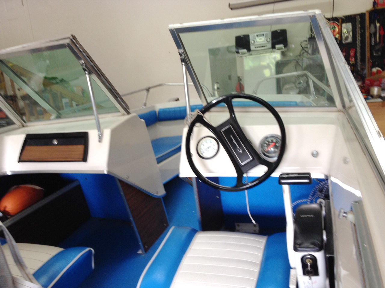

More pics of my Evinrude powered 73 Muskie 15. Our boats could be twins.... This also was a gigt to me (but I am 55 :(
My uncle decided he wanted to give it to me - I never would have expected it. I had not seen it since 1977, and had no idea what to expect. Lived its life in a dark garage - never left outside. Used verrrrry little - last time he had it out was 1998. I changed the impeller in the water pump and new plugs - ran like a top for 3 weekends, then died on the water. It turned out to be a the OMC Power Pack on the engine - cost me $100 for a new one and 1/2 hour to install it.
We are both very lucky guys - I feel a little guilty using it (don't want to get it dirty). I added the tack last week, so I could see the RPMs.
