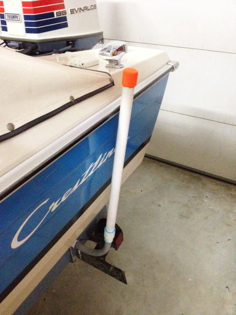

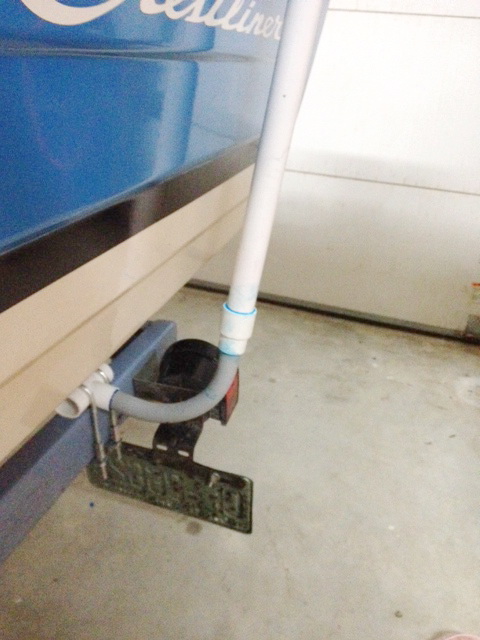

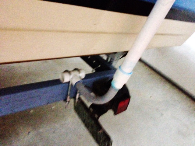

Hey Smalltownguy -
Here is what I put together for guide-ons on my trailer (The factory made ones are too expensive and look odd against the scale of a 15' boat.
Cost me less than $30.00 in parts.
PVC Tee Fitting (1x1x3/4 I think. (2)
Pre-formed PVC Conduit elbows (2)
adaptor to go from 3/4 to 1" (2)
1" PVC about 3' long (2)
1" pvc cap (2)
All glued together after the tee is attached to the trailer with 2 U-Bolts - see pic:
Re:40th bday gift to me: mint 73 Crestliner Muskie 15 10 years 8 months ago #116222
Also flexible enough to take the stresses of drift while loading, but firm enough that they don't vibrate or smack the rub-rail while trailering. I sprayed the caps orange to make really easy to see.
