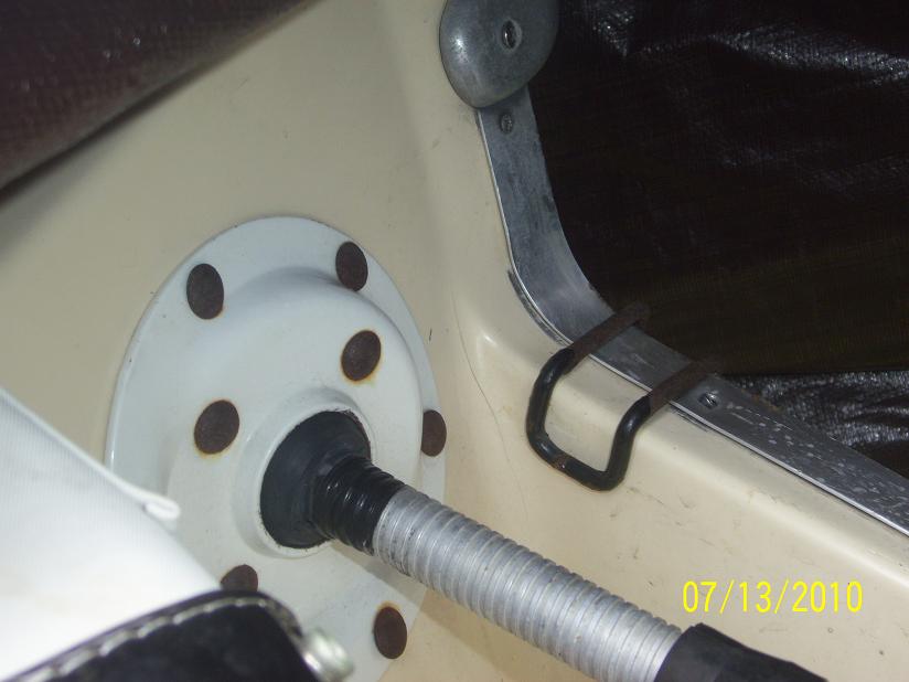

Hi, I own the 1977 MFG Gypsy that was pictured in the 1977 brochure. My Aunt worked for MFG and employees were given first option on buy the "picture/show" boats. This boat has been stored indoors all it's life. Recently I have noticed cracks in the transom, one at a screw onlong the top rail, a hairline crack on each side of the base where it attaches to the rest of the boat. Since my aunt has passed and MFG has closed I no longer have easily accessible supplies (she used to just bring us whatever we needed!)Since I know little about repairing a boat...any suggestions as to rebuild or replace the transome?? I love this boat as I was at the tender age of 13 allowed to name and care for her. Any help would be appreciated!!

Thanks for replying. I did take pictures, hopefully I can attach them.
Re:1977 MFG gypsy 16 years 3 months ago #11150
pictures

Apparently not quite savy enough to post pics...will try again
The transom actually is bowing out from the weight of the motor for so many years. It has a 90hp mercury on it
