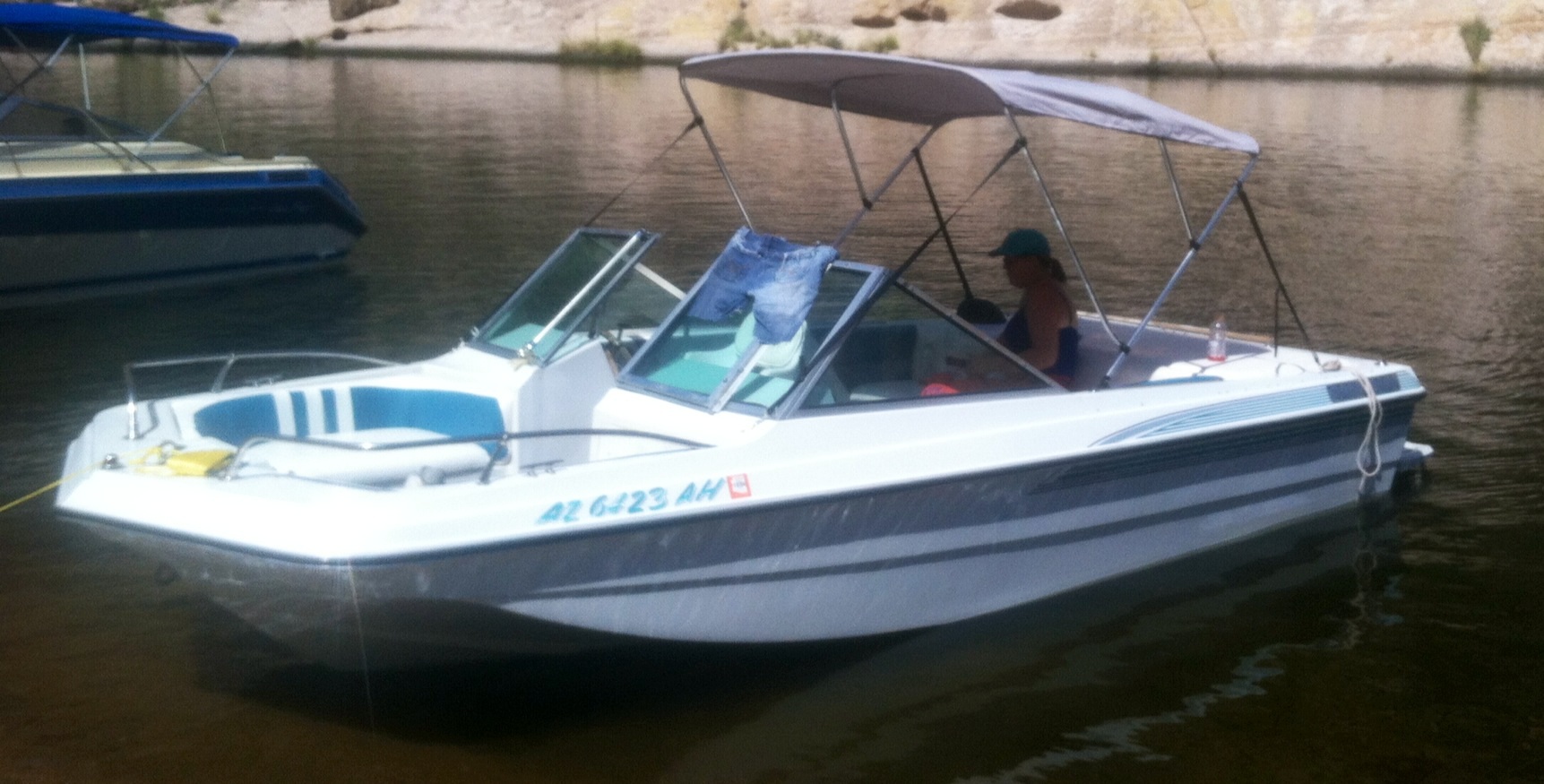

ive been slacking with the pics. i did put in more work and take another trip out to the lake yesterday.the boat still needs a name i suspect thats why its giving me so much trouble.
dual optima batteries,isolater switch. new ignition switch new wiring from dash to starter. added a relay to the starter circuit,upgraded to a later model volvo/penta gear reduction starter,easy swap well worth t for anyone with a ford v8 powered boat.
put the bilge plug in before putting the boat in the water think i will use that technique moving forward. ran great right up until the upper gear set failed. just when i think i have it about sorted something else breaks. its ok i kinda figured with a 38 year old $900 boat i would encounter some problems and so far i have been able to fix all of them without breaking the bank to bad.
still searching ebay for an upper. it had the wrong gear set in it anyhow
the manual suggests 1.50 is correct and i had 1.65 in it. it ran out well and got on plane quick with the 1.65 so im unsure what ratio to put in it.
on to the pics:
