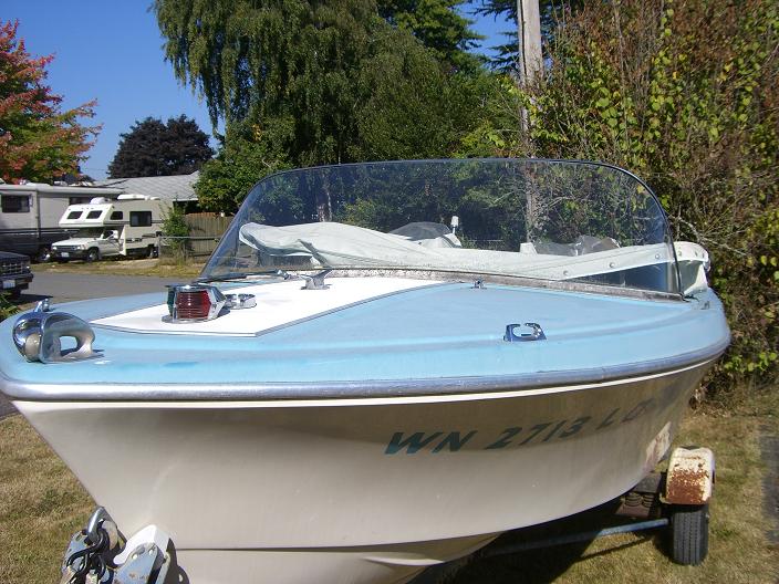

I recently picked up a 1962 Pacific Mariner boat with a small 4 cylinder motor. What sold me on the boat was the outdrive. It seems to be a vintage Mercruiser that has a crank that lowers the out
drive and locks in to place via what seems to be a pristine cable. Is this a rare find? The boat it self in my opinion is in darn near new shape. Can anyone tell me anything about this vessel? I plan to dust it off and use it. Its just way too cool. I think all I need are a pair of hanging dice on the mirror and I will be back in the 60s.

I made an error on the year of this awesome little gem. Its a 1966 Pacific Mariner Stiletto. It has a 60 hp Mercruiser motor and this freaky outdrive that lowers with a crank. The outdrive says Mercruiser. The motor just bolts right on to the outdrive and is suspended and has no motor mounts at all. I have never seen anything like this. To me it looks like she will run.I need to get a key made install a battery and keep my fingers crossed. Its a one owner boat, the owner passed away and it has been sitting for quite some time. By the looks of the oil,the spark plugs,and the pristine interior, this guy loved his boat.My big and probably the most expensive question I have, would be, should I decide to repower the boat with a new motor and and outdrive, what choices would I have? For now I am just assuming the motor is frozen and the outdrive is toast. I want to make this boat look like she did the day she was born. I think I will spare no expense to accomplish this.
Repowering is plan B.
