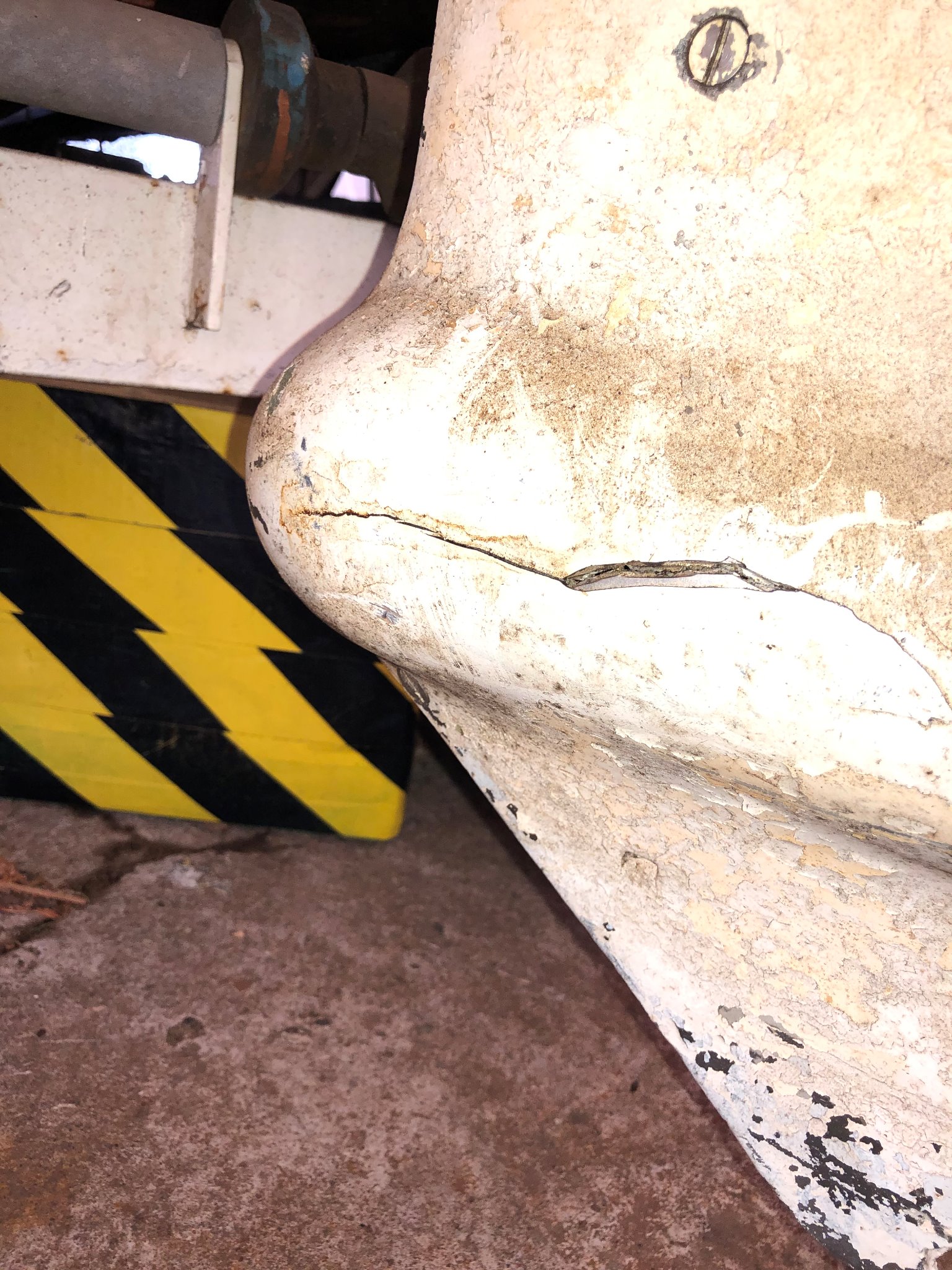

Hey, I am adopting a 22 ft wooden speed boat that has a Buick V-6 engine and OMC outdrive. I assume it is also from 1964. The bullet on the outdrive is cracked. I am considering abandoning the OMC outdrive and replace it with a newish MerCruiser. I have no clue what it takes to do this. I am just starting my research. Suggestions appreciated. This is not an immediate endeavor, I do not even have the rig yet, but I hope to look at it later in the summer of 2021.

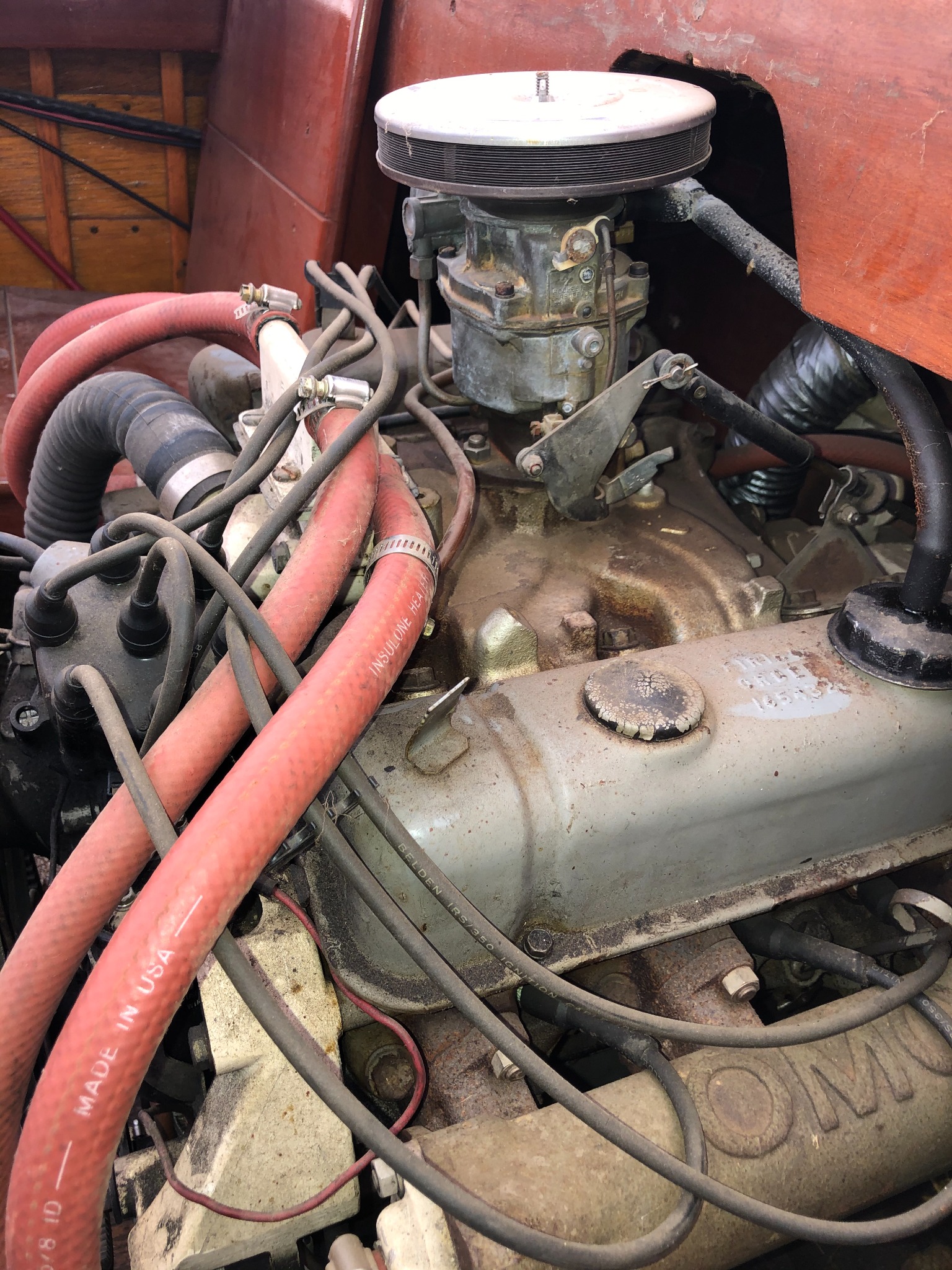

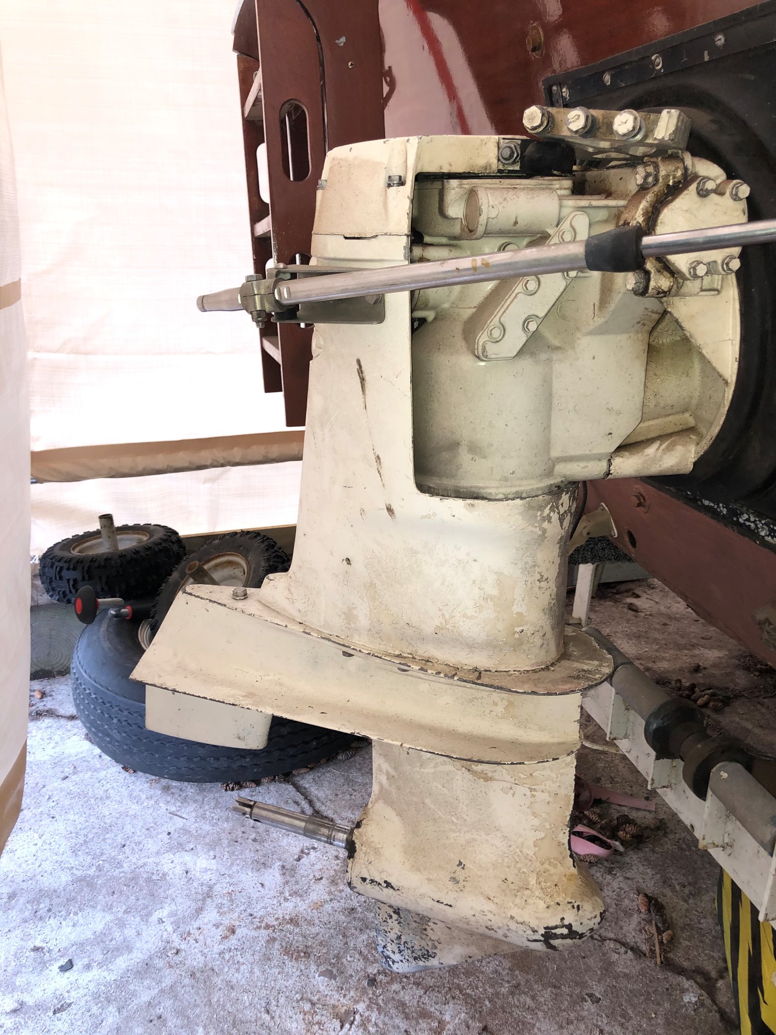

I have the beast at home now. On the engine there are markings "OMC" and 310911 and 310912. Apparently it's a 150 HP Buick V-6. The only markings on the outdrive are "OMC" and 379408.

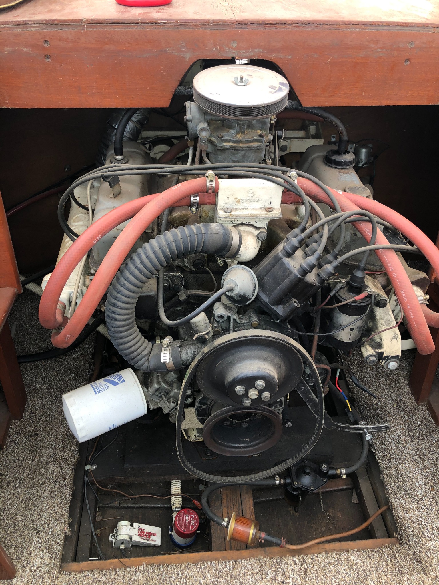

here are a few photos of the engine in the T & T boat
