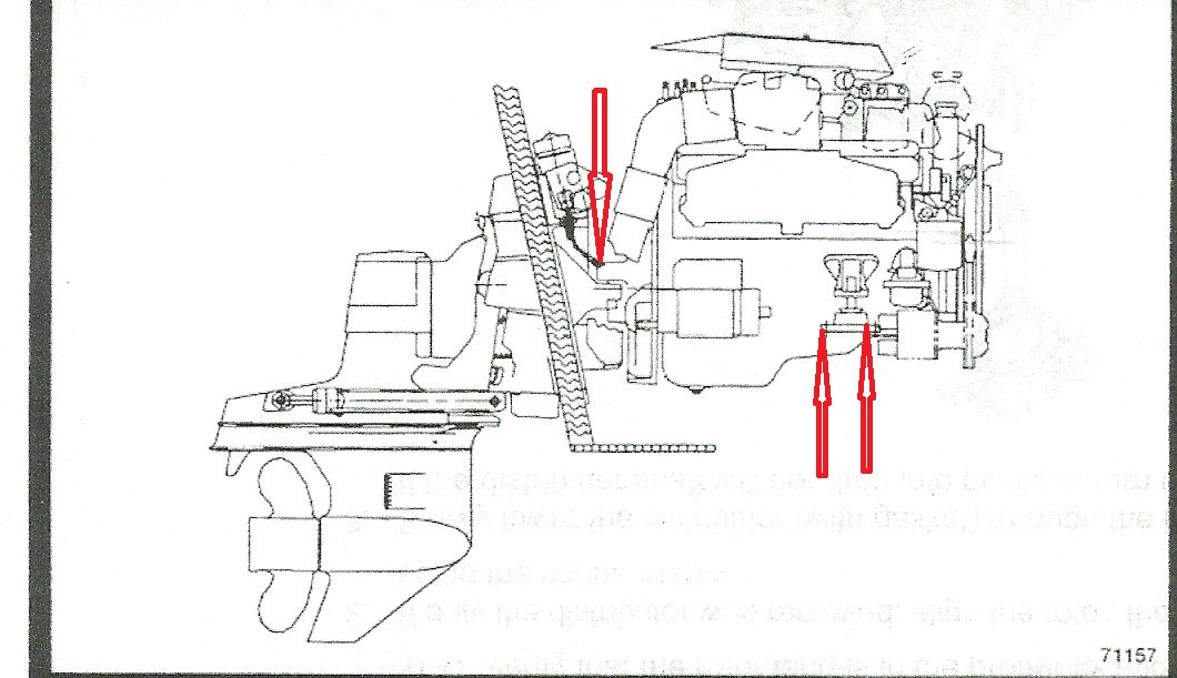

Hey guys Im at a stand still and need some help. I have 73 Bell Boy with a Ford 302 in it. Motor needs to come out for reworking. Everything is loose and ready to remove with exception of one of the rear motor mounts. Its locked up solid... tried 1/2 breaker bar with extension with no luck. Even tried snapping it off as suggested by a local boat shop. Nope, not happening! Guess i can try heat but it is tough to get to it? Any brillant ideas? Im afraid if I get after it with a cut off wheel I wont be able to lift the engine enough to clear the remaining stud. Any thoughts at all would be appreciated. Thanks in advance.

After reading your post, I'm not sure exactly what is locked-up...the bolts that hold the motor mounts in place on the stringers? The bolts that hold the motor mounts to the block? In any case, I would do whatever I had to do to remove the engine, with or without the motor mount, and then work on things when I had room. First, you need to get the bolts attention. For a seized bolt into the block, spray it with penetrating oil and then smack the hell out of it with a good hammer...several times. Now you have the bolts attention. Repeat the process if necessary every 10 minutes or so if need be. The bolt will surrender and you WILL win!...eventually.

Sorry for the poor description as to where the issue is. The rear arrow points to the problem child. Been soaking with PB spray for some time now. More than got the attention of the bolt @$#%&@#! Looking over the fine thread nut and bolt that I could get out, it looks like at one time It received a heavy dose of locktight? Also the nut is a steel nylock 3/4 inch nut. Was told that it was supposed to be a aluminum nut originally in anticipation of this issue? It was suggested to power through the nut and snap it... no way! Broke my favorate husky socket and twisted the head of the 18 inch x 1/2 inch drive breaker bar. 👎 Guessing the head of the nut with the heat is the next step? Unless someone has a better idea oh and thank you for the reply by the way... appreciated!

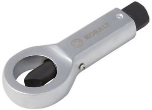

Not sure if you have the space to use one of these but a nut cracker can save you a lot of time and effort...and it's cheaper than psychoanalysis or a divorce.
For some reason, I can't post an eBay item address here. Very mysterious. Anyway, do a search for an Automotive Nut Cracker and you'll find it...$21.99.

Nuatilus, the nut cracker wouldn't work, the nut is captive in the mount (transom plate) so no wrench is required.
