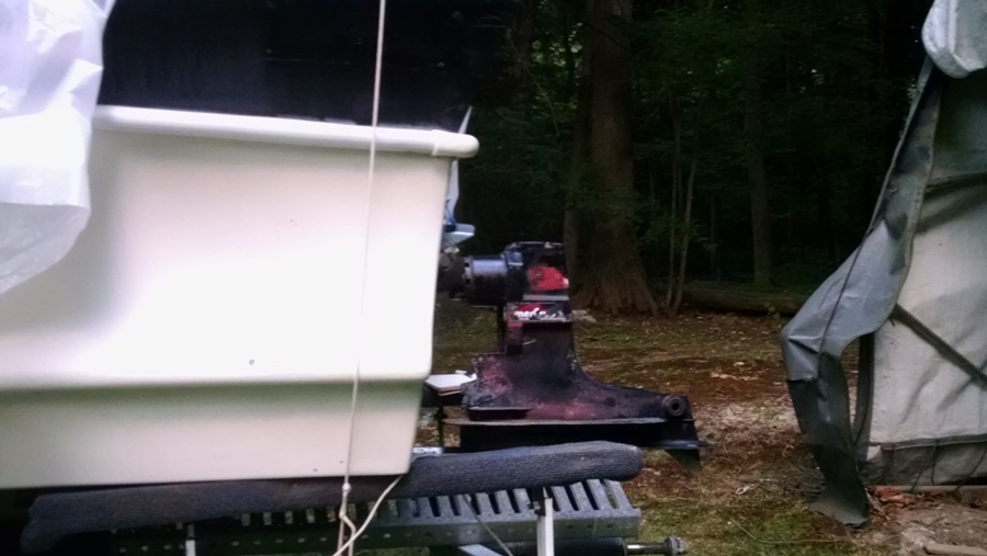

I have a complete Merc/ GM 292, 200hp engine, everything including 1/2 the stringers from the hull it was cut out of. Last week I came across a 87 Gen 1 Alfa 1 again including the transom it was cut from so all the parts are there everything but the steering cable trim pump and lines power steering pump and lines everything.
I have always been reluctant to use this engine mainly because of the orig drive really wasn't the greatest unit Merc ever put out and didn't last on the market anyway. So the Alfa 1 I got is really nice and doesn't appear to have been beat up or long hrs on it, nothing is rotten or frozen up/bellows/cables/anodes/swivel pins, everything is about perfect. I haven't been able to get to mating these up yet so I was wondering if anyone has done this and if I am going to have to have a different coupler or any other odd parts?
Also, anyone every heard of a split marine exhaust manifold for one of these? Old cars guys know the sound of a split 6 and it is great and what I have planned for this it might be a must.
A little peak at the plan, sorta.
