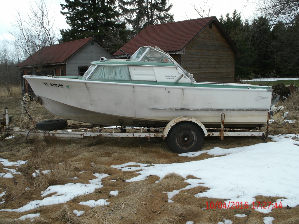

I recently picked up a Glasspar Seafair Sedan. It has a Volvo 4cyl. but the motor dog house has been cut out on the carb side to make room for dual carbs.
Is this rare? Was it a option? Or maybe a Hot Rod engine?
If it ever quits snowing I'll try to get some pics up.
Thanks, Gene

Hope to get over there today to look it over better. I did not get any paper work with the boat so I don't even know the year. The cut out engine cover tells me it was modified for 2 carbs or as Kerry says an engine transplant.
Thanks, Gene

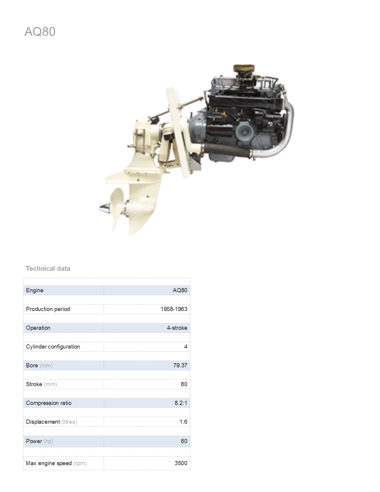

The 80 had a single carb and 110/200 had dual carbs.
See:
www.volvopenta.com/VOLVOPENTA/GLOBAL/EN-GB/MARINE_LEISURE_ENGINES/AQUAMATIC/Pages/TheAquamaticstory.aspx
All good information although you can’t believe everything you read on the interweb. The story there claims that Jim Wynn invented the I/O but it was actually Charlie Strang who worked at Mercury.
Once you get some numbers you can download the manuals at that site.

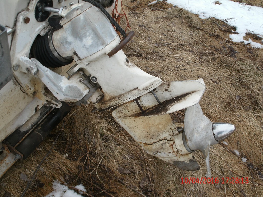

Looks like the outdrive data plate is gone but there should be a plate riveted on the block.
