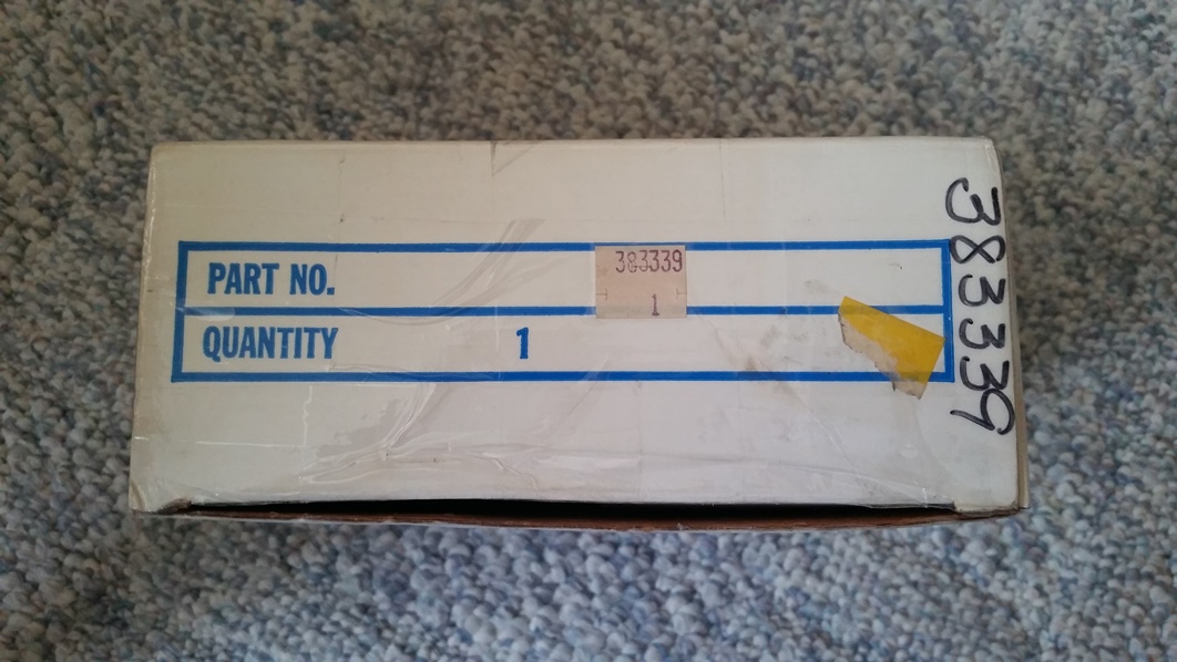

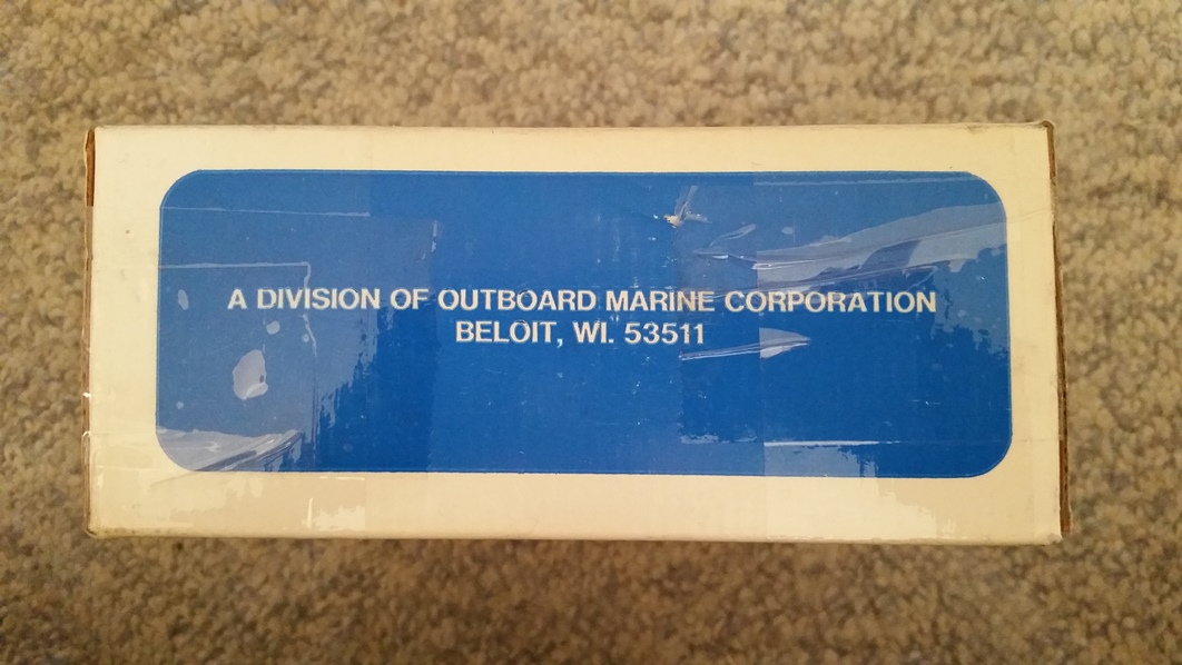

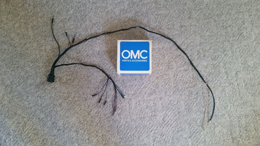

Boy did I get lucky and find the needle in the haystack! I have been searching for OMC part#0383339, the main engine wiring harness for the entire time I've owned the boat. Today I received an email from Mayday Marine Services stating that they had ONE harness in stock.
The last NOS 0383339 harness, that I know of, is now on its way to Idaho.

Re:OMC Engine Harness 11 years 5 months ago #111154
Mayday Marine Service is one outstanding company. I received my main engine wiring harness today.
Between the new harnesses...I bought a NOS tilt harness many months ago...and the NOS transom boot, we're going to have a boat that will last us for many years.
