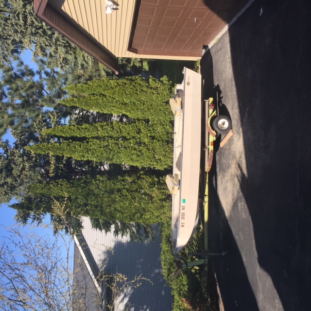

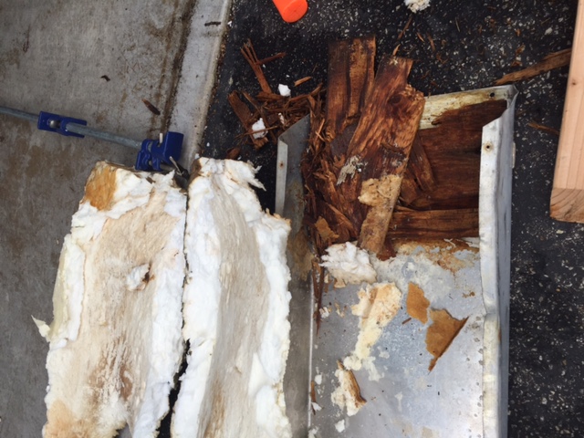

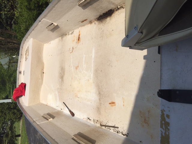

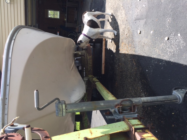

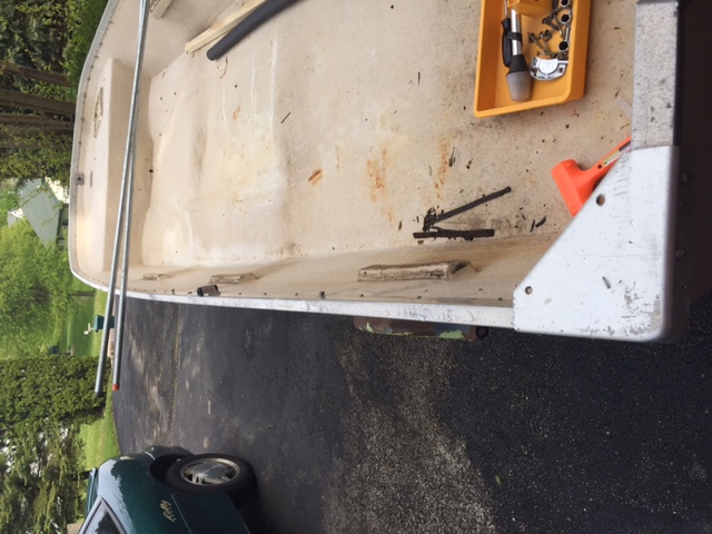

I just bought this one and hope to have it in the water in a few weeks. Replacing all the rotten wood used to locate seats. Have the trailer all scrapped and repainted rattle can Rustoleum Hammer white, new springs, bearings, machined rings to slip over 1.200" seal surface so now I can use the common 1.375" and correct parts for Bearing Buddies. It came with 13" 4 lug tires and rims. I have a question about trailer height it seems to me to sit too high with the axle under the springs. I might relocate to axle above springs. Have take the locating pins out of the two leaf springs and reverse them. Big C-clamps will keep the springs in one piece while I swap out the pins. Having fun now!!!!!!
